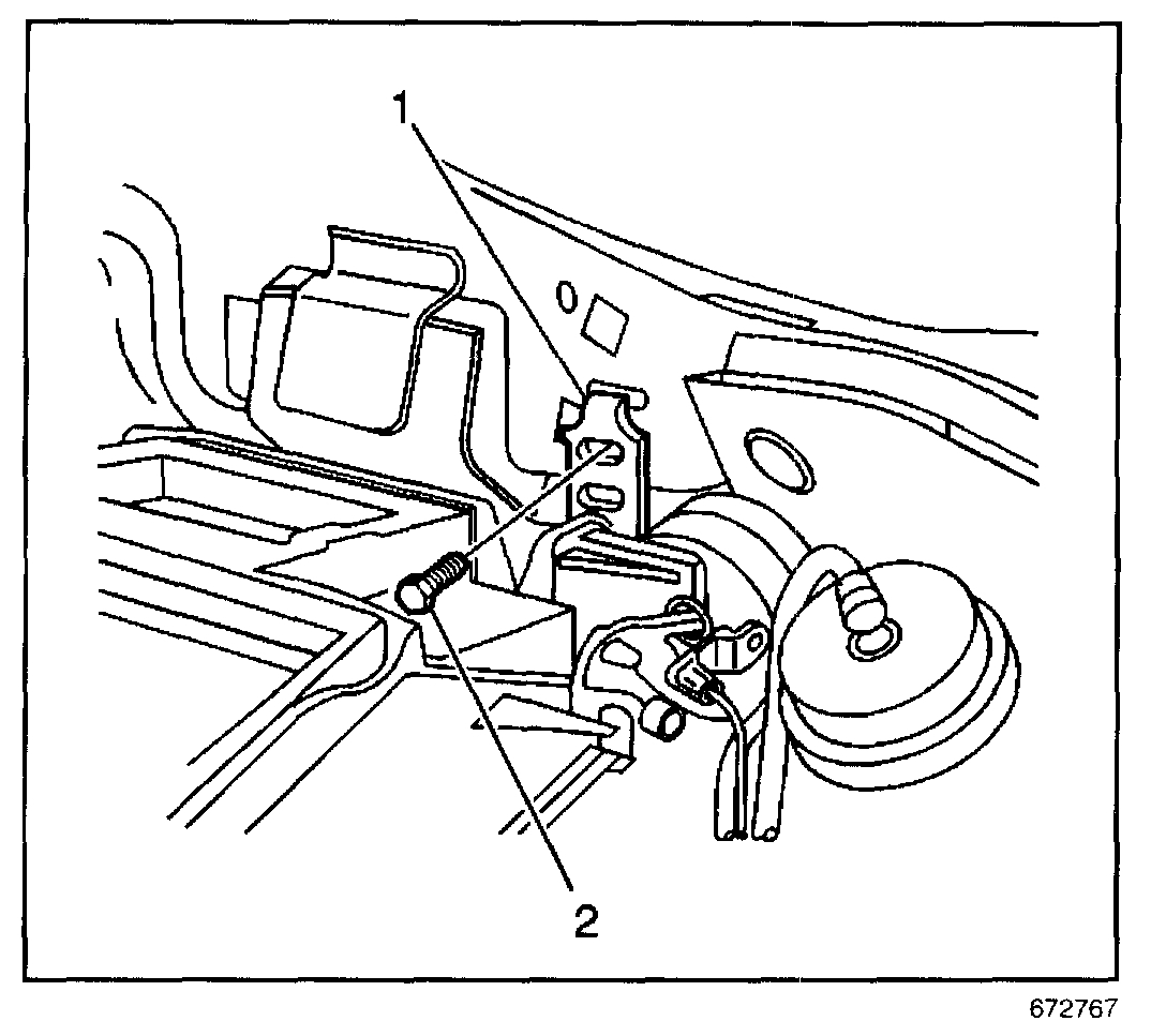

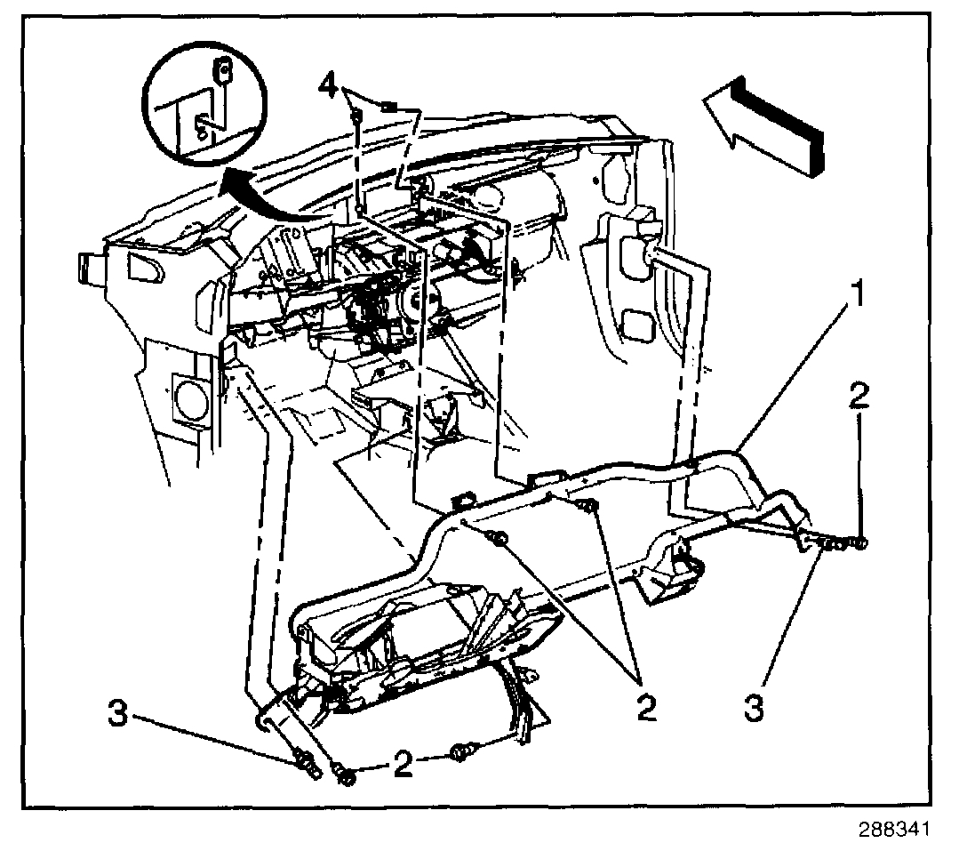

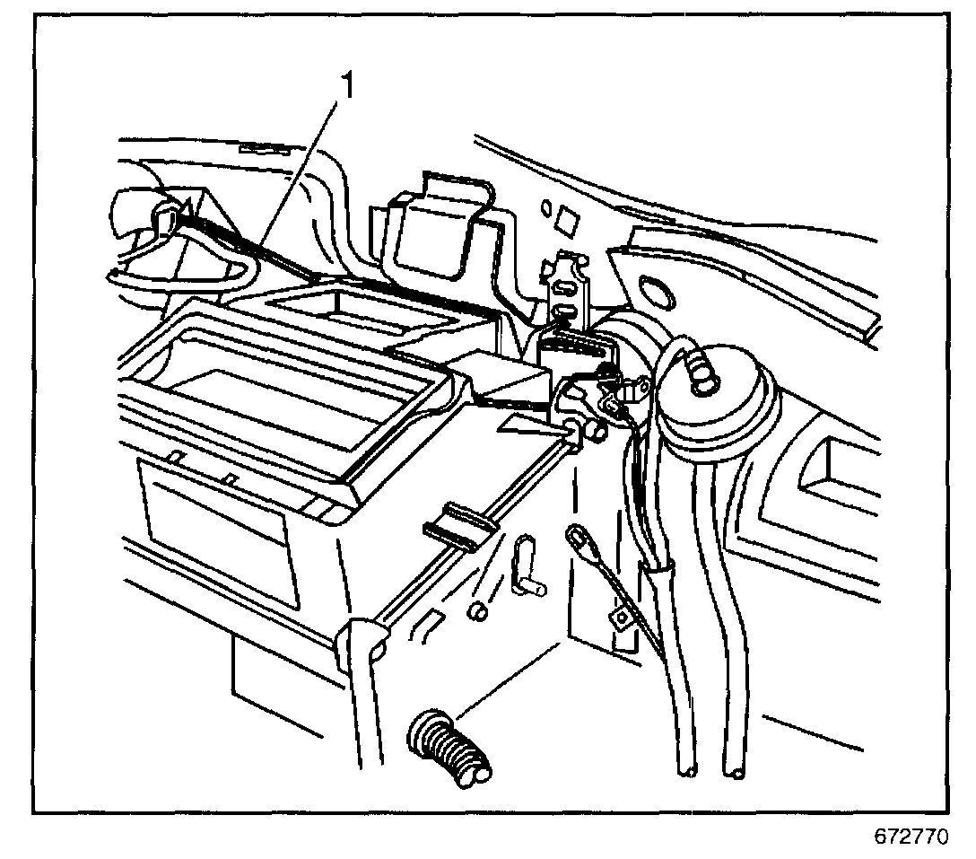

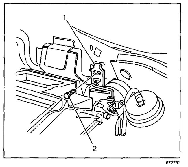

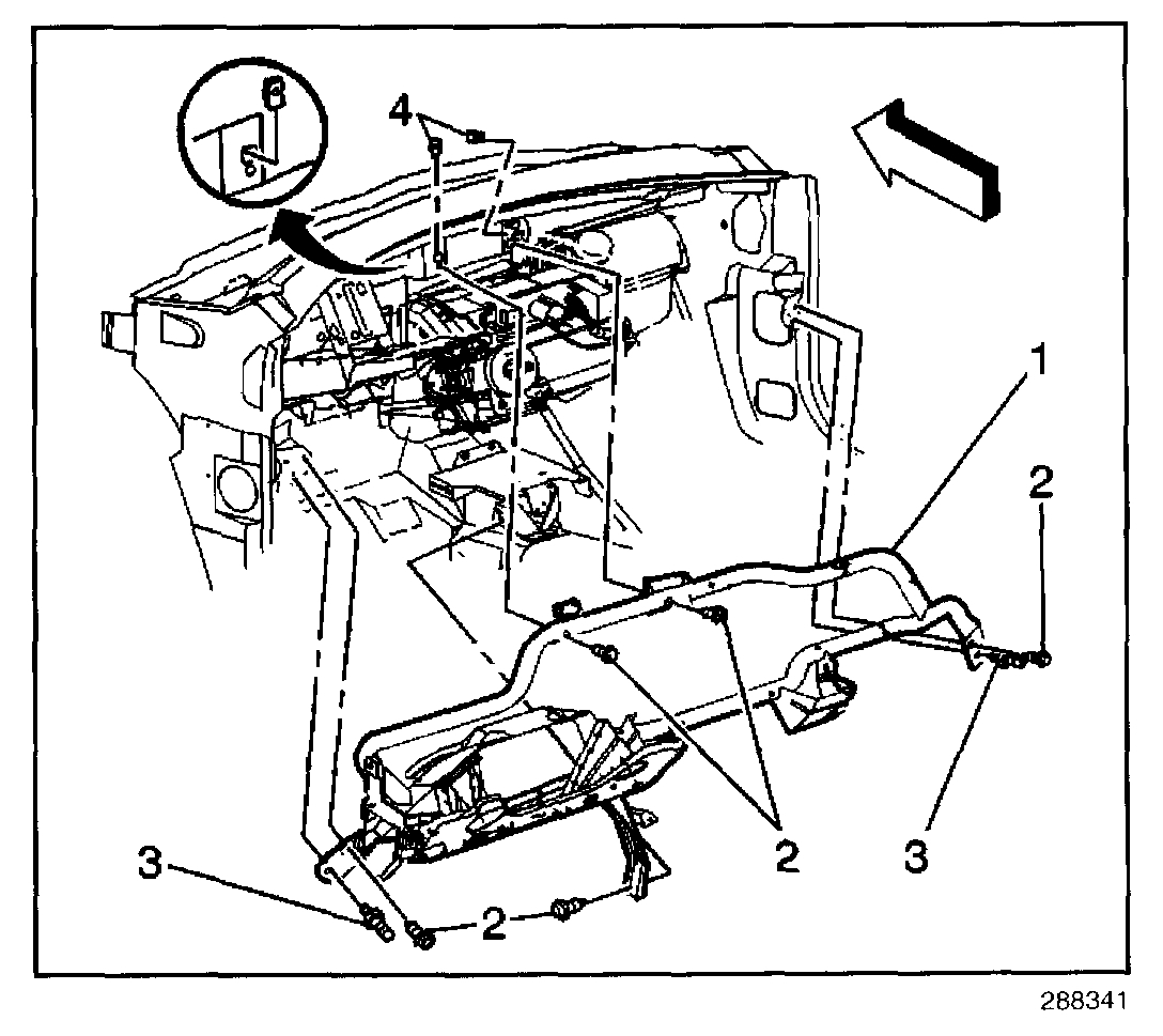

Have you replaced a Cavalier/Sunfire/Grand am? heater core before? Having trouble getting the heater core cover back on the bottom of the HVAC box
Feb 25, 2021 at 2:56 AM
  • 110,244 POSTS
Take a look through these directions. They are for the housing on HVAC module assembly. The attached pics correlate with the directions.

9. Remove the IP carrier.
pic 1
10. Disconnect the wiring harness from the cross vehicle beam (1).
11. Remove the attaching bolts from the right and left side of the HVAC module.
12. Remove the bolts (2) from the cross vehicle beam.
IMPORTANT: Place the steering column in the straight tilt position using the tilt lever.
13. Remove the cross vehicle beam (1) from the front of the vehicle.

17. Remove the HVAC module attaching bolts near the heater hoses and the A/C evaporator lines.
Remove the HVAC module assembly screw (2) from the mounting bracket (1).
pic 3
18. Disconnect the gray source vacuum line (1).
IMPORTANT: Do NOT tilt the HVAC module assembly, or coolant may leak out.
19. Remove the module from the vehicle.

pic 4
1. Install the HVAC module assembly. Align the mounting bracket (1) to the hole. Install the screw (2) to the mounting bracket.
Tighten
Tighten the bolt to 2 N.m (18 lb in).

pic 6
7. Install the cross vehicle beam (1) to the front of the dash.
NOTE: Refer to Fastener Notice in Service Precautions.
8. Install the bolts (2) and the studs (3) to the cross vehicle beam (1).
Tighten
Tighten the bolts and the studs to 10 N.m (89 lb in).
