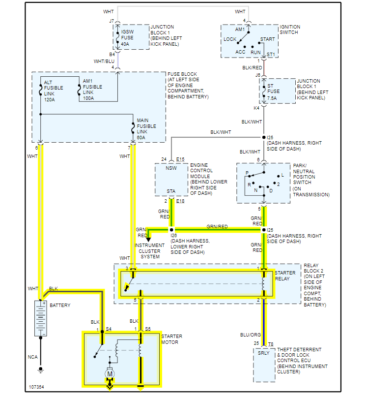

Most of the time I turn the key, I get the click sound, with no crank
149,000 MILES • 3.0L • 6 CYL • 2WD • AUTOMATIC
NORTHBOUND408
Sometimes I will get a partial crank, and for it to start it'll crank slowly, just enough to start. Then it drives fine once started. I replaced the starter relay with one from Lexus, and had my battery and alternator tested from AutoZone, they said they were both good. Thanks for the input.

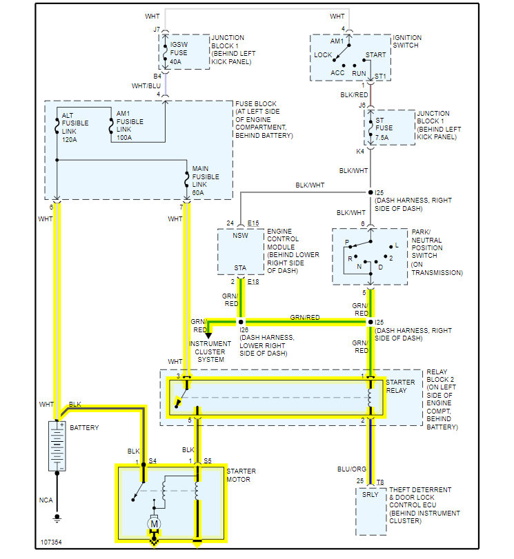

Good morning,

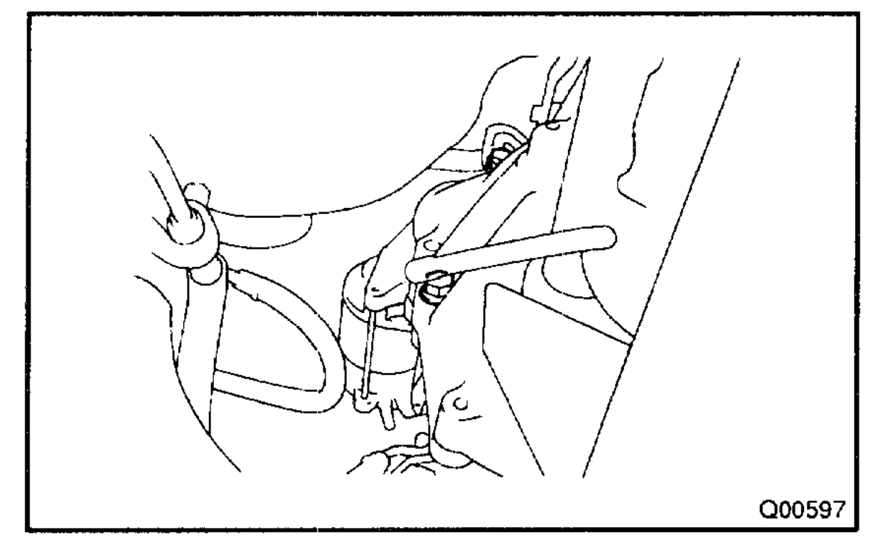

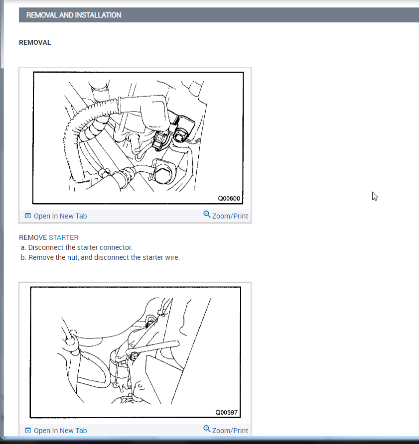

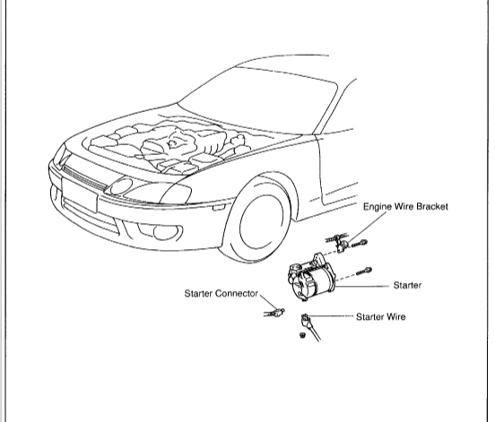

I attached the wiring diagram for you of the starter motor. I also attached the procedure for removing the starter as well.
Make sure you test all the fuses in the diagram as well.

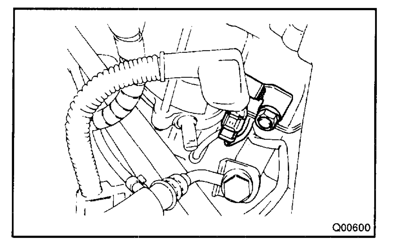

REMOVAL
REMOVE STARTER
a. Disconnect the starter connector.
b. Remove the nut, and disconnect the starter wire.
c. Remove the 2 bolts and starter.
Torque: 37 Nm (380 kg.cm, 27 ft.lb)
