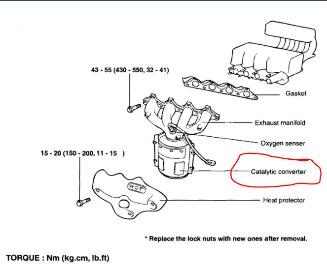

how many cataylic converters does my car have?

Your car has 1 catalytic converter. It is mounted directly to the exhaust manifold.They are quite pricey. I've attached a picture below of its location on your vehicle and circled in red.Hope this helps and thanks for using 2CarPros.
