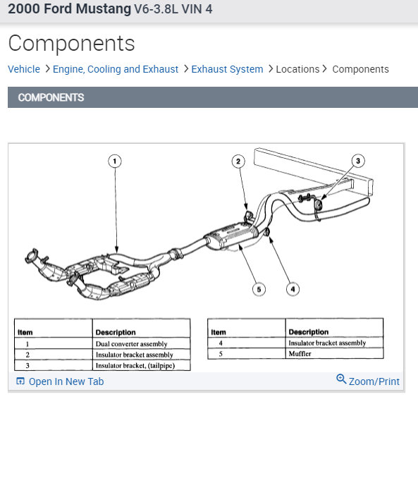

when I bought this car the old exhaust system was falling apart. One day it decided to fall on me and took everything down with it including all four stock catalytic converters. They were all clogged from the hard drop and from being drug on the road until I could find a spot to pull over. Fast forward to now, I currently have aftermarket headers, a catless H pipe on there with a Borla catback exhaust (so it has a GT exhaust conversion). I purchased two high flow catalytic converters to be put on so it will be street legal because in Missouri it currently is not. When I brought it up to the exhaust shop I wanted to do my install, he told me I needed the pre-cats as well for it to be legal. I personally thought you only need the two main catalytic converters for it to be legal but this guy told me otherwise. So I am not sure what to do because I am not sure if this is true because I have not been able to find anything about the amount of catalytic converters you need for it to be legal in Missouri (I could only find that clogged catalytic converters can be placed with OEM ones of high flow ones), nor can I find pre-cats anywhere. Could someone please help me?

If the car came with four catalytic converters two pre-catalytic converters and two main catalytic converters, that is what it will need to pass smog. If it is a car made for forty eight states other then California and met New York's Federal emissions. When your changing the exhaust around you have to be mindful if it will meet the emissions standards for smog.

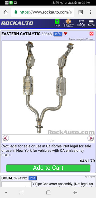

I have a 5 percent discount code for rock auto if you decide to order from rock auto.I have bought tons of parts from rock auto for years.I have bought the eastern cats from them as well they fit great.

TAYLOR ANN THORNTON
So are the “eastern cats” the precats or does that mean the entire exhaust. Again I have the gt exhaust conversion on mine so I need to be mindful that they fit the exhaust. Plus I do not need the whole set. Just the precats.

SATURNTECH9
  • 30,869 POSTS
It is all four catalytic converters and the pipe that is the only way I see it coming. You can check with the dealer but one catalytic converter from them is going to be as much or more then all four of them together I sent you.

Since your Mustang had four converters from the factory, it will need to have four to be able to pass smog properly.
