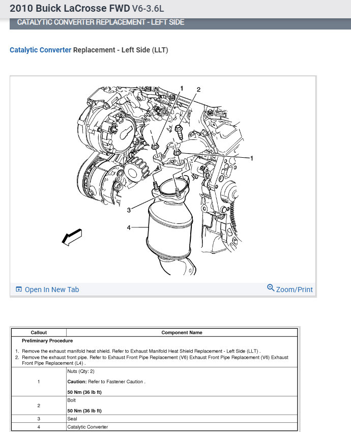

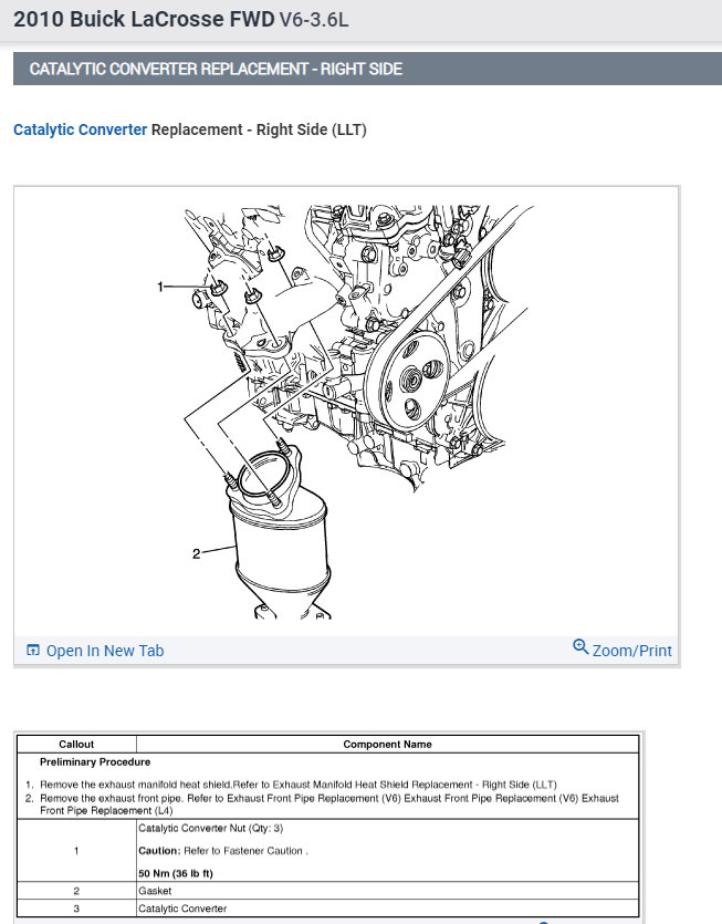

Does the second catalytic converter usually mess up after replacing the port one catalytic converter and if so, usually how long after replacing the first one?
