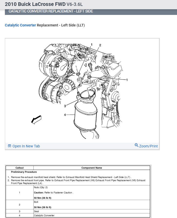

I want to know how many catalytic converters are on the car.
Jun 10, 2022 at 12:50 AM
SQM
  • 6,383 POSTS

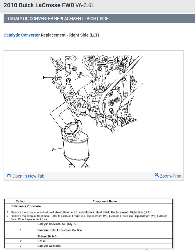

This Buick should have two catalytic converters. One of each exhaust manifold.
https://www.2carpros.com/articles/catalytic-converter-replacement
I have attached diagrams below for your reference.
Let me know of any questions.

So, could you tell me why car auto part stores are saying it's three. Two in the front and one in the back.
Jun 10, 2022 at 3:36 AM
SQM
  • 6,383 POSTS
There is a secondary catalytic component that is part of the center exhaust pipe. Most issues happen with the two primary units.
