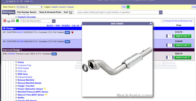

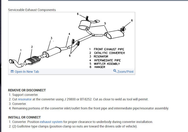

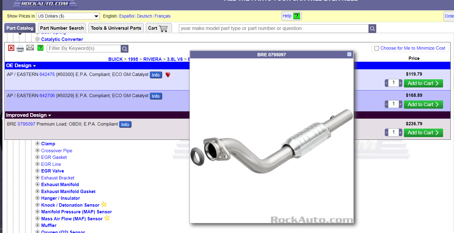

How many catalytic converters does this car have?
1995 BUICK RIVIERA
150,000 MILES
TRACYLYNNMATTHEWS
Some of these sites are talking like all catalytic converters only have one. my mercury sable had three.
Aug 23, 2021 at 7:59 AM
Good morning,
There is only one for your car. Other cars have several but yours only has one.
I posted a picture below for you. I also attached the procedure for you for the repair.
https://www.2carpros.com/articles/catalytic-converter-replacement
