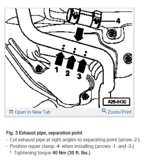

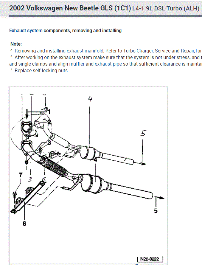

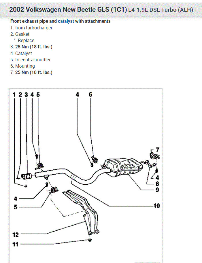

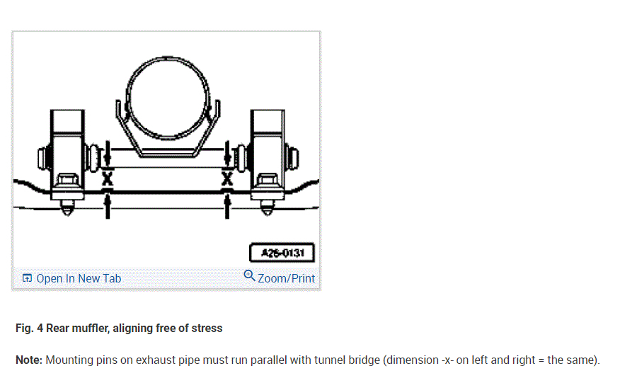

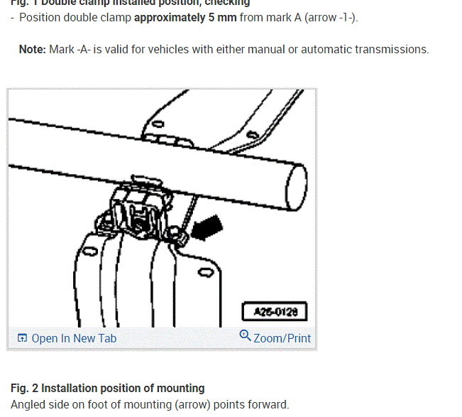

On the 1.9L diesel, there is one. It is located under the vehicle and is part of the exhaust system.
To get you started, here is a link that explains in general how one is replaced. You can use this as a guide.
https://www.2carpros.com/articles/catalytic-converter-replacement

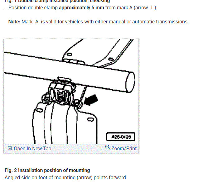

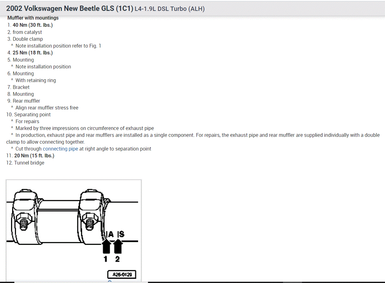

If you look at the attachments below, they include the directions for replacement and pics specific to your vehicle.
See pics below. Note: The directions below are for all components on the exhaust system. I'm adding them in the event they are needed.

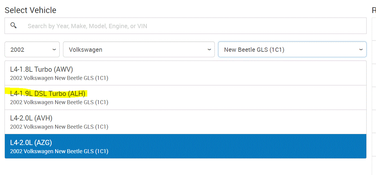

It is not a diesel engine, it's the 2 door hatchback GLS, is it still only one catalytic converter then?
Apr 6, 2021 at 1:04 PM
  • 110,241 POSTS
I am not showing a 1.9L gas engine. Take a look below at the pic I attached. It shows the options for a 2002 New Beetle GLS. The only 1.9L is a diesel. Could you have made a mistake on the engine size? As far as a gas engine, there is a 1.8 or a 2.0.
Apr 7, 2021 at 11:58 AM
GEN2299
I see, it’s actually the 2.0 i had it mixed up.

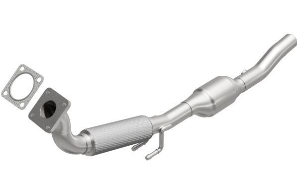

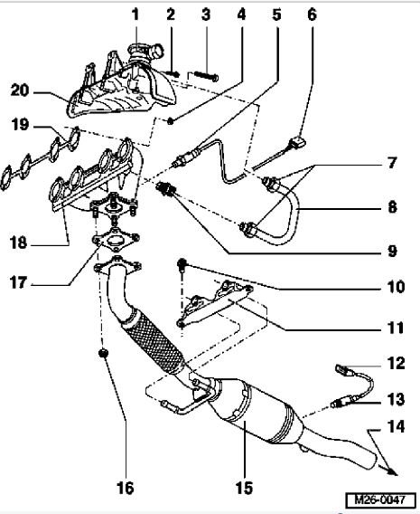

On the 2.0 it has a single converter mounted below the car. The 02 should have either an AVH or AZG code engine. That info will be on the emission sticker under the hood. It will also tell you if it's a federal or california emission car. That can be important depending on your location as some places require a certified part be used. They also used 2 different units on them, they are easy to tell apart, one has a single pipe as shown while the other has two that merge into one. If yours is an 02 it should be the single pipe version.
