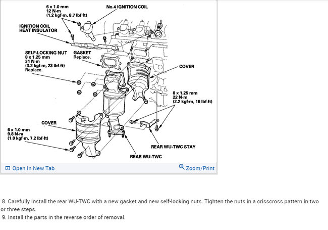

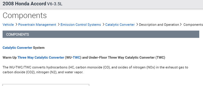

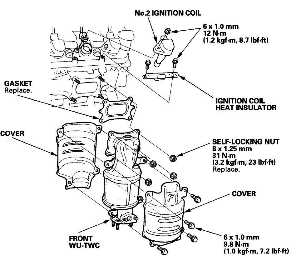

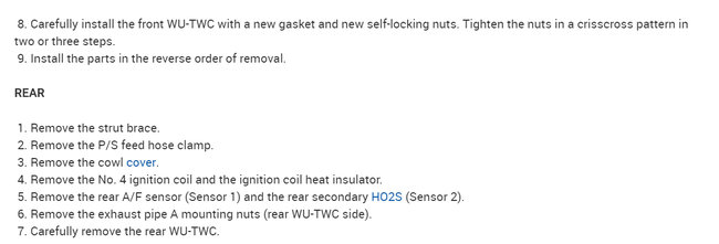

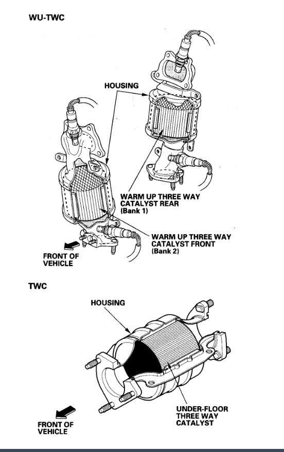

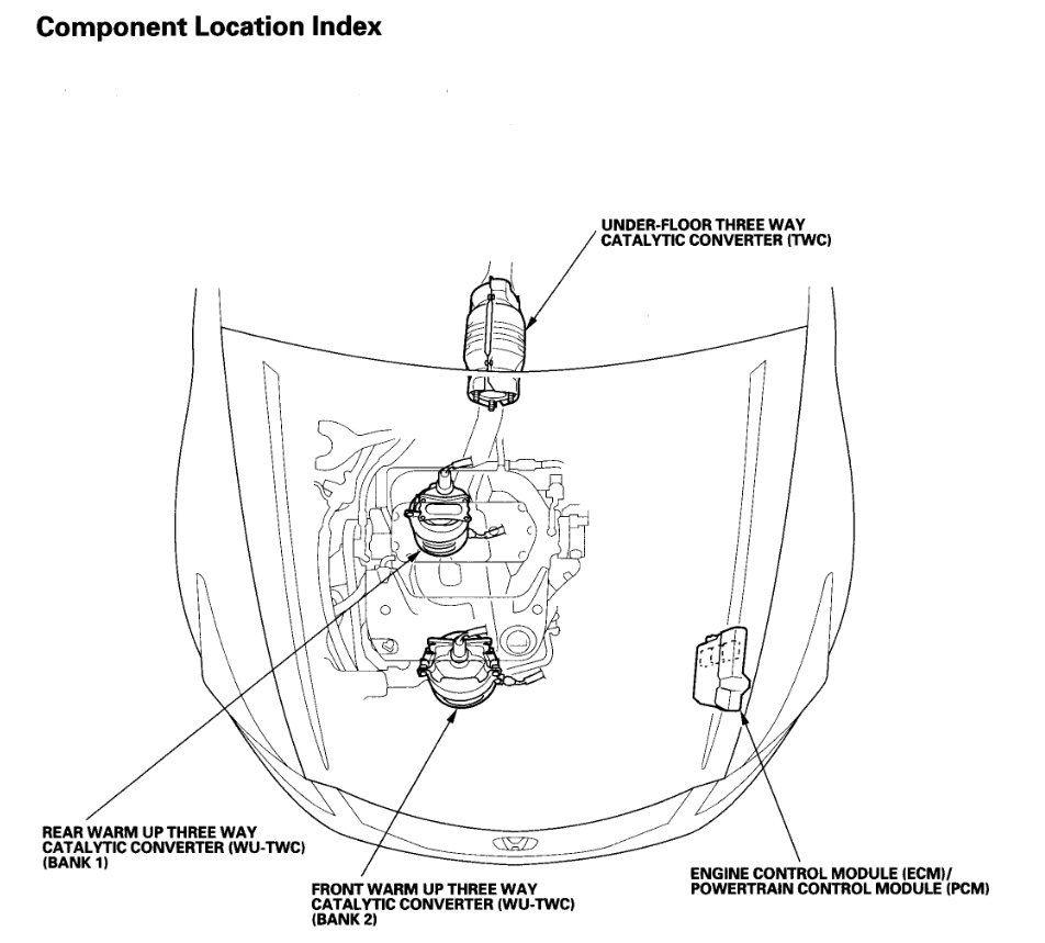

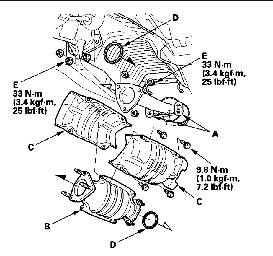

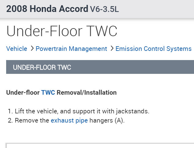

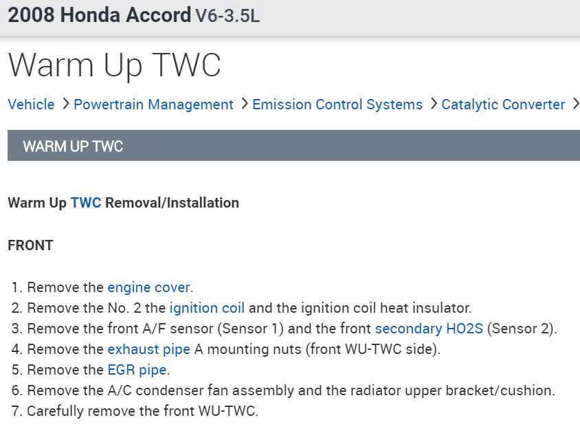

I am trying to find out how many catalytic converters my car has and and their location. As well how to remove it/them but I can’t find any information.
The reason is because I am getting a engine light about the bad catalytic converter.
Feb 18, 2019 at 12:00 AM
SCGRANTURISMO
  • 4,897 POSTS
I have included the information you have requested in the diagrams down below. Let us know if there anything else that can be of assistance with.
