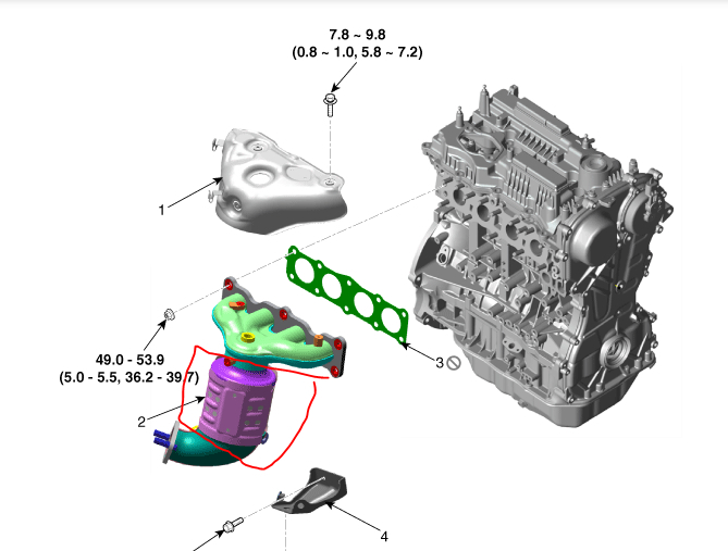

The vehicle listed above is an fe model. Does it have 2 catalytic converters?
Jan 8, 2023 at 4:32 AM
Experienced Mechanic
110,248 POSTS
The converter is part of the exhaust manifold. It is between the engine and the firewall under the hood.
I attached a pic below showing it. Let me know what is happening. Hopefully, I can help.
See pic below.
