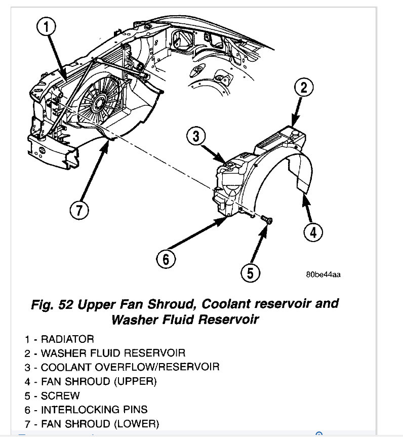

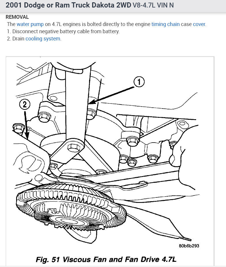

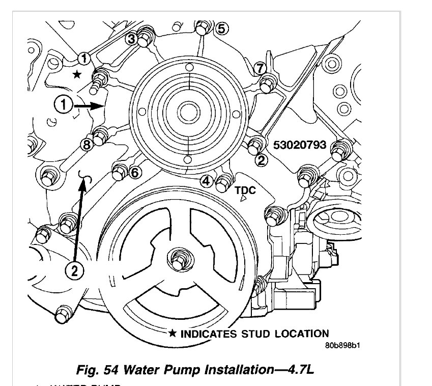

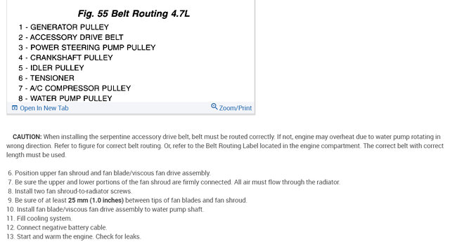

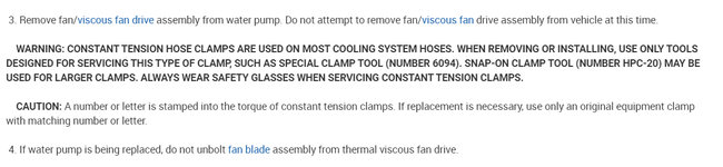

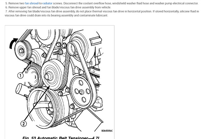

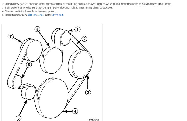

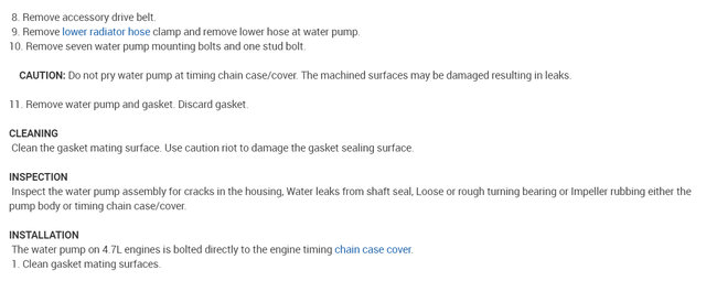

The catalytic converters are monitored by the computer and when they have a problem it will trigger a trouble code so I wouldn't worry about that, as far as the water pump, I would get under the truck and use a flashlight to inspect the "weep hole" to see if there are signs of leakage. If there is, I would replace the water pump. Also, you can grasp the fan blade (engine off) and try to move it side to side and up and won to check the play. This guide can help show you:
https://www.2carpros.com/articles/symptoms-of-a-bad-water-pump
Here is how you can change the pump out if needed in the diagrams below. Check out the diagrams (below). Please let us know what happens.
