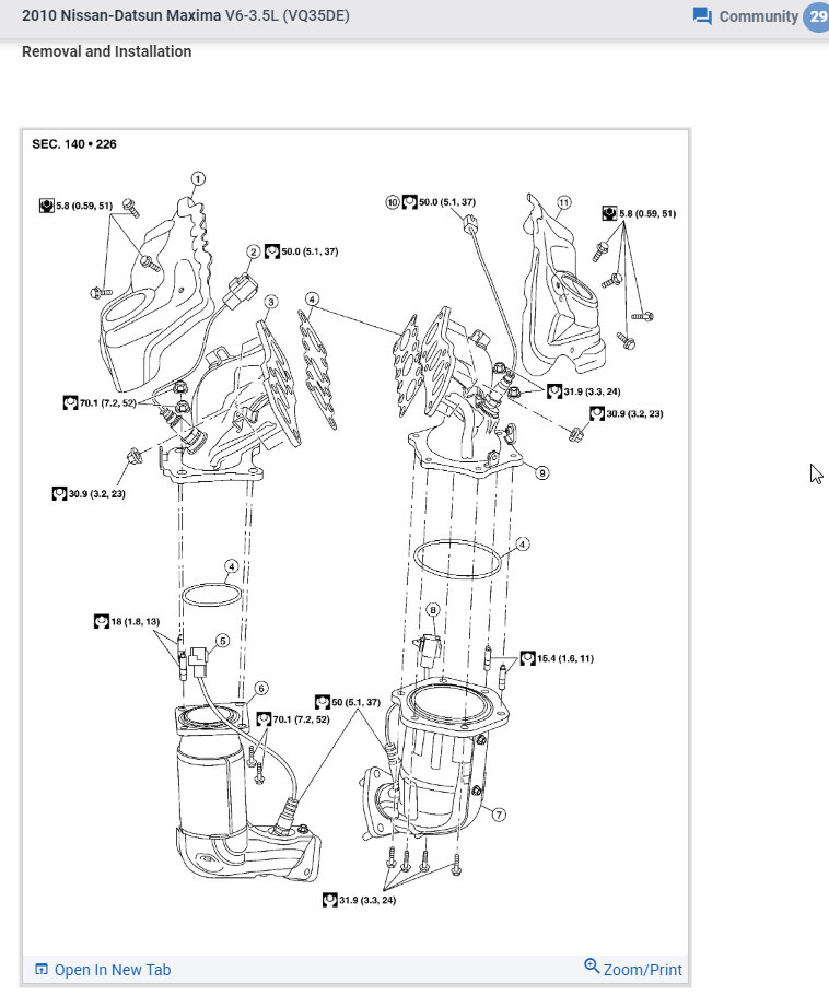

You have two. One coming off the front cylinder head and one on the rear.

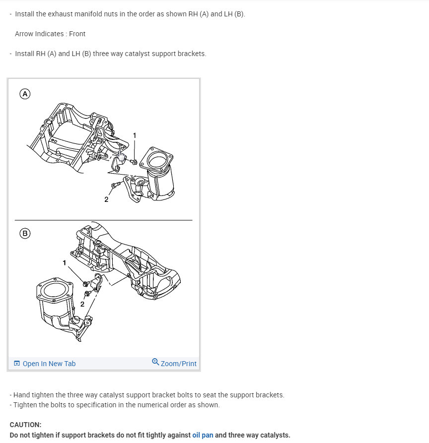

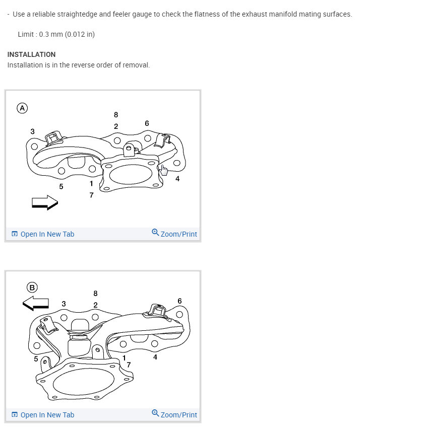

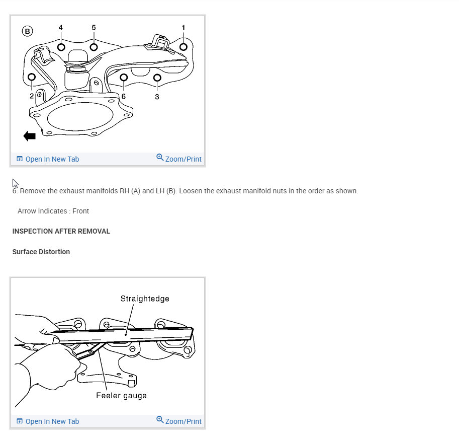

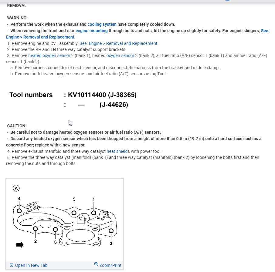

I attached the replacement procedure. Let me know if you have other questions. Thanks
