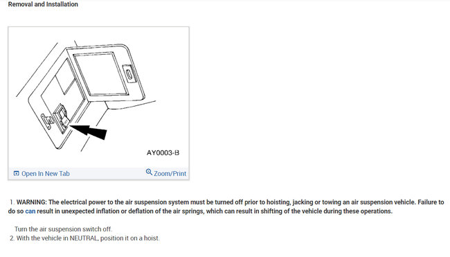

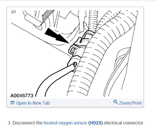

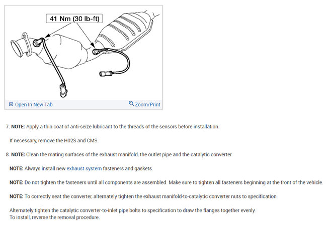

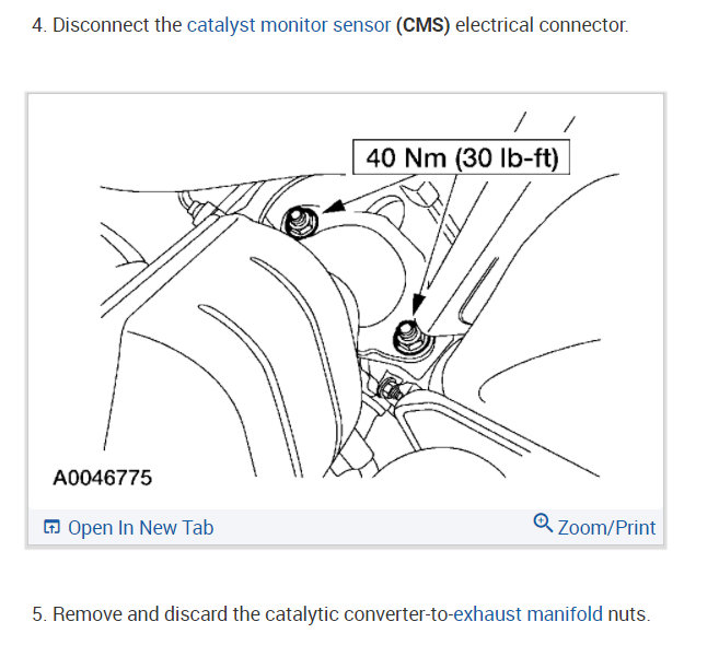

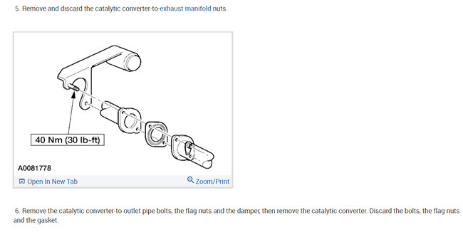

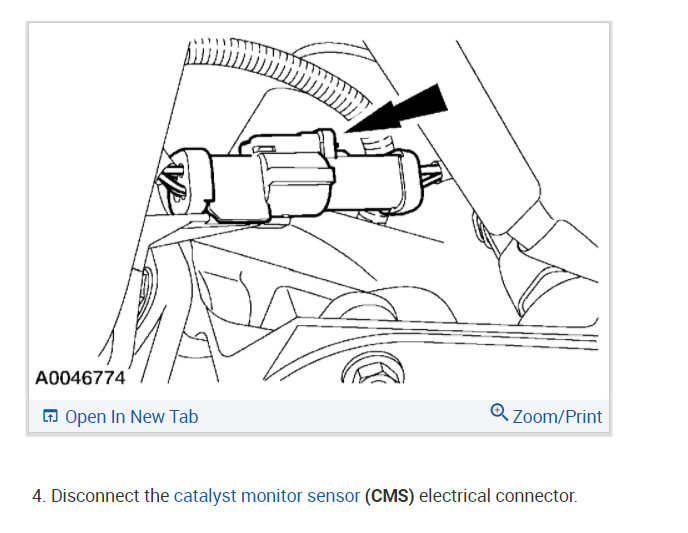

What are the socket sizes needed for the two nuts in the front and the two nuts in the rear? passenger side catalytic converter removal.
Aug 10, 2017 at 9:13 PM
  • 54,832 POSTS
You will need a 15mm deep well socket for the front and rear. Here are the instructions on how to replace the catalytic converter in the diagrams below. Check out the diagrams (Below). Please let us know if you need anything else to get the problem fixed.
