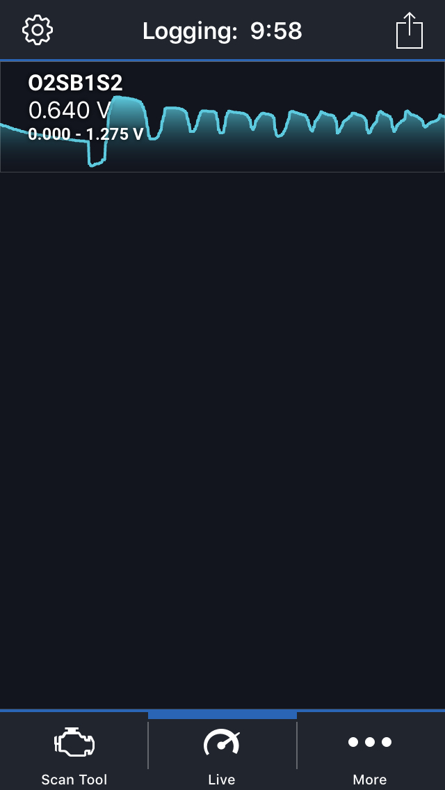

Hi, i took my car today to replace the defected EGR with new one as it caused check engine and code P0400. i did this and check engine disappeared, but he told me the cause of defected EGR is bad catalytic converter. i plugged my own obd2 tool and this support only graph for o2 sensor bank1 s2.
Which showed the graph down in attached picture. what is your opinion?
If it is bad what do you advise? To clean it? Can be cleaned or not? As you know the cost of new one is above $900.00 in my country.

Yes, based on the graph, the converter is bad. The graph should be almost a flat line. When it goes up and down like that, it is not processing the faes as it should.
As far as the EGR, was the old one melted?

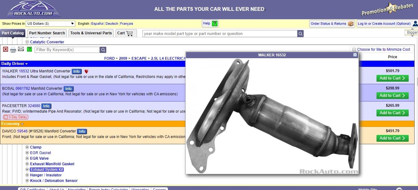

No, the converter is about $500.00 to $600.00 from Walker. I attached a picture from Rockauto for you of the part.

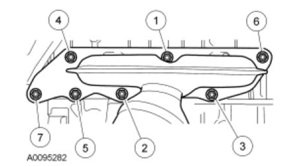

Installation
1. Install the 7 new catalytic converter manifold studs.
Tighten to 17 Nm (150 lb-in).
2. NOTICE: Failure to tighten the catalytic converter manifold nuts to specification before installing the converter bracket bolts will cause the converter to develop an exhaust leak.
NOTICE: Failure to tighten the catalytic converter manifold nuts to specification a second time will cause the converter to develop an exhaust leak.
Using a new gasket, install the catalytic converter and the 7 exhaust manifold nuts. Tighten in 2 stages in the sequence shown.
Stage 1: Tighten to 47 Nm (35 lb-ft).
Stage 2: Tighten to 47 Nm (35 lb-ft).
