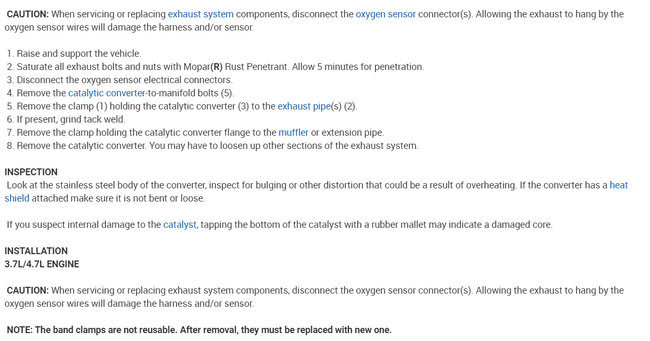

The code for the catalytic converter showed up when I went for inspection. Researched how to fix it without replacing it, so I bought a bottle of cataclean. Is it safe for my engine?
Sep 1, 2023 at 1:54 AM
  • 55,395 POSTS

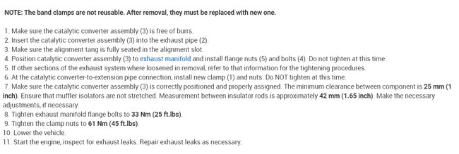

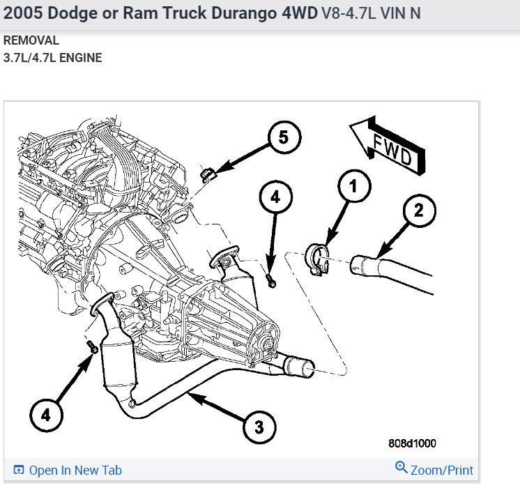

Yep, you should be okay. If it doesn't work, you will need to replace the converter. Here is a new catalytic converter for $43.00 on amazon:
https://amzn.to/44ANVFT
Check out the images (below). Please let us know how it goes.
