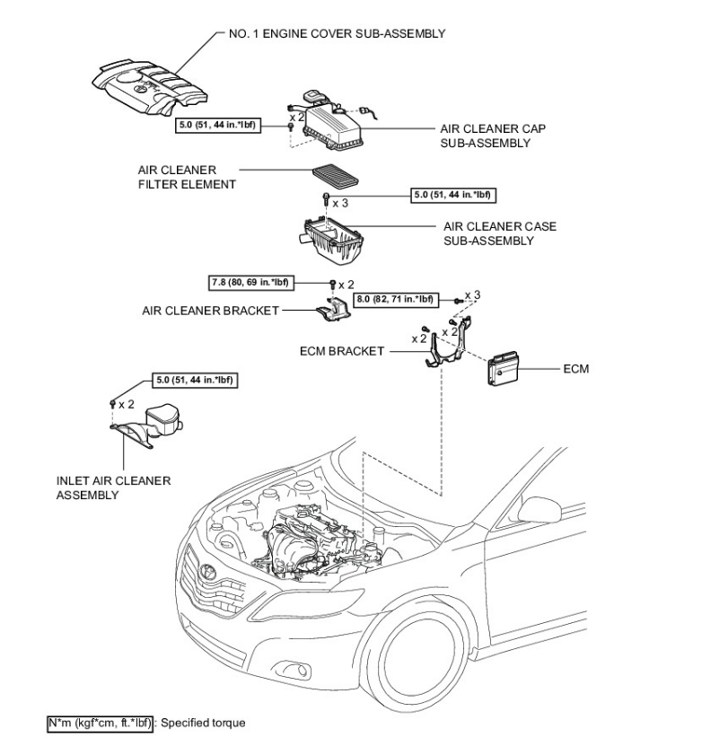

I've had to get both my catalytic converters replaced 1-2 times each. Totaling 3 replacements. I’m the 2nd owner of the vehicle, the previous owners didn’t get any maintenance done really whatsoever. So, I’ve been stuck with all the costly repairs as they come up. I’ve gotten my 02-sensor replaced, spark plugs replaced and keep getting the same P0420 code coming up every so often these days.
May 24, 2023 at 4:56 AM
  • 55,433 POSTS

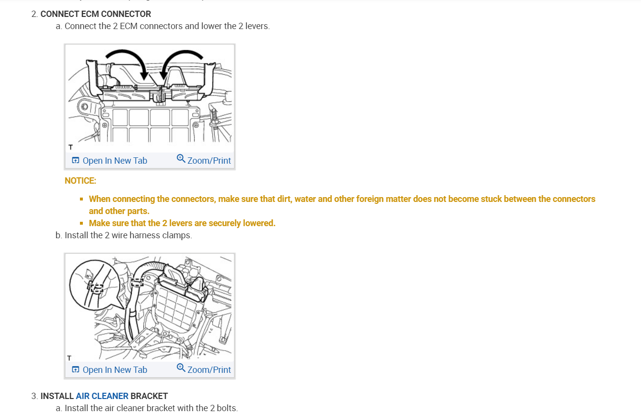

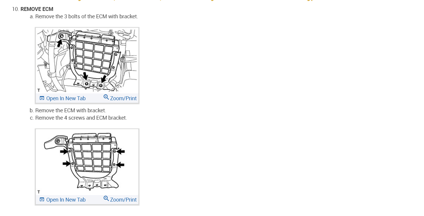

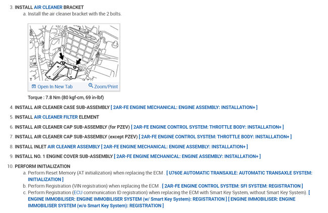

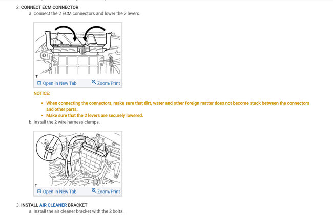

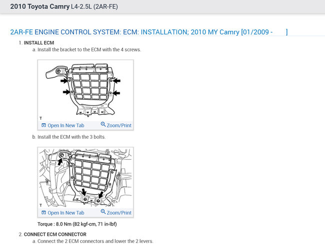

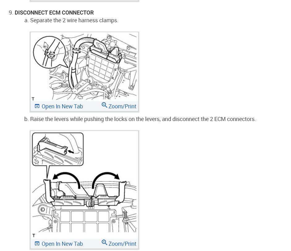

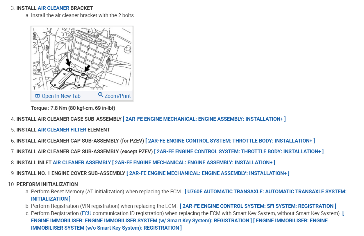

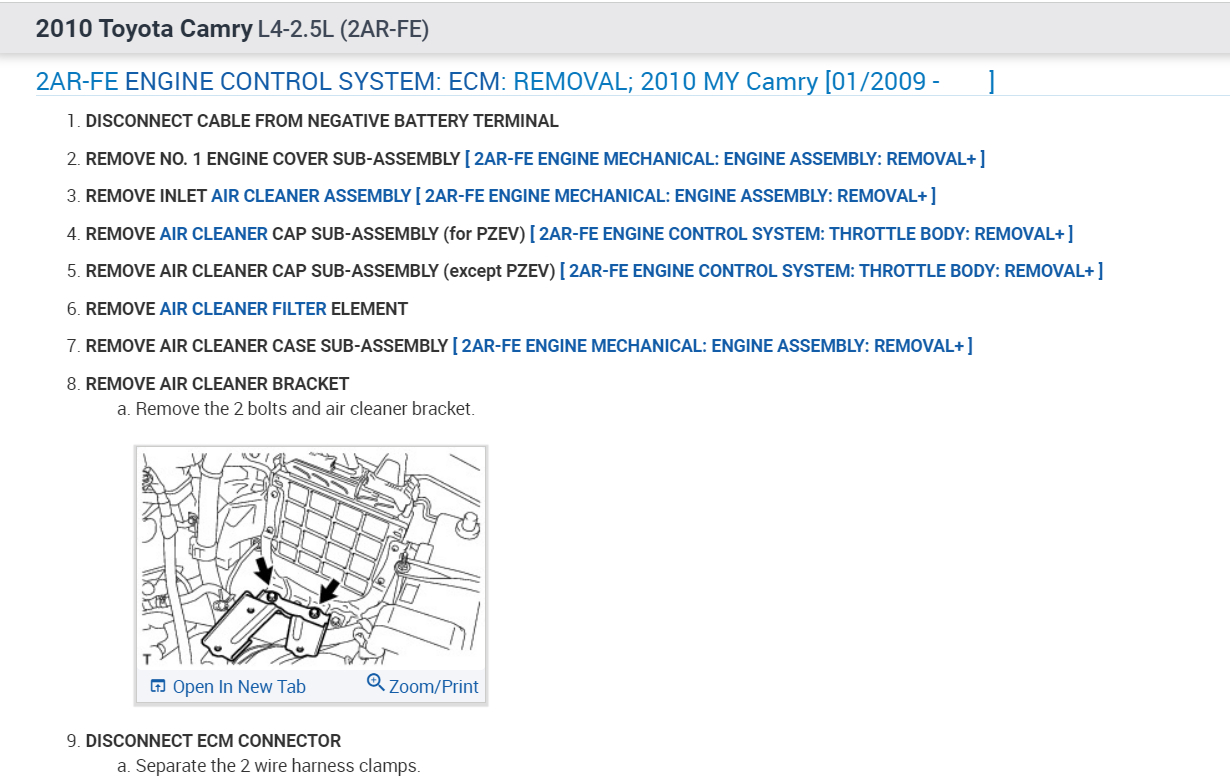

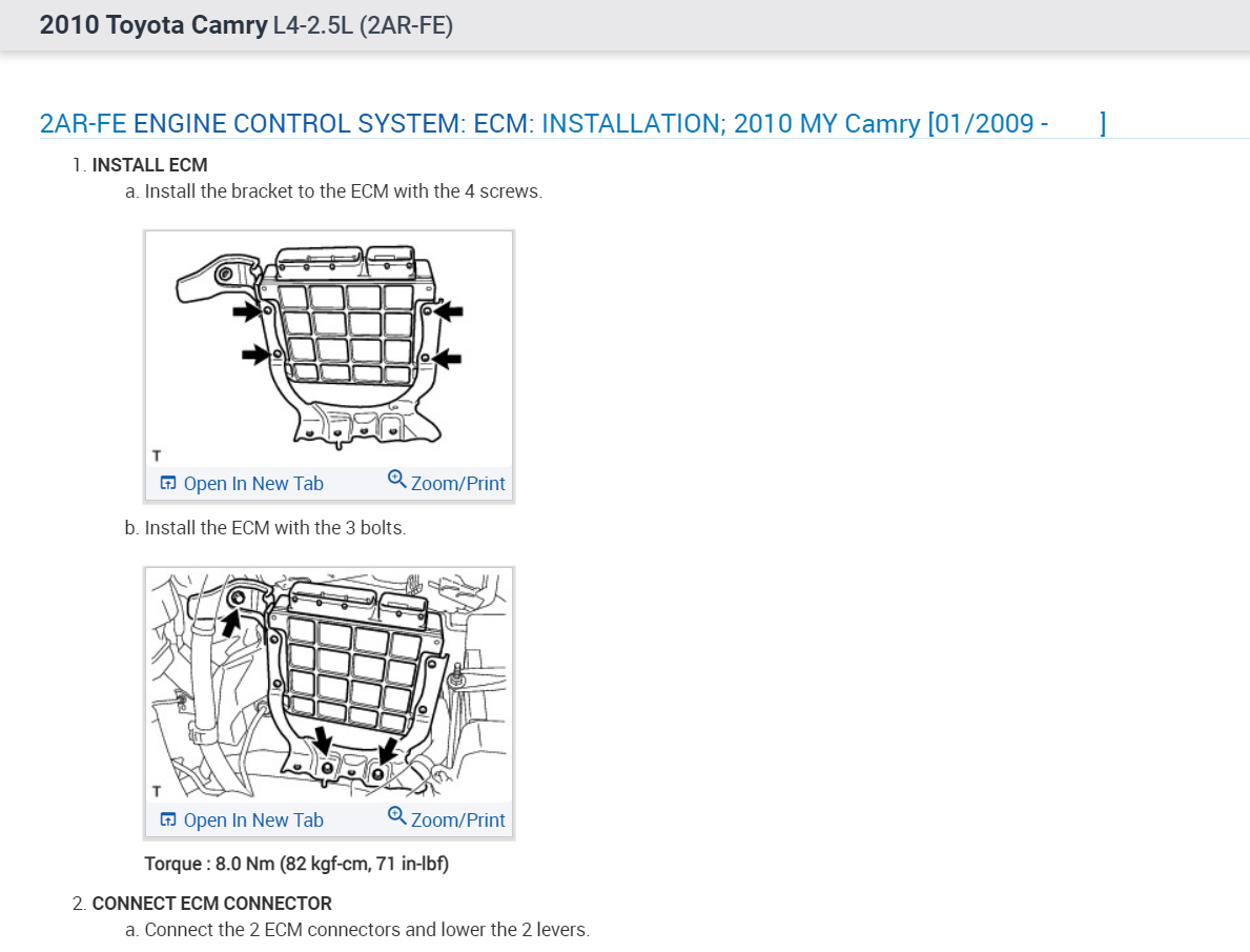

It sounds like you have an exhaust leak, or the engine is running poorly, how does the engine run? If okay and the cats and O2 sensor have been replaced the only other thing, is it can be a bad PCM because it has lost the ability to monitor the emission system. Here is the location of the PCM and how to change it out in the images below. You can get a preprogrammed unit by searching Google or Ebay.
