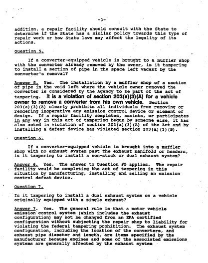

My stock down pipe has two catalytic converters but the second one is after the o2 sensors so it is pretty much pointless. Can I have a pipe welded in its place and pass inspection/emissions and just have the first one since it controls my emission. I live in Pennsylvania.

Positively not. It is against Federal law to modify that system in any way and removing a converter is a big time problem. Just because a converter is not monitored does not mean it does nothing.

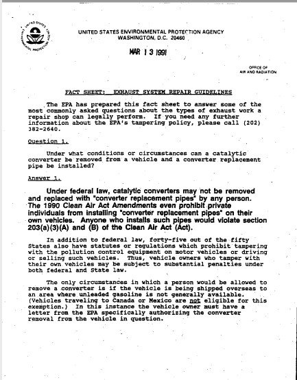

No. that is a modification that breaks Federal law also.

Read question 7 in this image.

I just showed you what the law is, Those publications came directly from the EPA. I am not saying that these laws are commonly enforced, but the laws on the books are very clear, no modifications.
