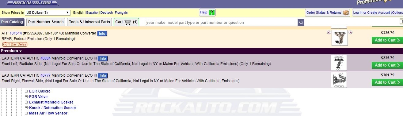

You have two catalytic converter. One on each exhaust manifold. One is in the front and one in the rear.
I attached a link to rock auto who has them but lists them as left and right.

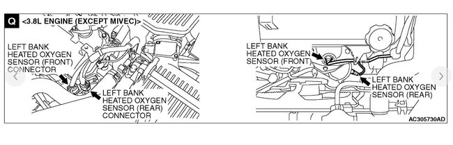

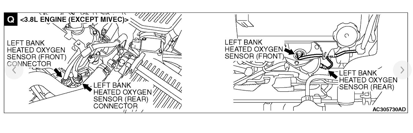

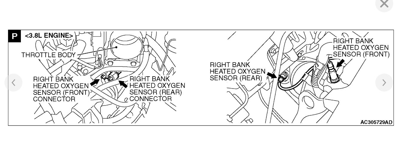

Secondly, I want to know which one is bank 1 and 2 is bank one the one close to the radiator? and in total how many 02 sensors does the car have?
Thank you so much.
Jul 17, 2019 at 1:02 AM
The firewall side is bank 1.
You should have 4 sensors. 2 upstream and 2 downstream.

Thank you for everything i saw the images but it said "non mivec" does it change anything because my engine is mivec.
I also looked underneath my car and saw something like a catalytic converter then the resonator pipe which is very confusing because that would mean 3 catalytic converters if that is not a cat what is that?
I would also want to bring my car to your shop if you have one and it is not too far from me. i live in Rockland county NY or if you can refer me to a good place to go.
You have been super helpful.
Thank you
Jul 17, 2019 at 3:41 AM
You are welcome.
No, I live in central PA. I do not have any connections with that area, sorry.
Does not make a difference.
