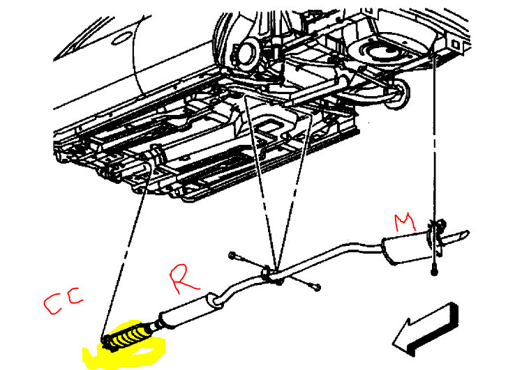

How many Catalytic Converters does this car have?
2004 BUICK LESABRE
192,000 MILES • 3.8L • V8
PUNKIN SELLERS
How many catalytic converters does the car listed above have?
Oct 4, 2023 at 2:05 AM
  • 110,244 POSTS
On this model and year, it only has one. The catalytic converter bolts to the down pipe from the exhaust manifolds. After the catalytic converter is the resonator and then the muffler. See pic below.
Let me know if I can help in any way.
joe
See pic below.
