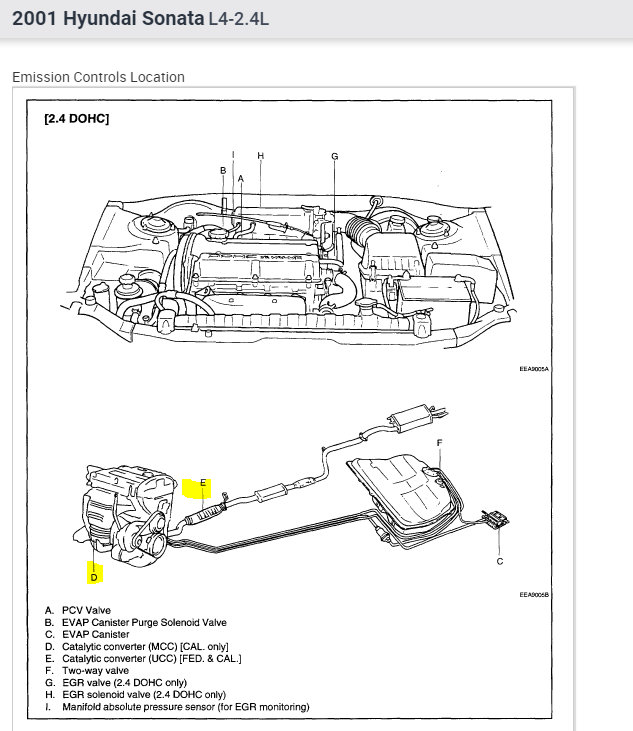

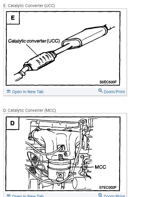

On which side are the catalytic converters located?

Your vehicle is equipped with two catalytic converters.
One is located in the front part of the engine, part of the exhaust manifold and the second one is under the vehicle on the exhaust pipe.
https://www.2carpros.com/articles/catalytic-converter-replacement
I have attached diagrams below for your reference.
Let me know of any questions.
