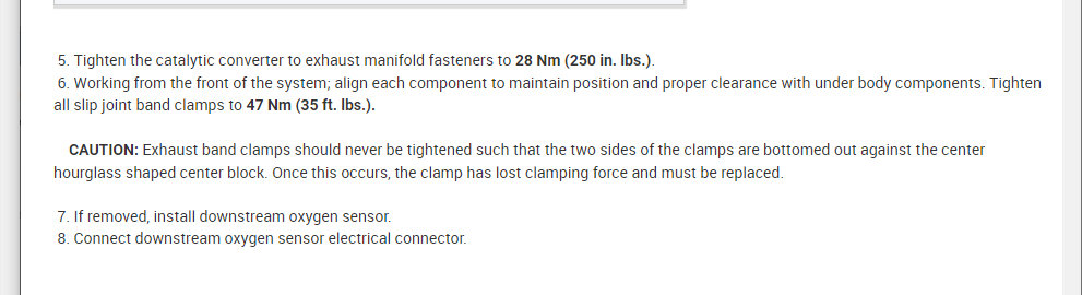

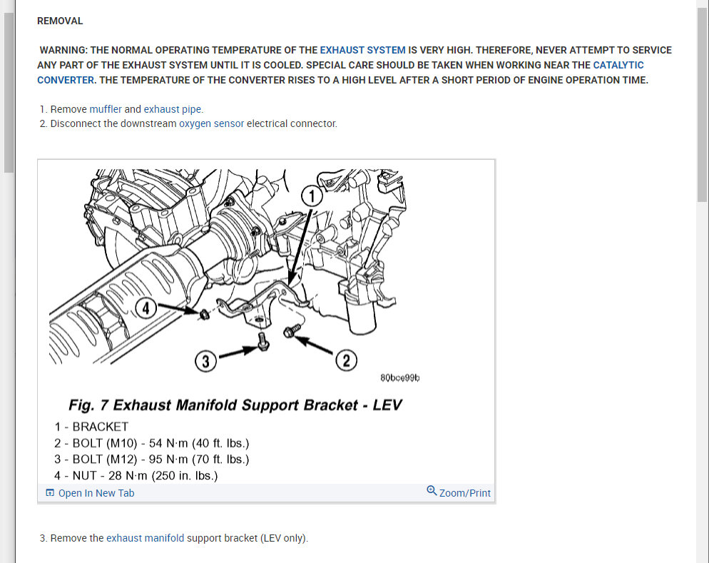

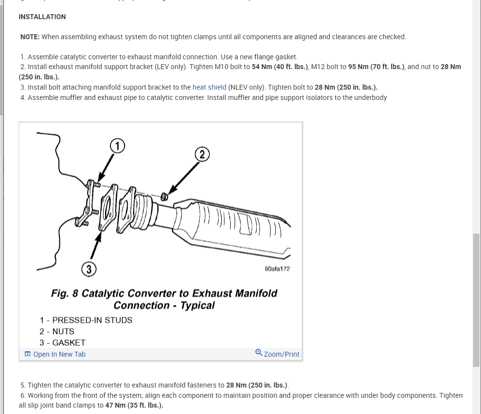

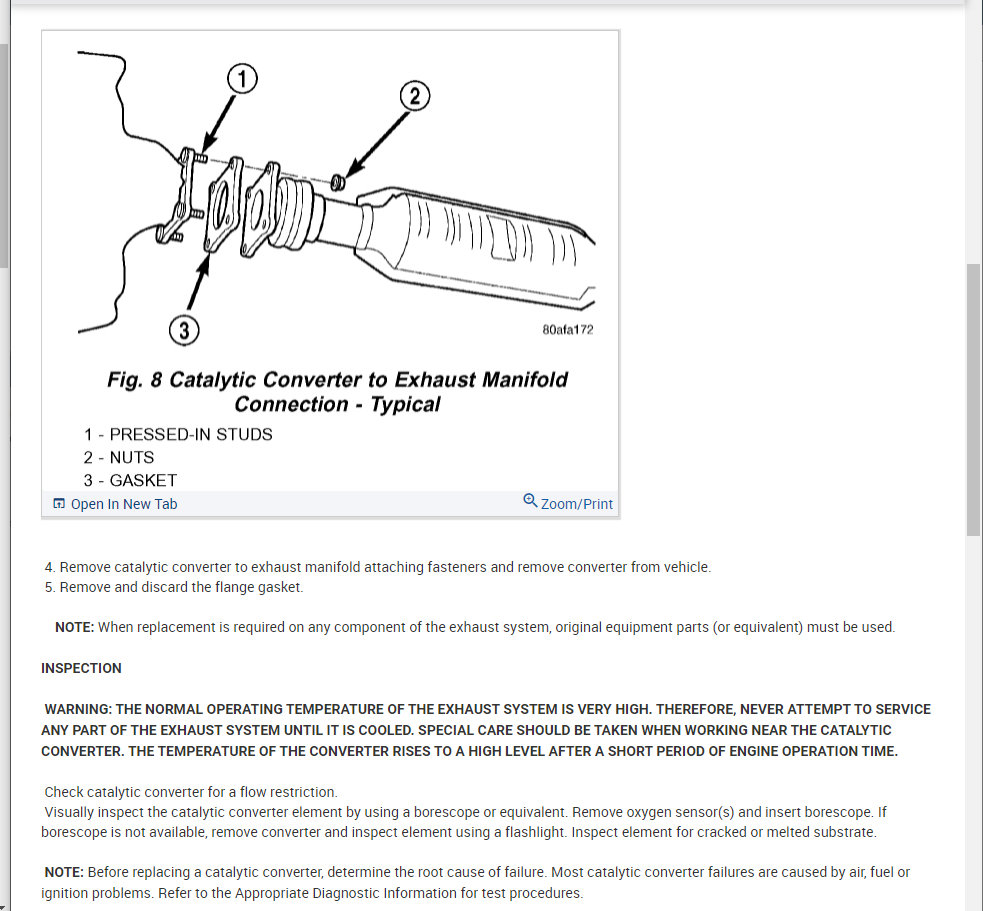

You have one converter on this vehicle. I attached the info below but here is a guide that helps with testing the converter:
https://youtu.be/kNXh1Lphzr4
Attached below is the process from the manual that will give the needed info. Please let me know if you have other questions. Thanks
