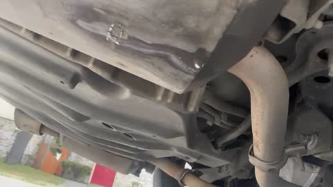

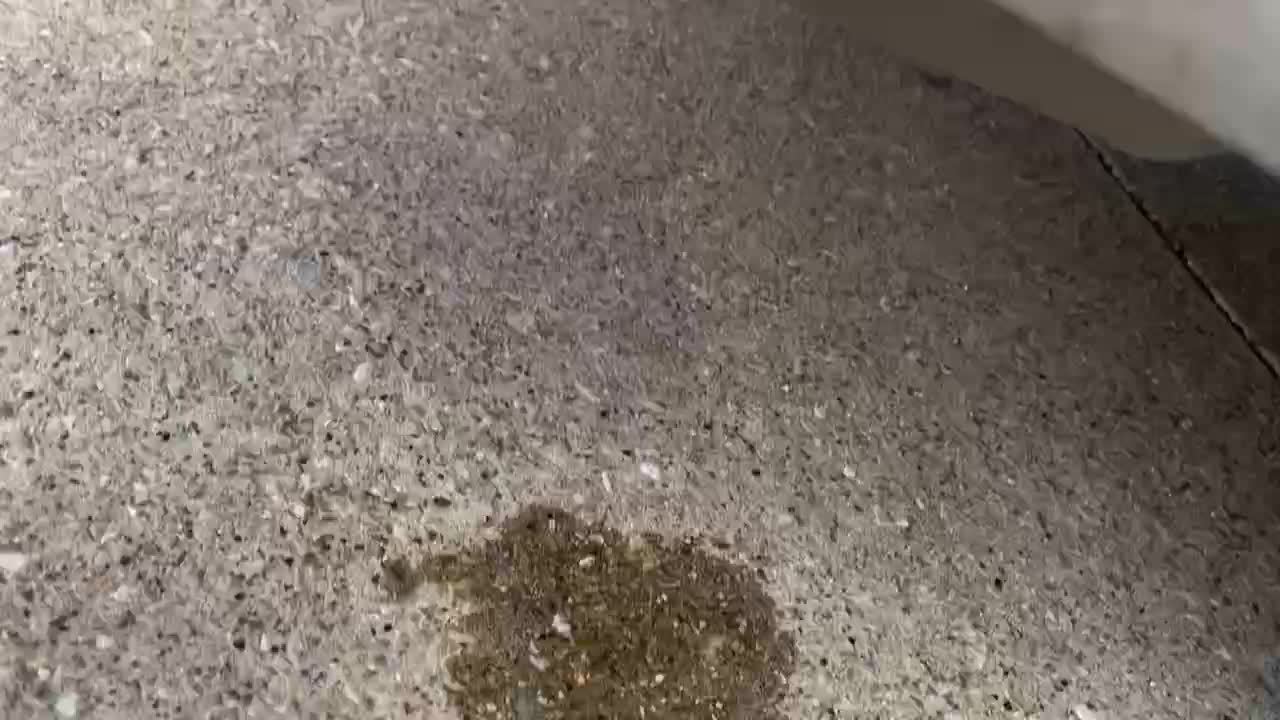

I went today to a shop and was told the catalytic converter at the manifold right side needed to be replaced. I also hear a pressure sound almost like a high-pressure gas gets released from the exhaust area. I saw the muffler was leaking water as well.
