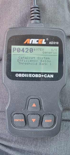

My SUV listed above is an SLT model and has been losing power while driving on the freeway and it idles a little rough, sometimes. The engine light came on and I got a code that reads P0420: Catalyst System Efficiency Below Threshold Bank 1.
catalyst converter or-oxygen sensors? I've Googled it but I'm not sure what to do, is it a bad catalytic converter or oxygen sensors? I'm not a mechanic but I can do minor jobs and I haven't been working so I cannot take it to a shop. I saw online that they have bolts on cat converters, if that’s the problem. Is that something that I can do at home, is it easy enough? Do you have any blueprints on how to change them out and where the bolts are or if it the o2 sensors can you tell me where they are? I guess I’m looking for good advice from someone who knows. Please let me know if you need any more info.

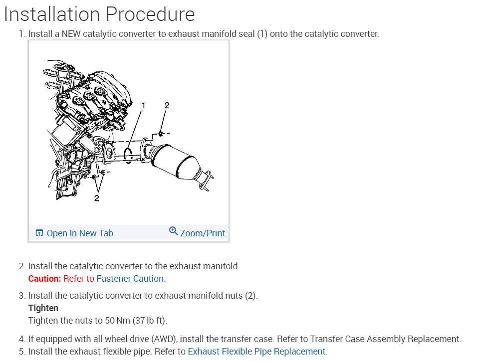

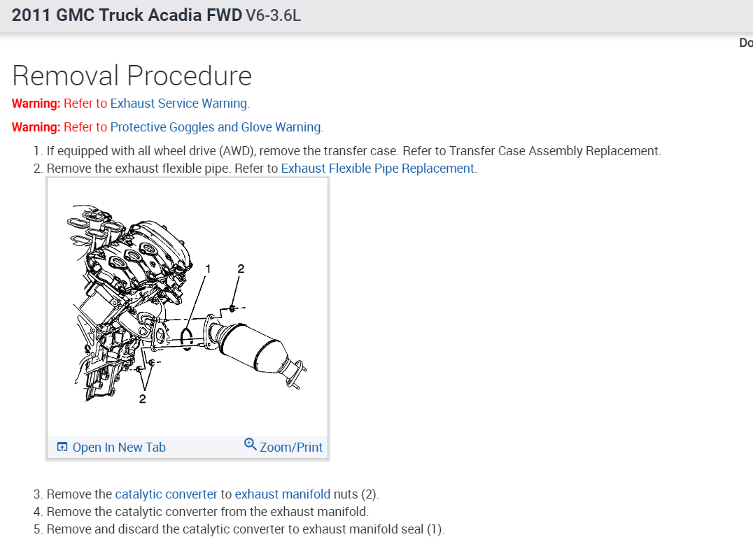

My bad, on this car they do sell them separately, bank 1 is on the right side of the engine closest to the fire wall.
Catalytic Converter 15903506 $865.00
Here is how the job is done. Check out the images (below). Please let us know if you need anything else to get the problem fixed.
