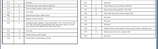

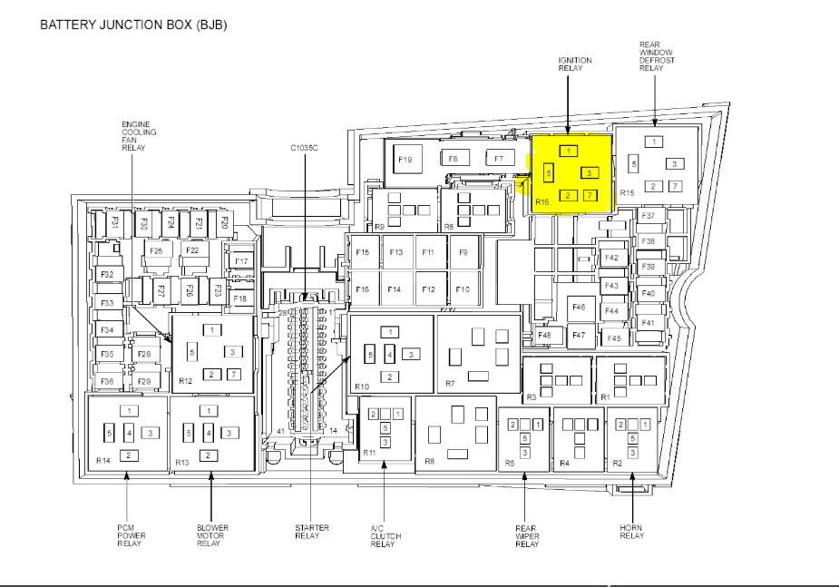

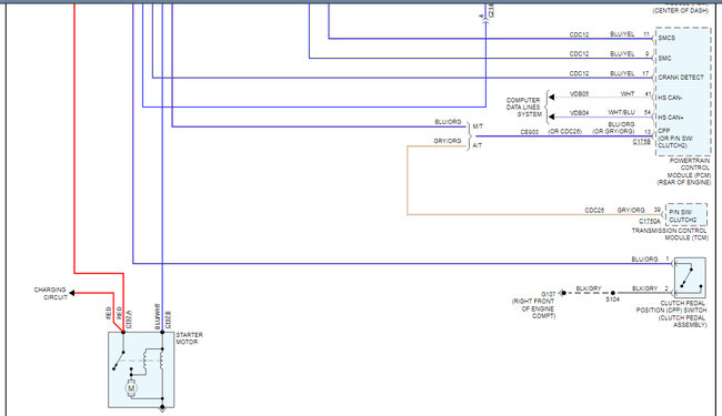

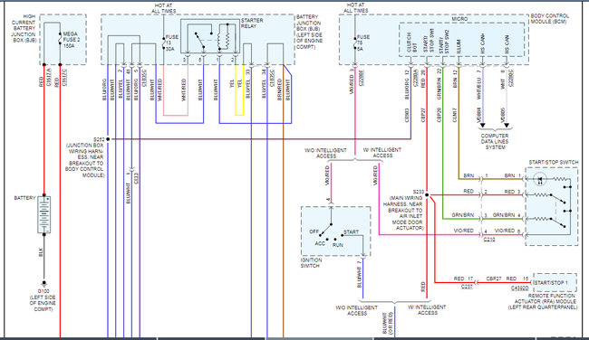

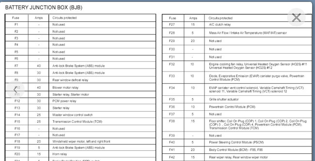

Okay, so this could possibly be a problem with your vehicle's starter relay, which is located in the Battery Junction Box [BJB], by your vehicle's battery. In the diagrams down below I have included a wiring diagram of the starting circuit in your vehicle as well as the diagram and callout of the BJB for your vehicle. Here is a link down below for you to go to explaining how to test a relay:
Please go through these guides and get back to us with what you are able to find out.
