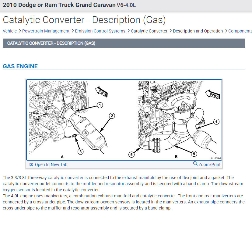

How many catalytic converters does my van have?
Aug 30, 2021 at 12:03 AM
SQM
Experienced Mechanic
6,383 POSTS
This vehicle has two converters, one for each exhaust manifolds. Some of the California emission vehicles had 3 converters.
