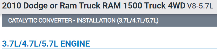

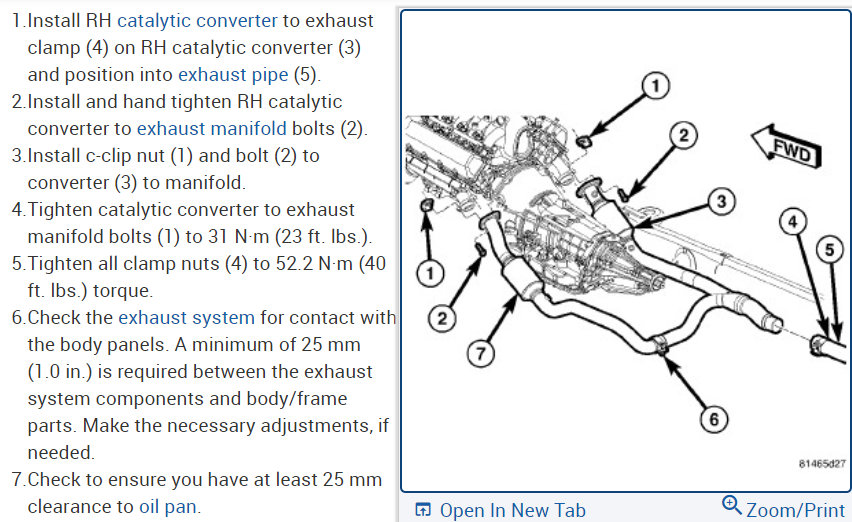

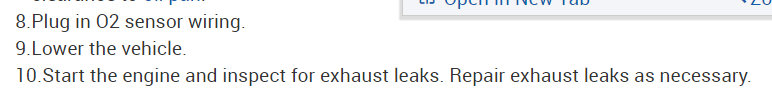

Sometimes when a catalytic converter fails chunks of the substrate will break and rattle around inside the converter and is what you might be hearing rattle. It can cause damage to the exhaust system, will trigger the check engine light, and will cause performance and gas mileage loss. I've attached picture steps below on how to replace the catalytic converters on your truck. Hope this helps and thanks for using 2CarPros.
