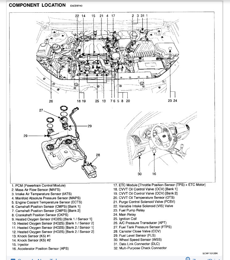

Check engine light came on indicating bank1 sensor1 O2 sensor, so I replaced it. Then bank2 sensor2 came on shortly after, so I replaced that one too. Then code for both sensors pre-CAT plus code for the CAT itself came on. I reset them a few times but the check engine light comes back after 100+ miles, and all 3 codes are still there.
I have not replaced the 2 O2 sensor after the CAT, only the ones pre-CAT were replaced.
Car runs great and only 167,000 with no engine issues... not a drop of oil loss.
Need help please. Thank you in advance.

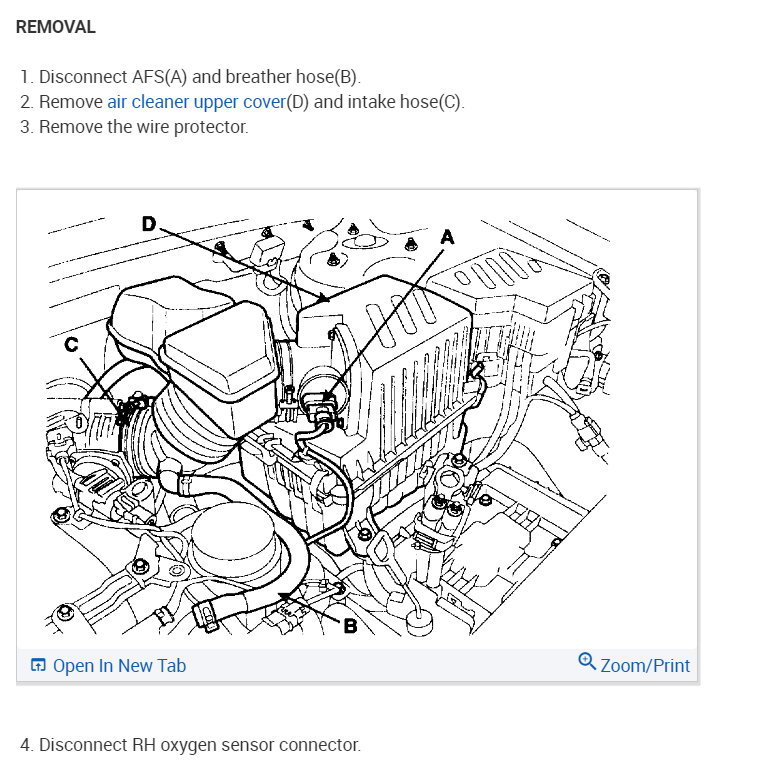

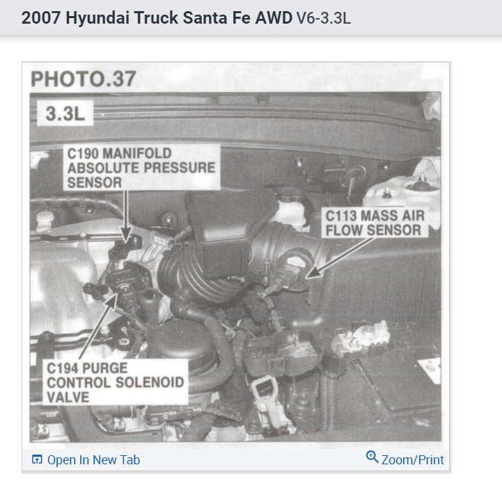

I assume the oxygen sensor codes are for sensor rich. This will make the cat overload and trigger a cat efficiency code. Have you checked the air filter if it is clogged it will cause this issue? If the MAF sensor is off will cause this issue also if you have injectors that are starting to go bad because they don't atomize the fuel correctly. Also, if you have the code numbers it will help. Here is the location of the MAF sensor so you can check it out and replace it if necessary. Check out the diagrams (below). Please let us know what you find. We are interested to see what it is.

Air filter is new, and I believe the MAF is pretty clean... I used MAF cleaner after all the codes popped up but that didn't solve the problem. Both of those sensors were replaced with sensors (rockauto) but the codes stayed on.

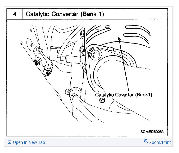

Question: what's the best way to get the bank 1 CAT on the firewall side out? Not a whole lot of room or access from the bottom. I'm assuming from the top is easier after removing the intake manifold? Shows 8 bolts and nuts holding the CAT on, how do I get to the bolts without hurting myself?

First make sure the engine is cold and spray WD40 on the bolts/nuts. Have jackstands under the car. Here is a generic guide that can help walk you through the steps with an image below.

Thanks for the info, however the CAT I'm replacing is the one that mounts directly on the engine manifold on the firewall side and comes down vertical. Very little space to get to. But I managed! Removed the intake manifold and got to unbolt it from the exhaust manifold from the top. I pulled the entire CAT upward and out.

So, after replacing bank 1 CAT, this is the one next to the firewall, the check engine and p0420 just went away! Car passed emissions test. no codes for couple months.
