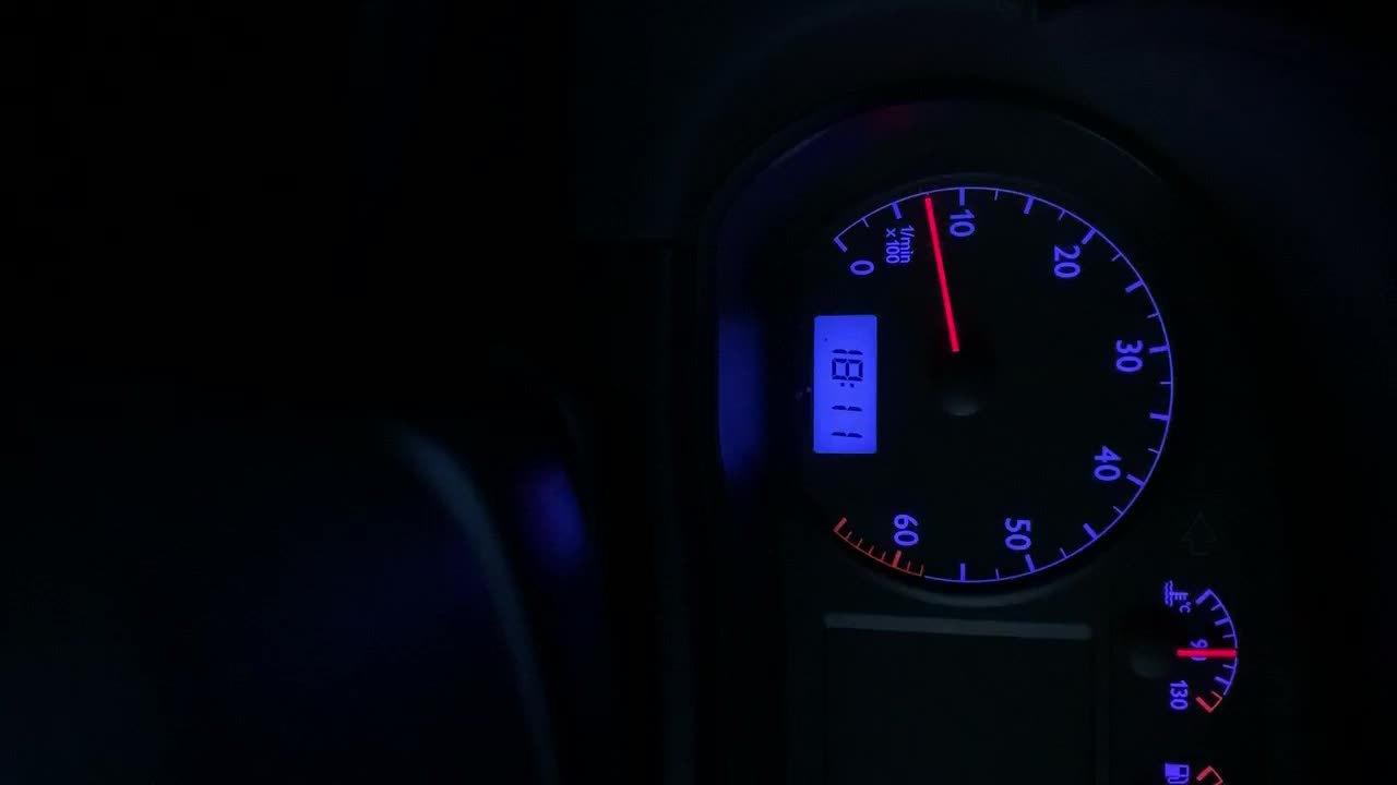

It is possible that when they cut the catalytic converter off they cut it off incorrectly and cut into the honeycomb inside and caused a piece to break free after it was reinstalled causing a blockage. Is your vehicle's temperature running any hotter than normal? Here is a link below, to a guide explaining how to test your vehicle's catalytic converter:
From the video that you sent I would also recommend checking for a vacuum leak. Here is a link to a guide below that explains how to do that:
When your rpm's at idle are higher than they normally run or your rpm's are "searching" like your vehicle's are, this indicates a vacuum leak, which would also have all of the driveability concerns that you are expressing. Please go through this guide and get back to us with what you find out.

After searching this online I found the same thing about the honeycomb, I’m waiting on the garage to get back to me regarding this .. as to the code I’m not sure as my obd2 reader doesn’t pick up my car..
I have to drive at about 25 in 1st then change gear to 2nd otherwise it will stall I don’t know if this helps at all?
