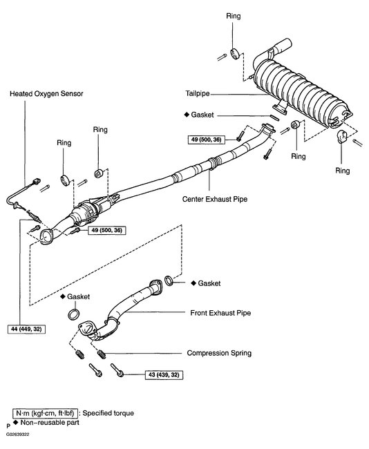

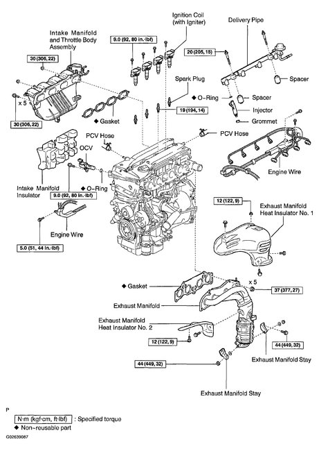

STEVE W.
  • 15,418 POSTS
Look on the sticker under the hood. It will tell you which emissions standard your car was built to meet. For instance I'm in NY, BUT every car sold in NY has to meet the California emissions standard. So if your car was originally sold new in NY you may have a CA emissions package.
As to the two different convertors, Check your car as it should have come from the factory with both of those on it. The front one is the primary cat, and mounts on the engine the one under the car is the secondary cat. The front one is monitored by the PCM, the rear isn't.
Imagee 1 shows the under-car piping. Note the single O2 sensor in front of the CAT. That is B1 S2. B1 S1 is in front of the catifold. See second image.
