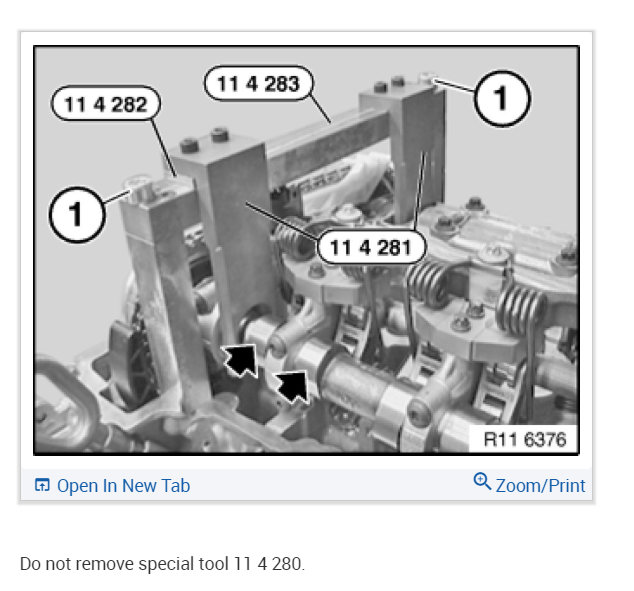

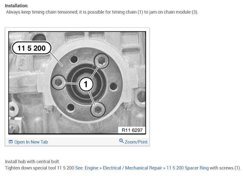

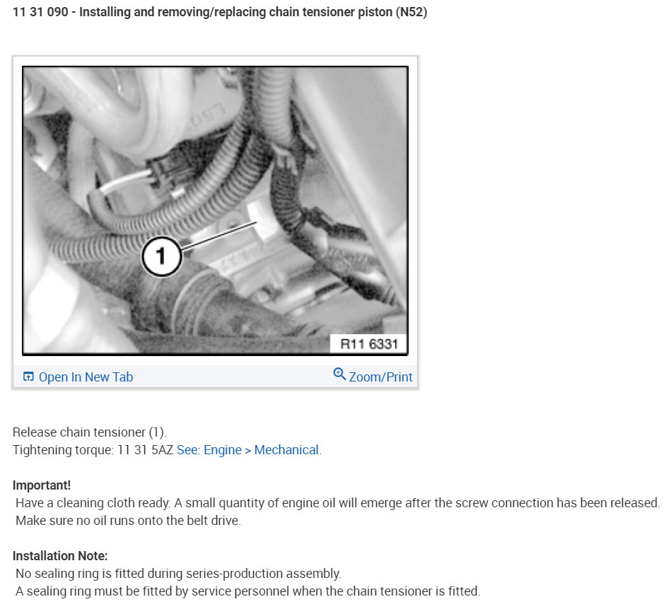

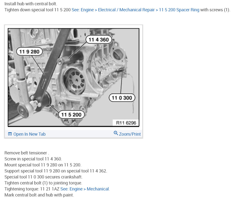

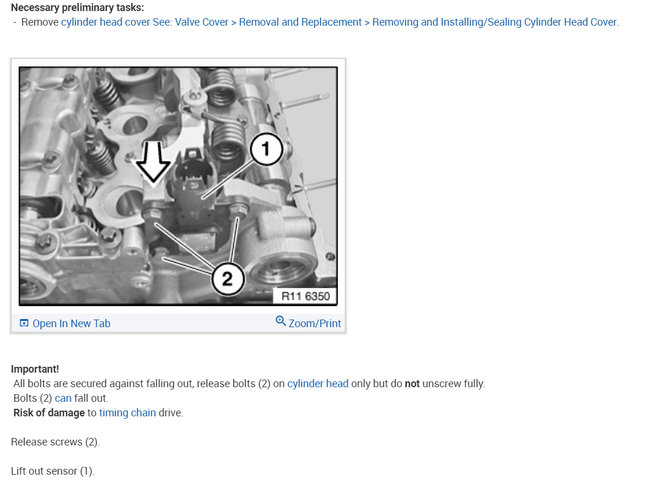

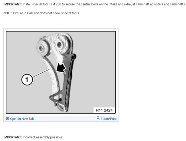

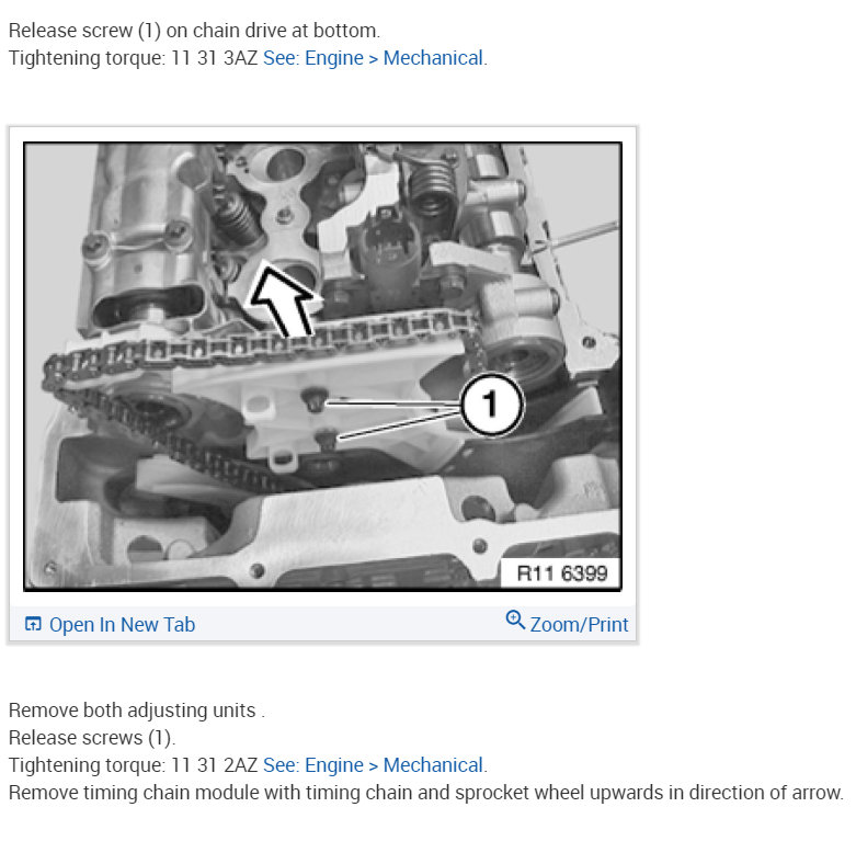

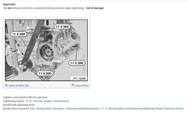

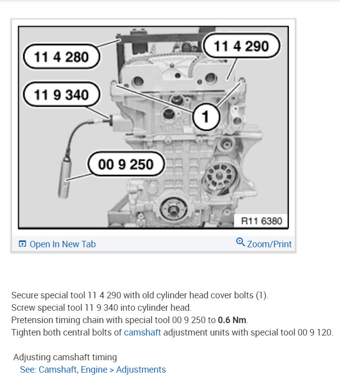

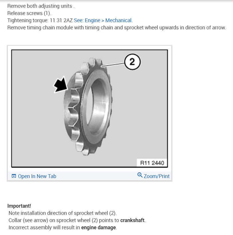

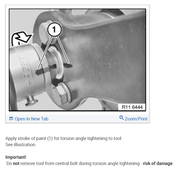

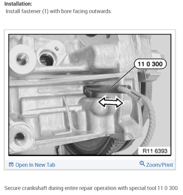

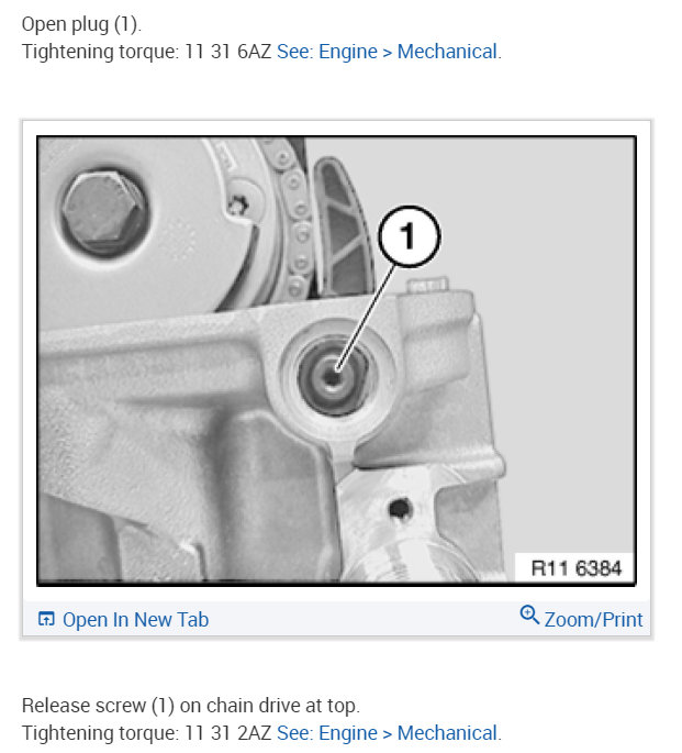

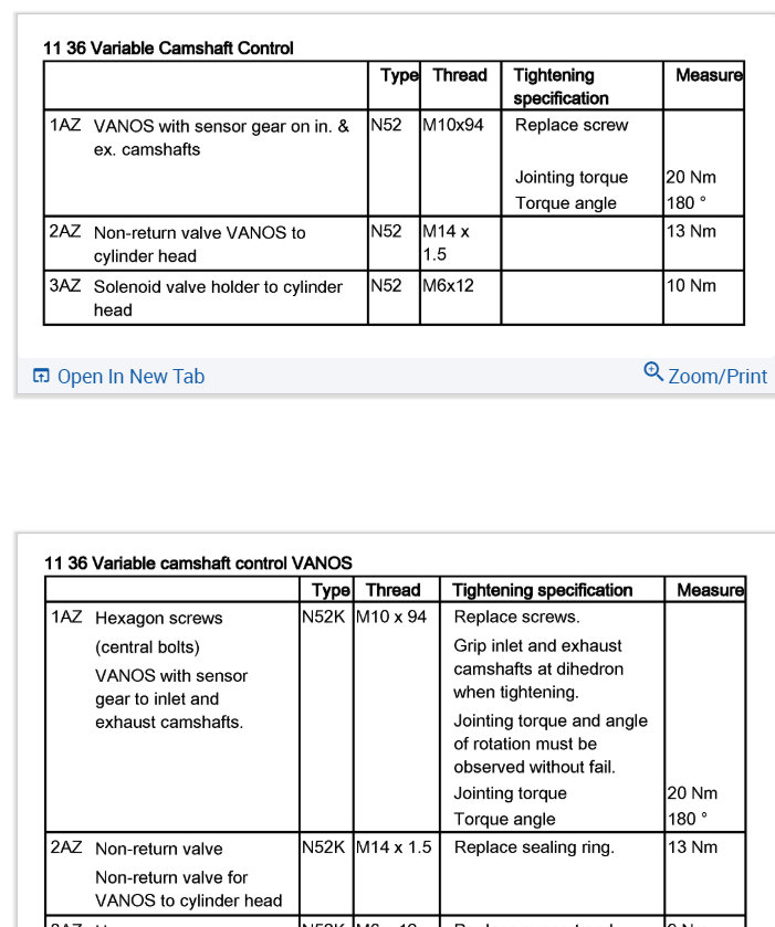

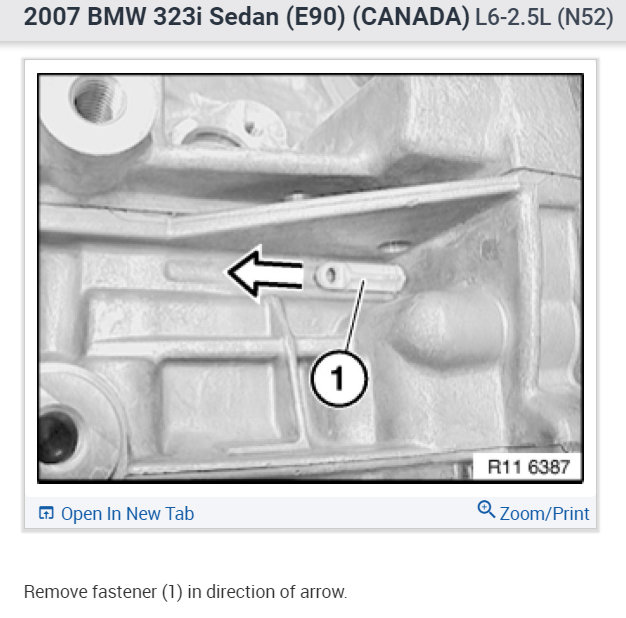

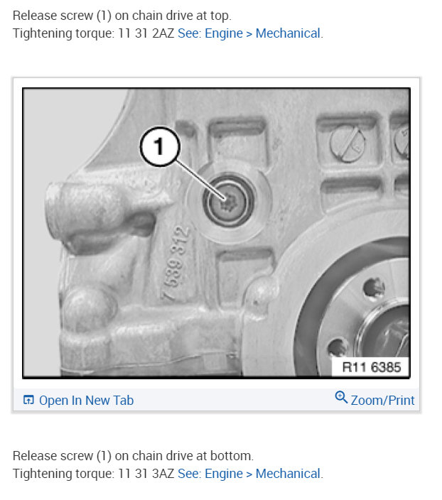

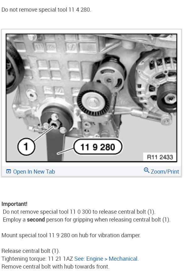

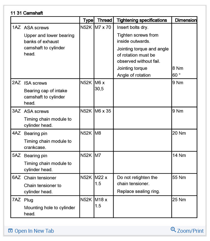

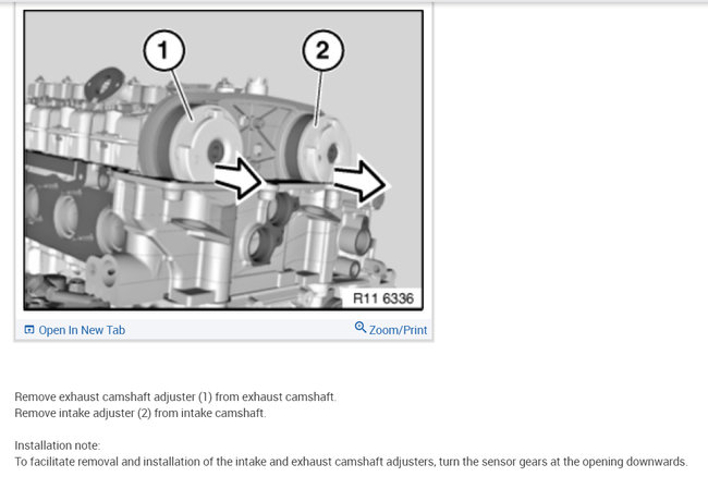

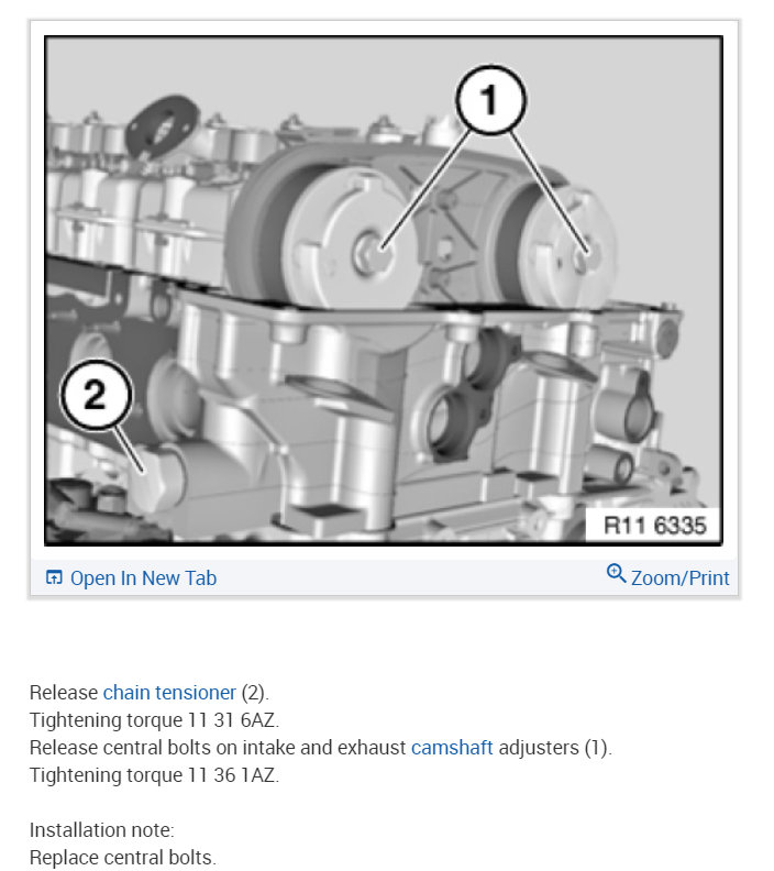

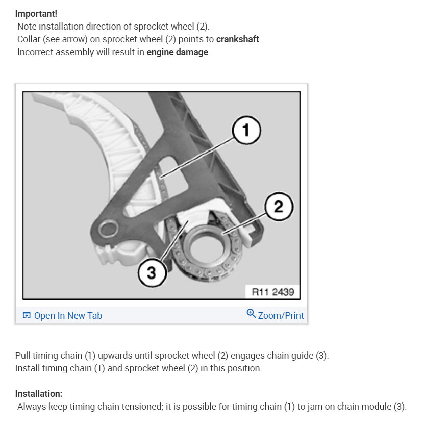

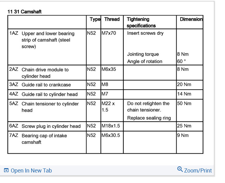

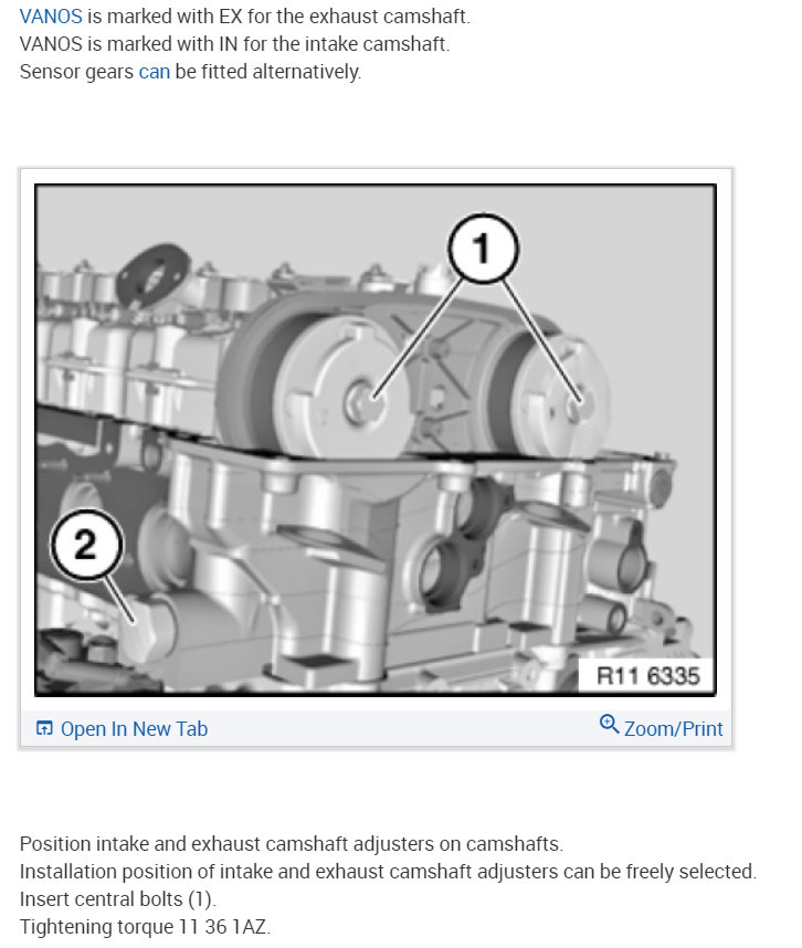

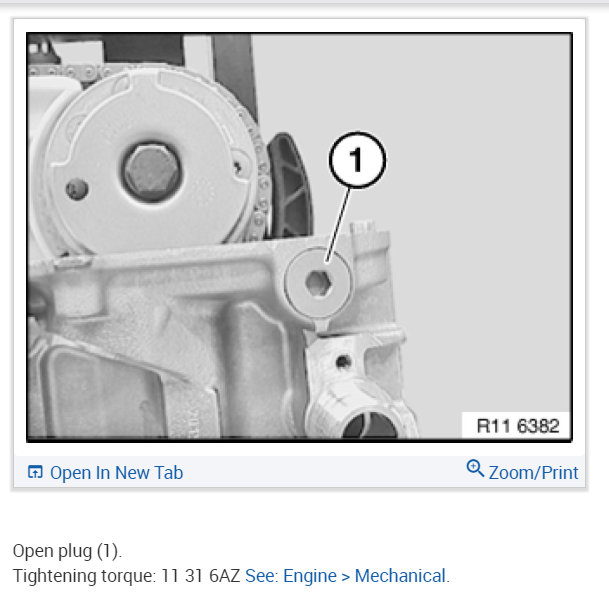

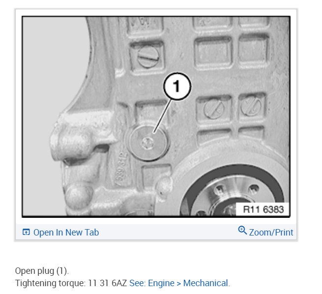

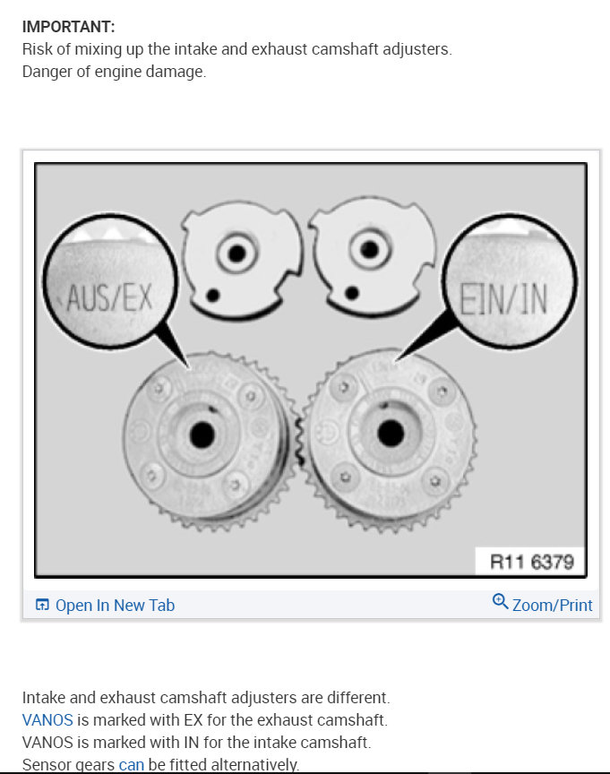

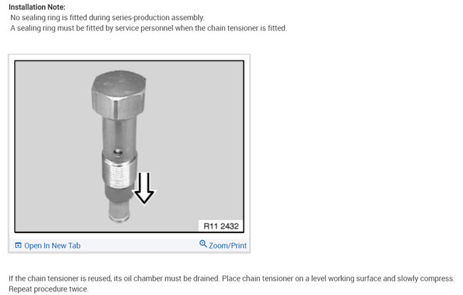

Thanks for the video. It sounds like the timing chain guide is broken or you have a vanos that is out either way the front of the engine needs to come apart to see what is going on. Here here the diagrams to help us do the job. I will walk you through the repair. You can get the parts and tools from Ebay. This will not cause low compression on one cylinder though so that is a concern. How low is it? Check out the diagrams (below). Please let us know what you find. We are interested to see what it is.
