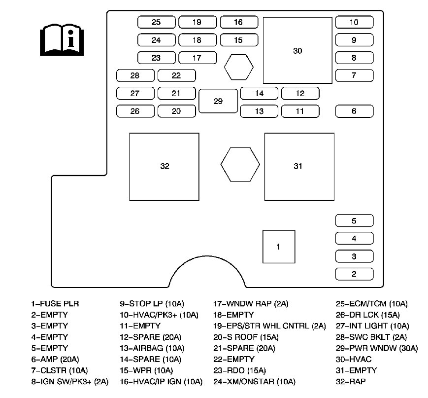

My car won't start or turn on when I turn the key. It was all working fine then just stopped working after picking up an order at Applebee's. I just tried replacing the ignition switch, but to no avail. Tested the battery and it's charged and free of corrosion. Also unplugged the Amp for my subwoofer as well and that didn't work either. I am out of ideas...
Sep 7, 2024 at 3:02 PM
  • 54,837 POSTS

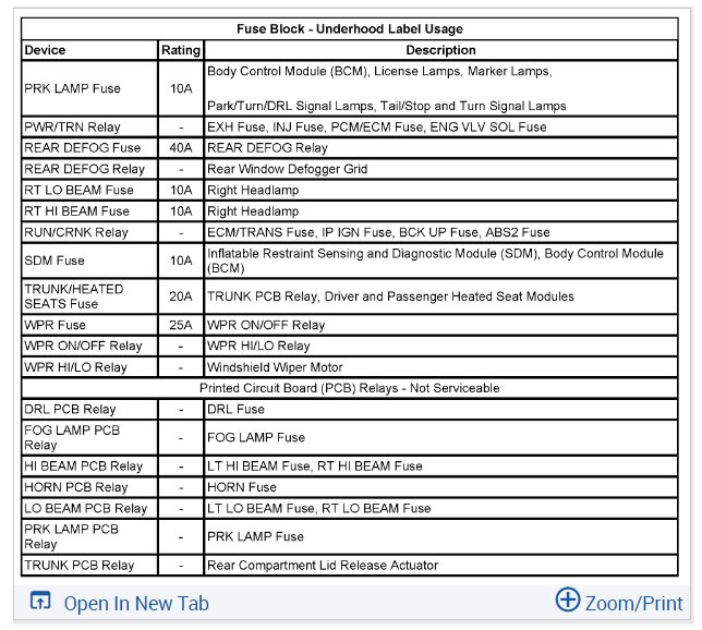

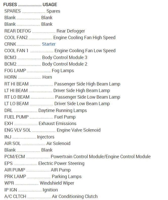

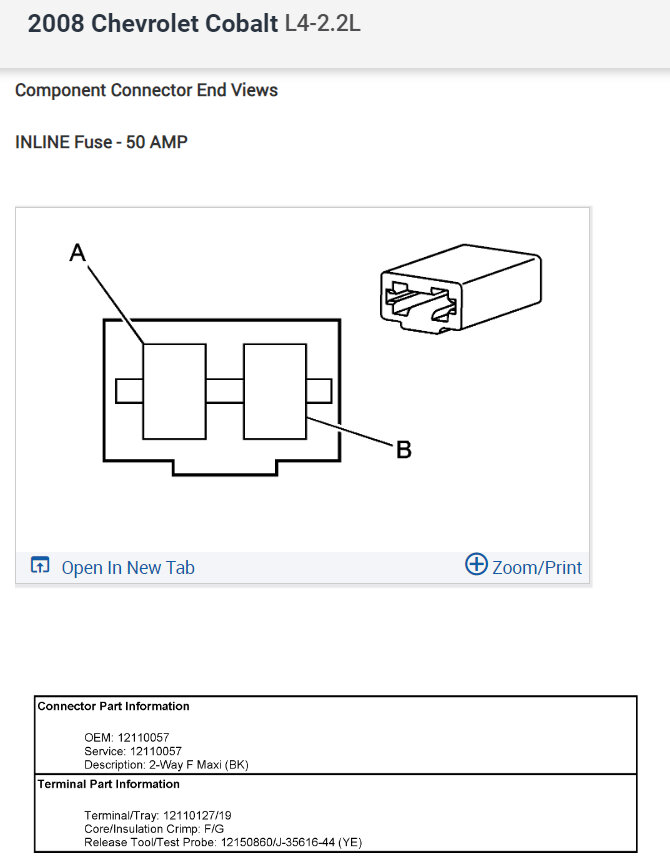

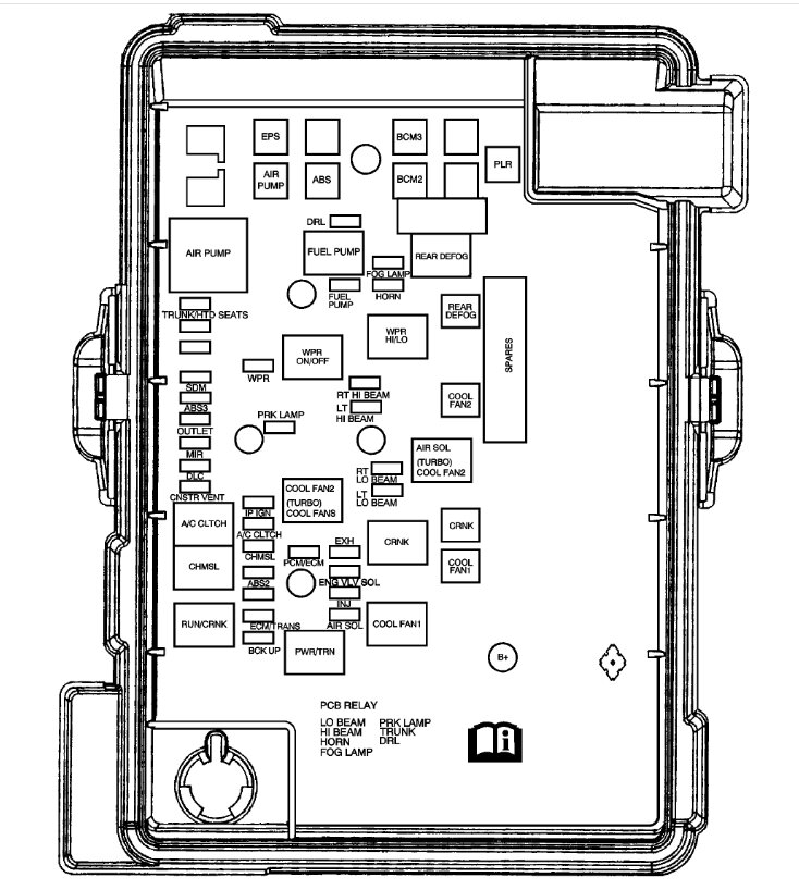

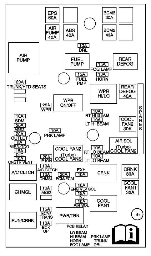

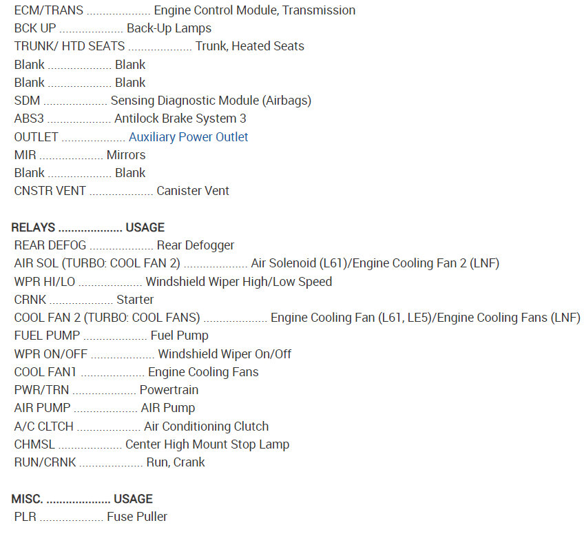

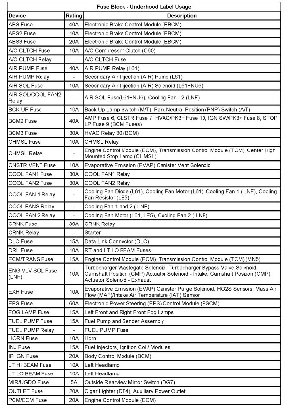

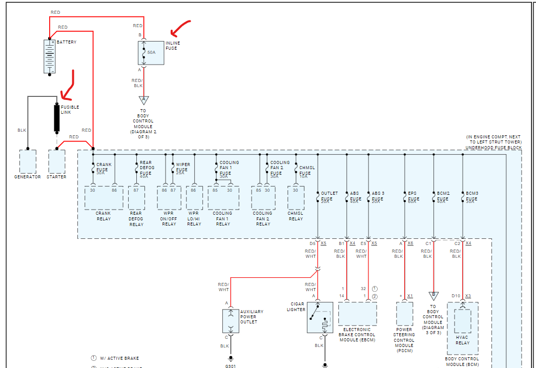

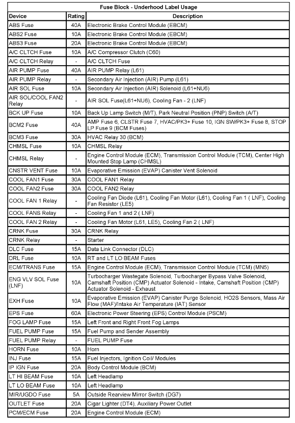

So, what stopped working, the engine not starting, or all the lights went out and the car is dead? There is a mi fusible link and a line 50-amp fuse that feeds the BCM. I would turn the key out and start checking for power across the fuses.
Here are the fuse locations and what they do, the inline fuse should be near the starter or battery, check out the images (below). Please upload pictures or videos in your response of any problems so we can see what to help you with.
