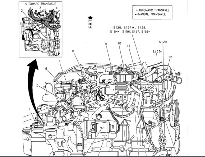

My battery was drained and when it started by jumpstart I drove it about 12 miles battery never charged was still drained. I took positive cable off battery when engine was running engine stayed on. turned headlights on they were weak and drove it after I put pins cable back on battery. Lights stayed dim and battery didn't charge at all. have a radiator leak when hot with belts on but alternator belt feel a bit loose spouts coolant out from steam and steams engine. have radiator ordered just replaced water pump no more leaking from that. New belts but alt belt feels a little loose. Couldn't get the screws off the thermostat housing to replace with new one. What's making battery not charge?

Good morning,
First, it is never a good idea to take a battery cable off while the engine is running. It tests nothing and can damage the modules from a voltage surge.
https://www.2carpros.com/articles/how-to-charge-your-car-battery
You need a voltmeter to test the voltage at the battery. You need 12.4 to 12.6 volts for the system to work.
You may have a bad alternator as it is not maintaining the battery.
