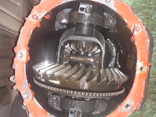

How do I adjust the side of the carrier bearings after replacing them?
HIDDEN1
  • 2001 DODGE DAKOTA
  • 6 CYL
  • 2WD
  • 180,000 MILES

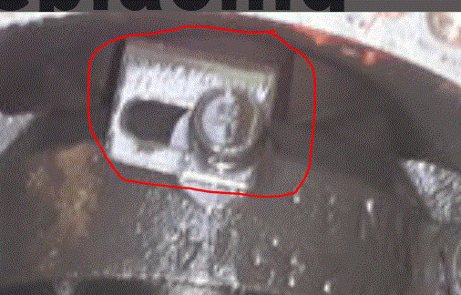

There is a lock piece on a wheel outside the bearing.
Saturday, September 11th, 2021 AT 6:26 PM
19 Replies
  • 109,913 POSTS

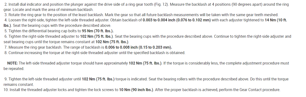

There is a special tool that is used to adjust the threaded adjusters. Also, I took a portion of your pic and circled the lock. Is this the part you are referring to? If it is, then that needs to be removed to adjust the bearings and then reinstalled once the adjustment is complete.

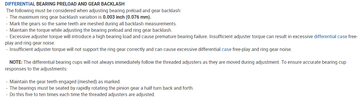

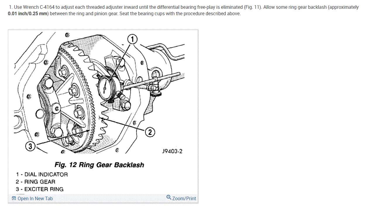

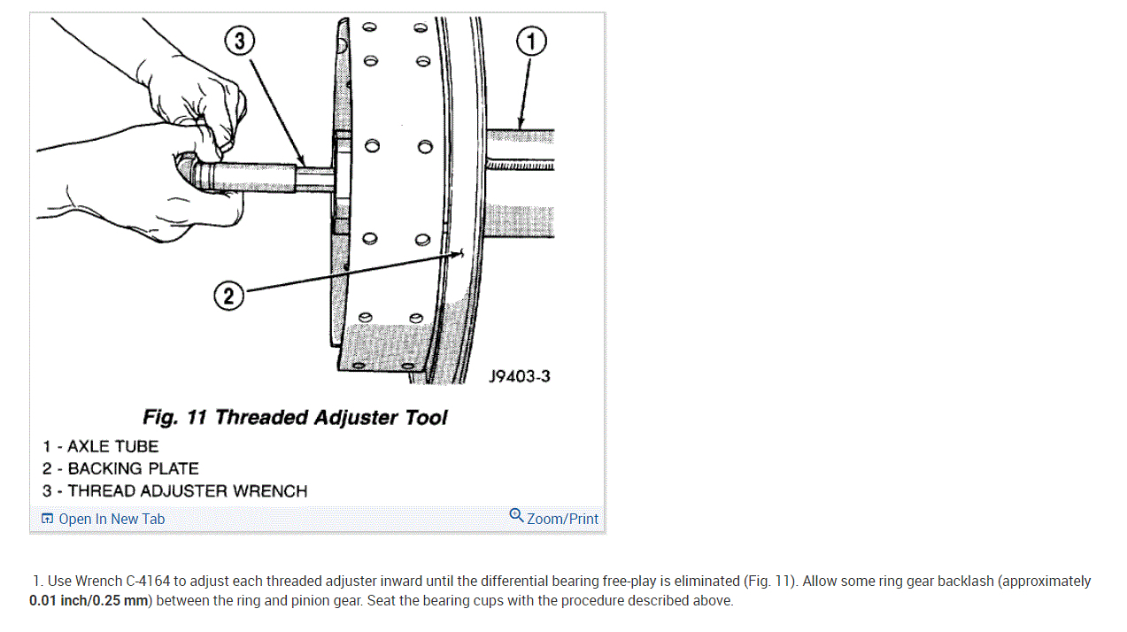

Keep in mind, when adjusting the carrier bearing, it correlates directly with the pinion gear. That is where the actual adjustment occurs. The carrier bearings simply move the ring gear assembly left and right. The tool will be inserted from the end of the axle, travel through the axle, and then go into ring gear assembly. Once installed, then the free play has to be adjusted within a specified tolerance.
Now, if you look at the pics below, they explain how the adjustment is done. Take a look through them and let me know if you have questions.
Pic 1 below is from your original pics. The remaining pics are the directions for adjustment. Note: Most of these trucks came with a 9.25 differential. If you have an 8.25", let me know. These directions are for the 9.25".
Take care and let me know if you have questions.

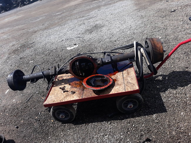

Got 8.25.
I am putting a used rear end in an wanted to know what to test an look at before bolting to driveshaft.
 It is identical to mine.
Is there a turn test with front pinion?
An how can I tell if front pinion bearings went bad on old one?
Anything else before I install an test the used one?

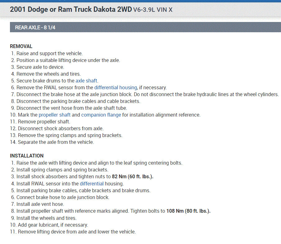

If there is a pinion-bearing issue, you should feel it when turning the pinion shaft. It will have a rough feeling about it. Also, a bad bearing usually causes a leak at the seal and makes a howling noise when moving.
Next, check for excessive end play at the axles. A small amount is normal, but it shouldn't be excessive.
I attached directions for removal and replacement. Let me know if this helps.
See pic below.

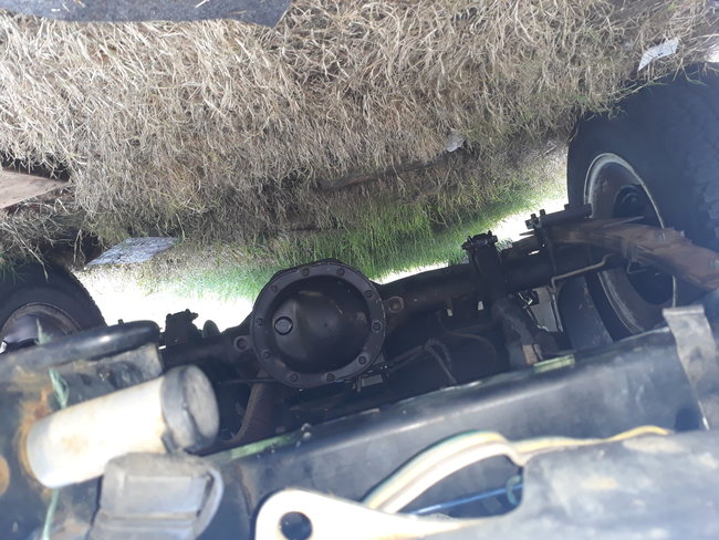

I'm not sure the mark on driveshaft to new rear will line perfect but I have it in neutral as I line up 4 bolts.
The rear I got was still in drive. Will that factor anything? It has been turned in both directions to be sure it's not LSD.
I don't see a problem as long as the shaft it in neutral when installing. It will either turn one way or the other if not in neutral.

Yes, I got it lined up.
Of course the shaft was in neutral.
I added fluid an turned shaft a bit an tightened the 4 bolts an used Loctite.
Seems to turn okay.
Anything to look at before starting it an testing it with tires in air?
I need to see if outer seals/bearings at axle ends feel tight also.
I hope the front pinion an carrier bearings are smooth.

Good job. I'm glad it's back together and working for you. By the way, looking at the pic above, you do good work. It looks really good.
