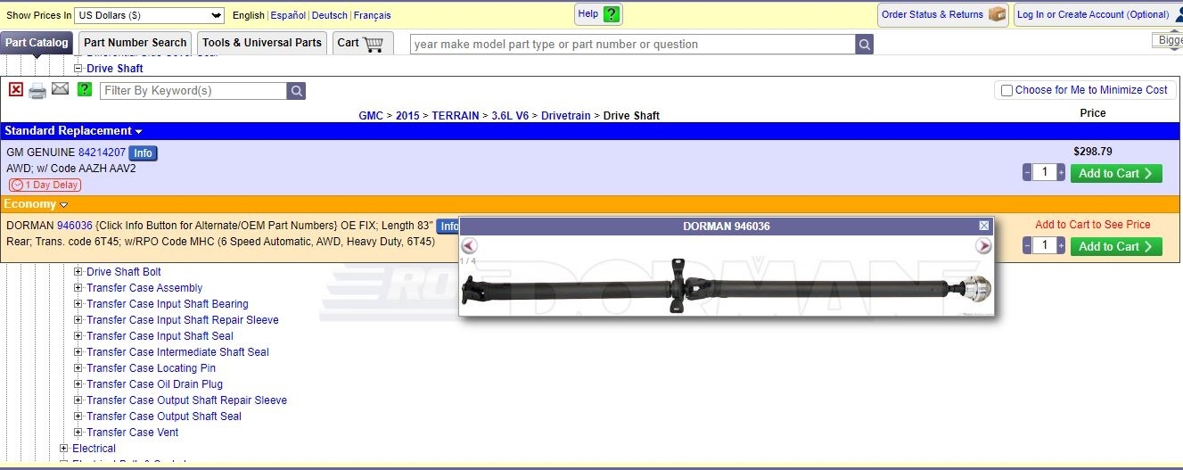

Little over 1/4 inch of movement. Also having slight vibration at speed. Do you have the part number for just the center support/carrier bearing? All I have found online is the whole driveshaft kit that is over $300.00.

There is no part number for the center support as it is part of the driveshaft. It is not like the older versions where it is serviced separately.

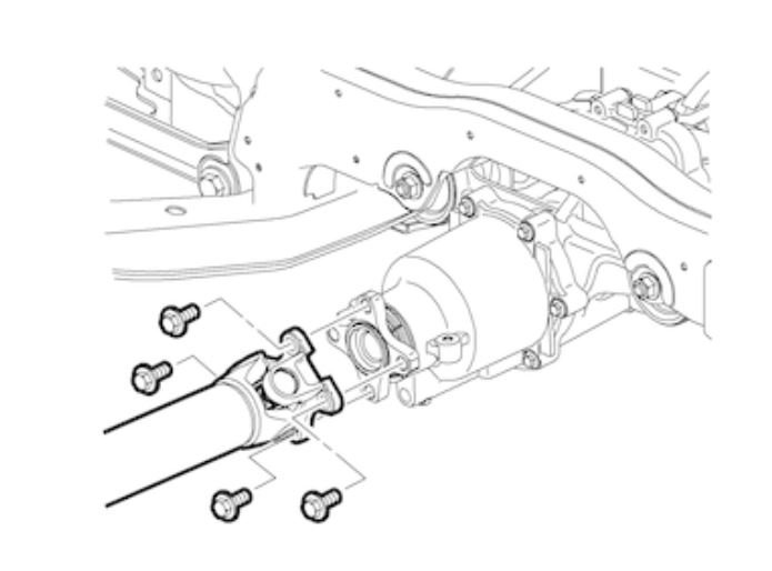

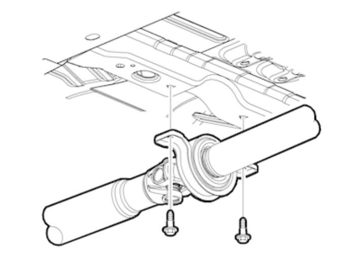

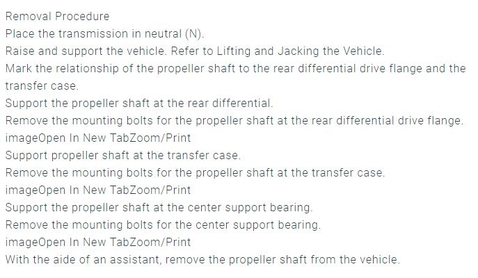

I attached the driveshaft available from Rock Auto for you and the procedure for replacement.
