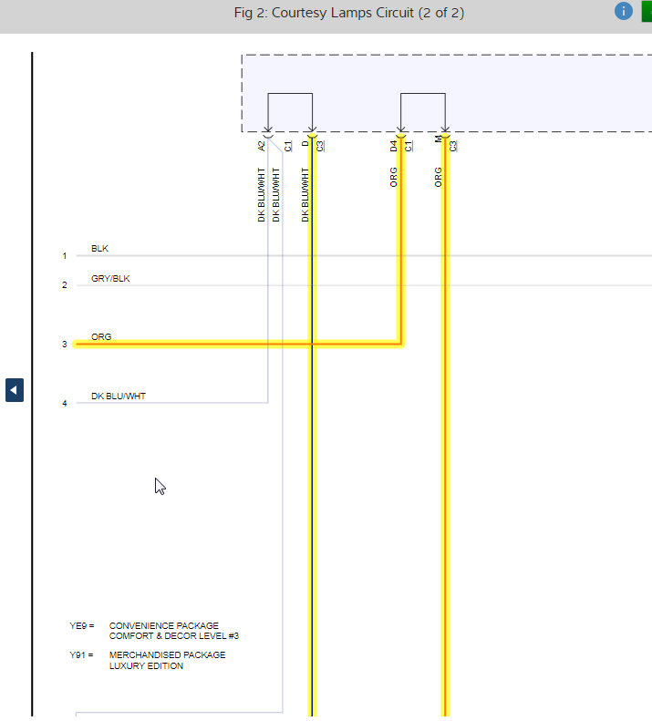

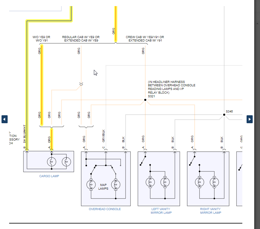

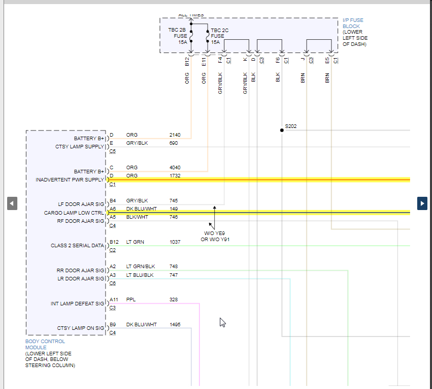

Sir, I cannot locate the fuse for the cargo light.
Feb 26, 2021 at 6:13 AM
The cargo light on this vehicle does not have a fuse. It is controlled by the BCM which supplies its power and grounds the circuit so a circuit protector (fuse) is not needed.
Please take a look at the wiring diagram below for more information. I assume the bulb is not working. So have you checked power and ground when the light is turned on?
If not let's start with this and if you have no power then we may have a switch issue or BCM issue.
Let us know if you have questions. Thanks
