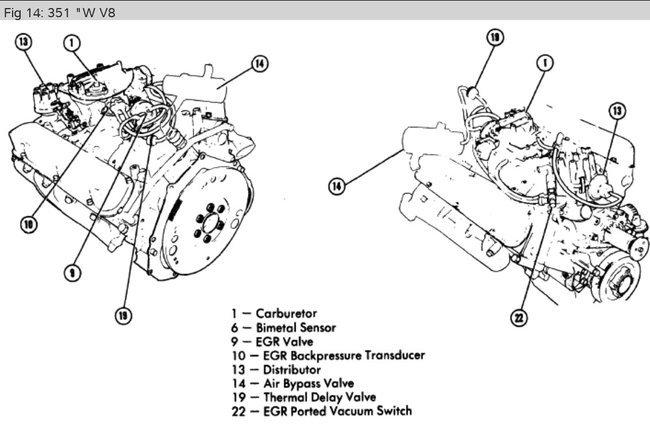

I am switching from a Holley 2300 2BBL carburetor to a re-manufacturer of the original Motorcraft 2150. Since I can't find a book for the van or anything online about vacuum routing, I am asking here.
Yes, I know its a backward swap, but the Holley isn't working.
I have to find out where all the vacuum lines need to be routed. Of course there wouldn't be instructions in the box. Please help!!

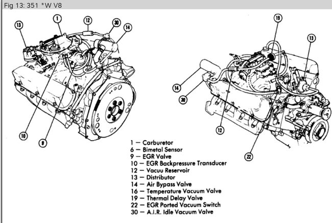

there are 2 different ones , one with an air pump the other without it depends on GVW see pics
