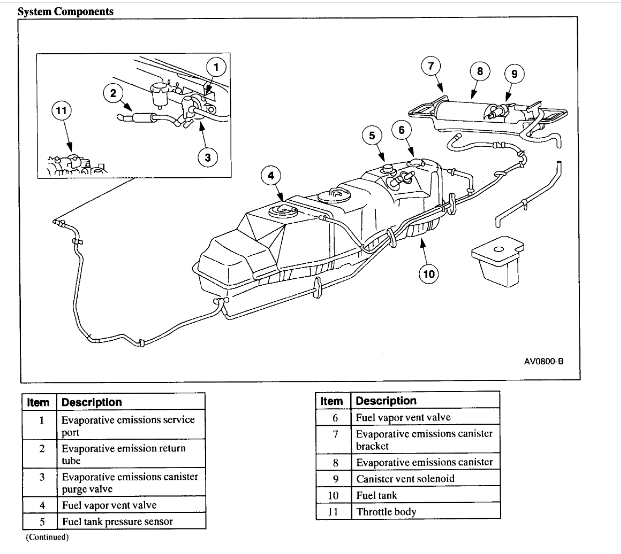

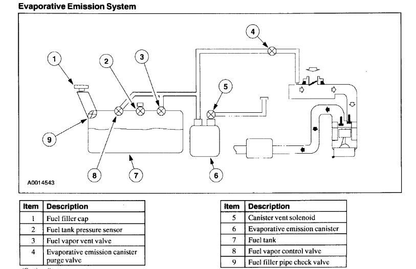

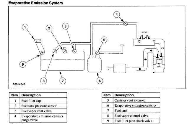

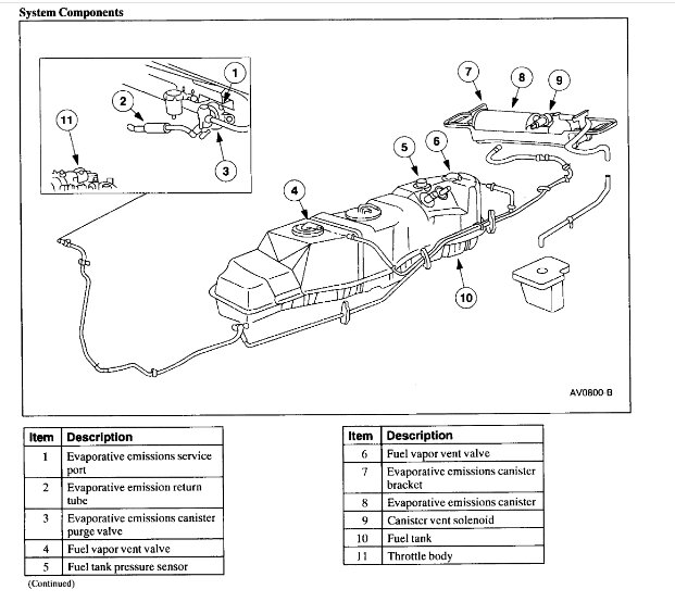

Carbon cannister line?
2001 FORD F-150
219,000 MILES • 5.4L • 4WD • AUTOMATIC
SLKSHOE1700
Lines information connection to cannister on drivers side frame location
Aug 20, 2026 at 4:08 PM
  • 110,241 POSTS
Hi:
It sounds like you have your hands full. As far as the canister, I don't have any specifics on just it, but I was able to find two pics that should be helpful.
If you look below, I attached pics of the EVAP system. The pics show where and to what each line goes.
Take a look and let me know if it helps.
See pics below
