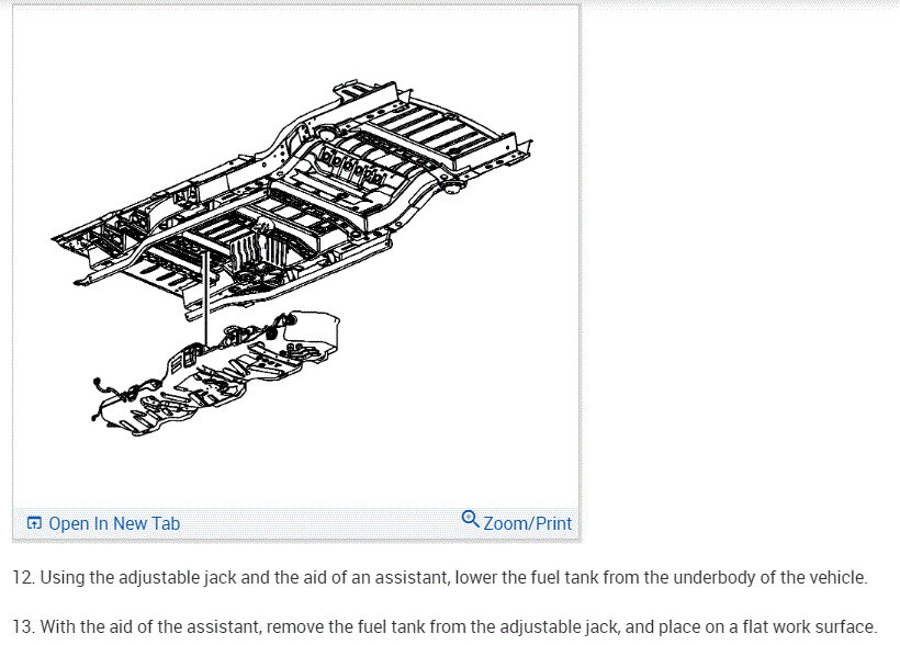

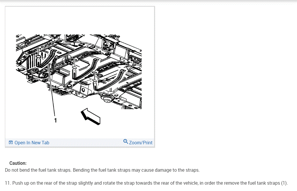

Need to know where the carbon canister is located and how to replace it.
Jul 5, 2022 at 4:10 AM
  • 110,241 POSTS

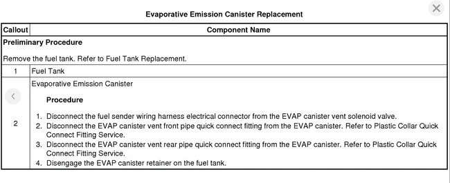

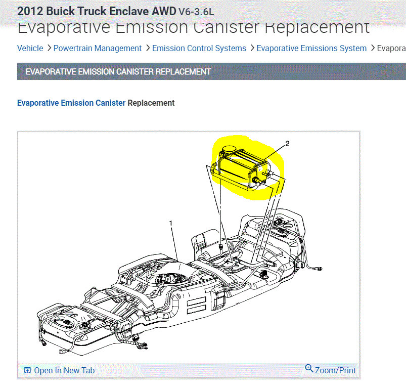

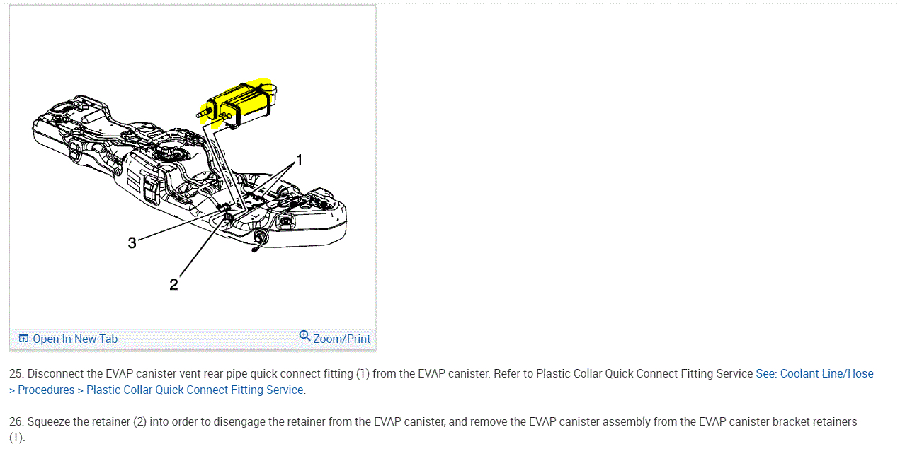

The canister is located on top of the fuel tank. Replacement requires the removal of the fuel tank.

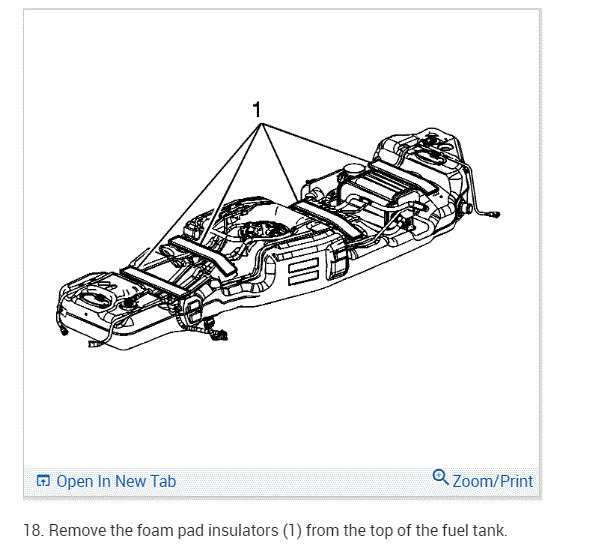

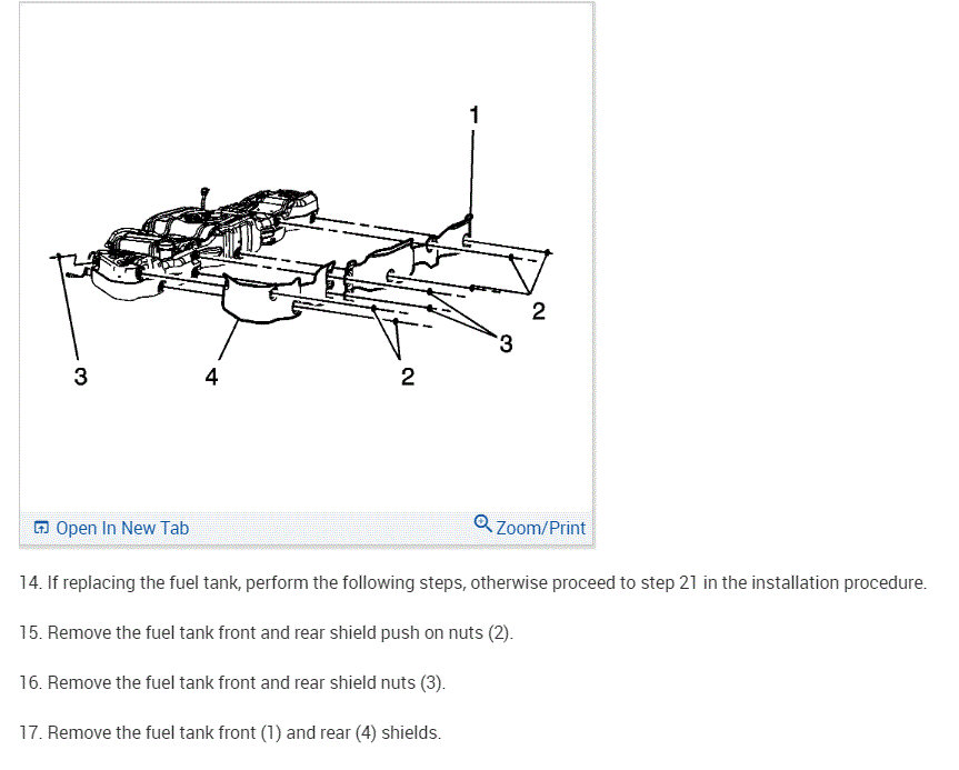

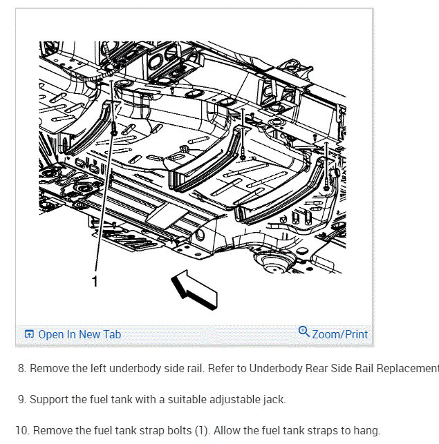

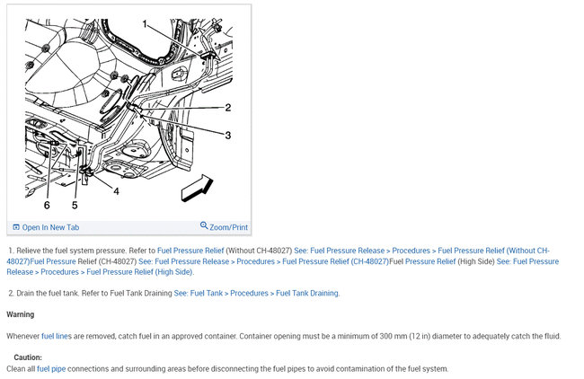

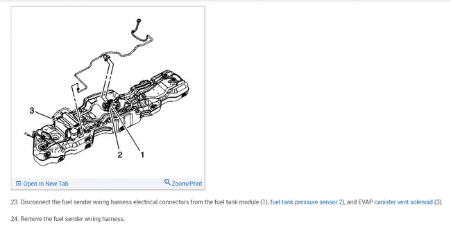

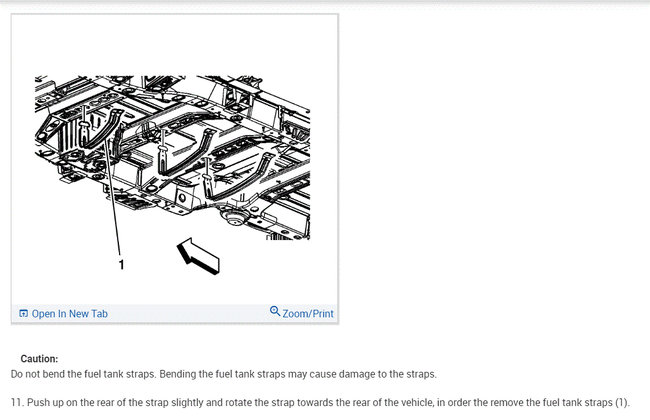

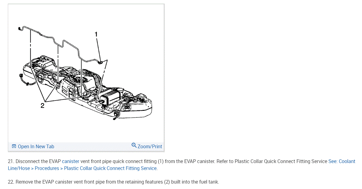

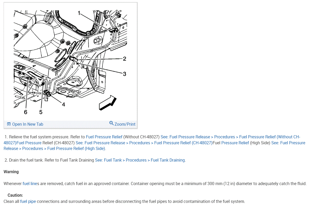

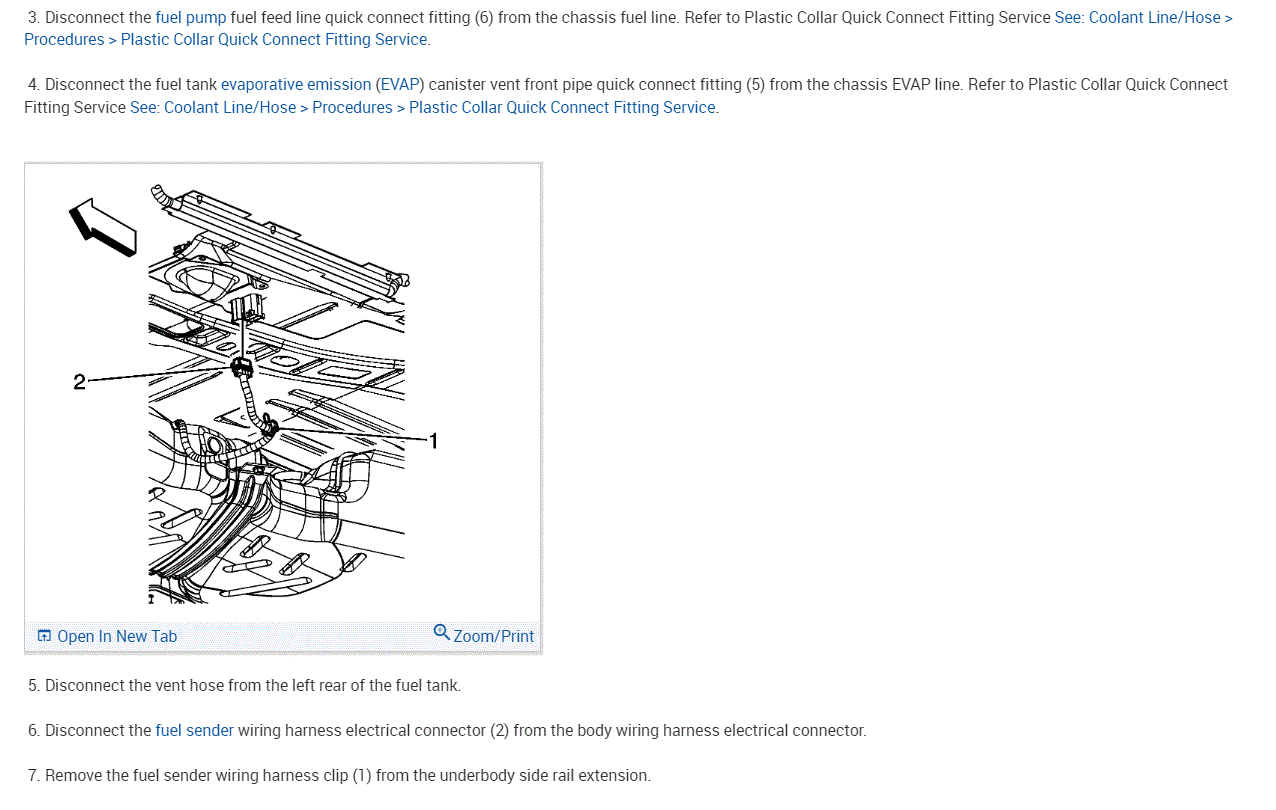

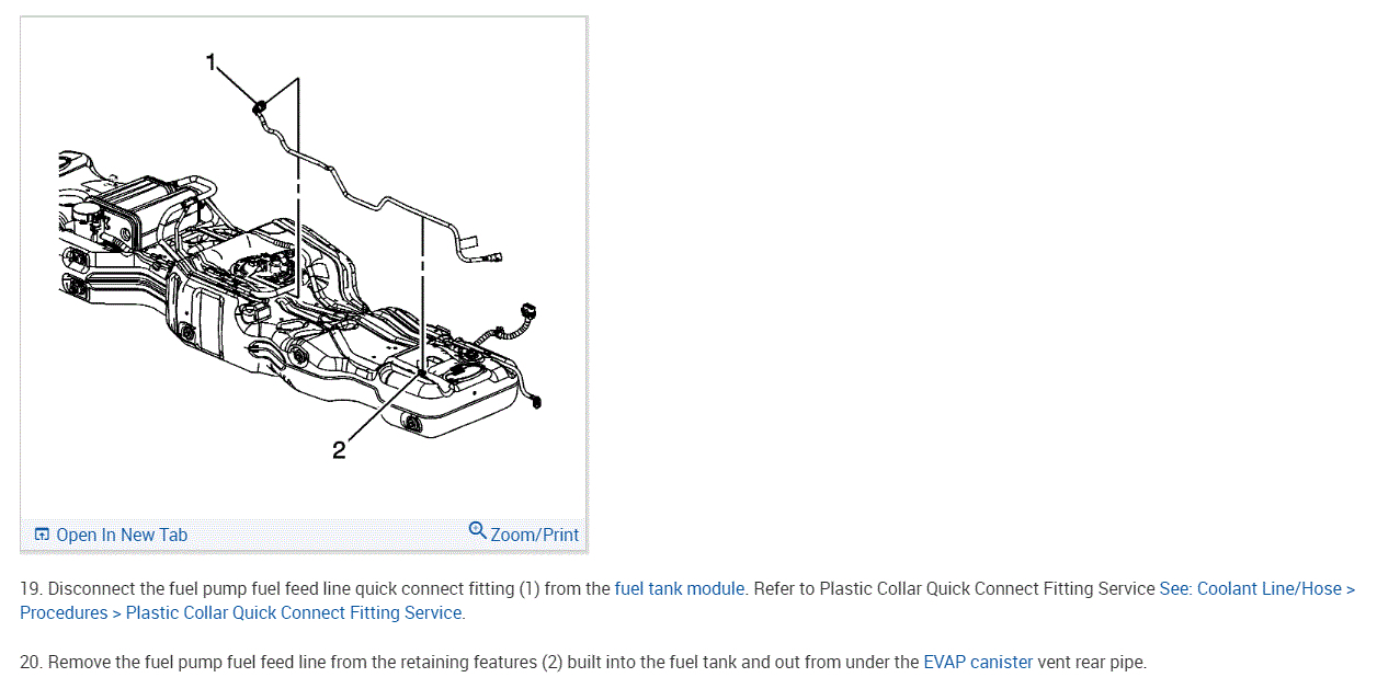

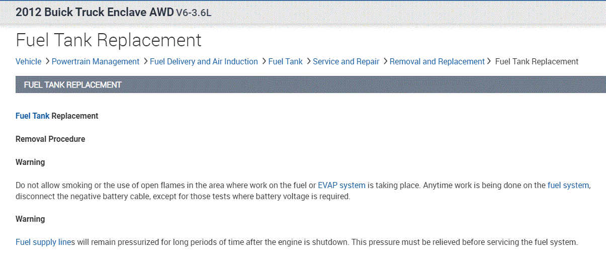

If you look at pic 1 below, I highlighted the carbon canister. Pic 2 are the directions for replacing it after the tank is removed. The remaining pics are for removing and replacing the fuel tank.
Let me know if this helps. Also, replacement is the opposite of removal.
