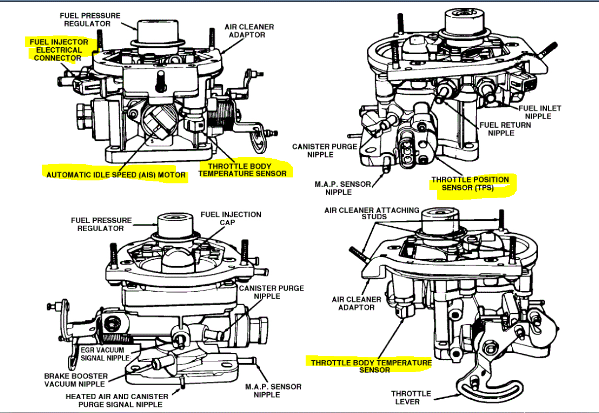

Besides the throttle position sensor, what are the other 2 sensors connected to the carburetor?
Jun 4, 2021 at 9:18 AM
  • 110,244 POSTS
On a 1995, you have the throttle position sensor, throttle body temperature sensor, and an idle speed motor. The only other electrical connection is for the fuel injection circuit.
If you take a look at the pic I attached below, it shows everything. I highlighted what I believe you are looking at on your vehicle.
See pic below.
