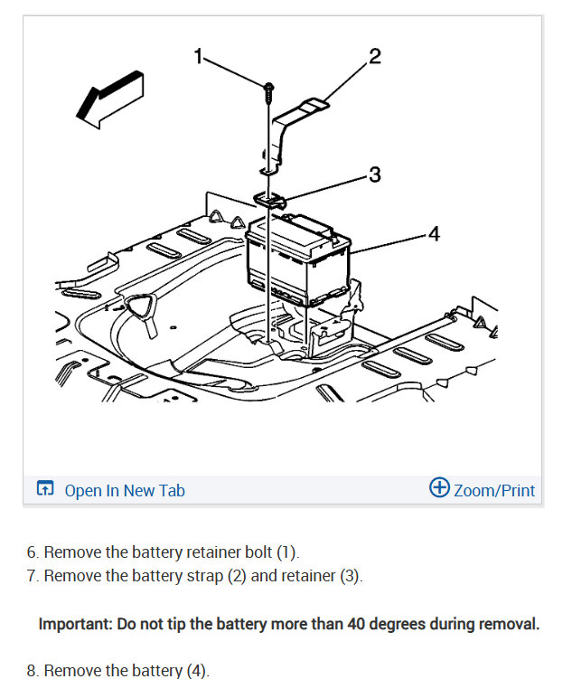

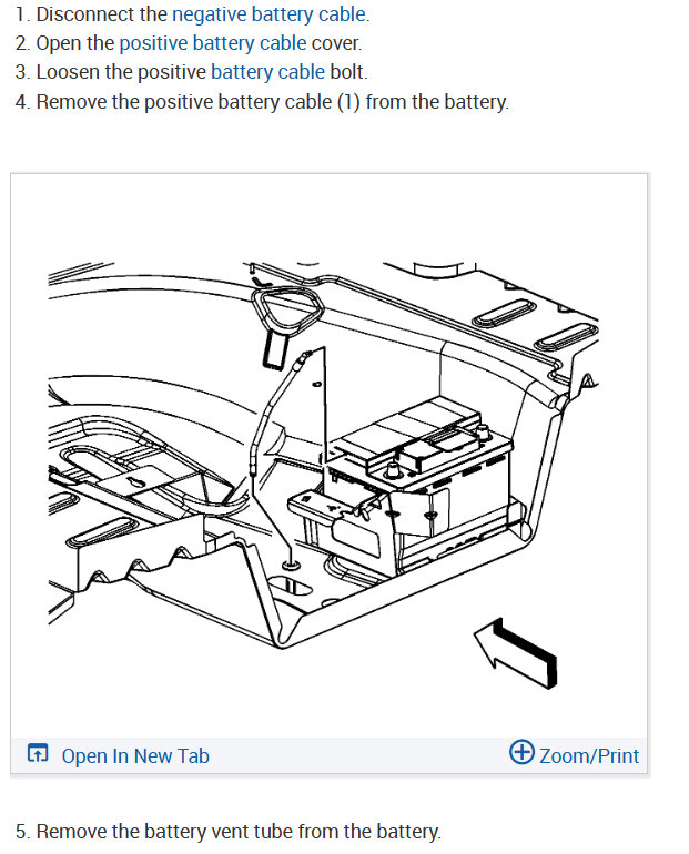

It sounds like the battery has gone bad. Here is a guide to help confirm the issue or you can remove the battery and have the auto parts store test it for you.

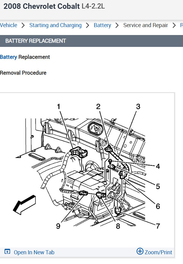

It can be a bad connection at the battery, also can you use a voltmeter to see what the standing voltage is at the battery, I have seen new batteries be defective FYI.
Please go over these two guides:
and
Please go over these guides and get back to us.
