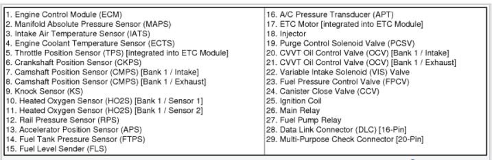

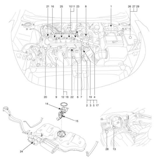

4DRTOM
  • 467 POSTS
Sorry for the delay,
Here are the locations for all the sensors for your car. Looks like number 6 is your cranks sensor and number 2 is your MAP sensor. This should get you back running again. Have you taken a better look at the starter. This sound you speak of has me concerned. If yo can make a video or recording of the start sound of the car that would help out too. If you need anything else to get this done just let me know.
