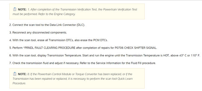

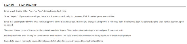

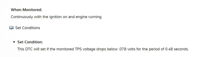

This sounds to me like your throttle body is dirty and interfering with the Throttle Position Sensor (TPS) signal to the Power-train Control Module (PCM). Without this signal the PCM has no idea how much air is entering the engine. Since there is a real possibility that the engine could go lean and blow up, the PCM goes into "limp mode" where the engine is governed and will not go faster than, in your vehicle's case, it sounds like 30 mph. I have included a few links for you down below to go to.
https://www.2carpros.com/articles/symptoms-of-low-engine-power
https://www.2carpros.com/articles/engine-has-low-power-output

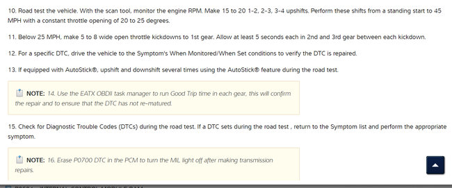

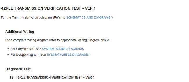

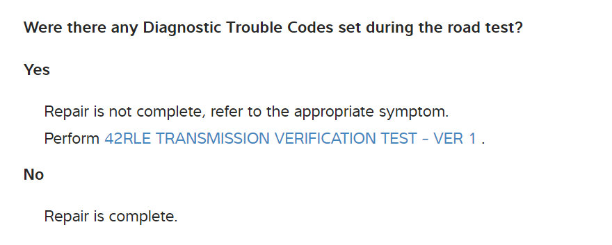

I have included the reset procedure for the transmission that must be performed after the throttle Bore cleaning to return to normal operation. Please get back to us with what you find out.
