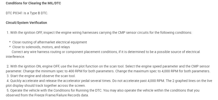

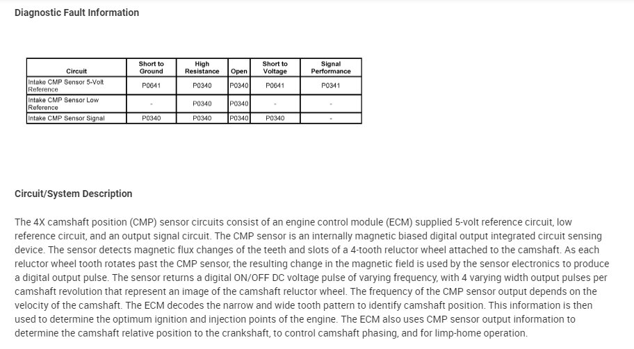

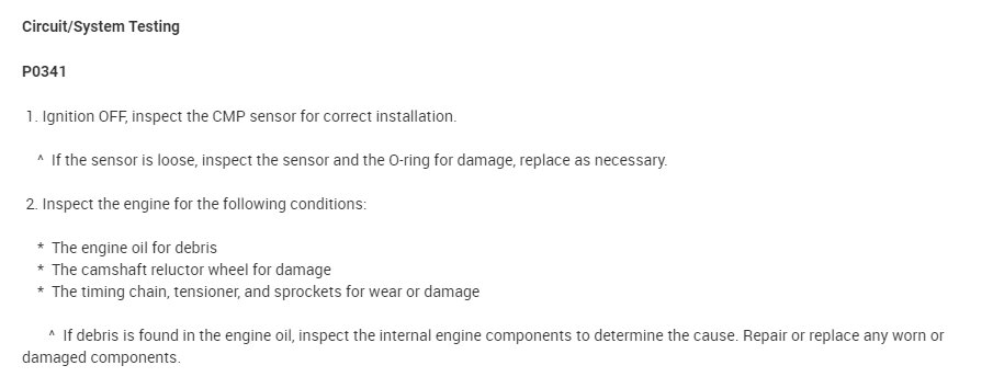

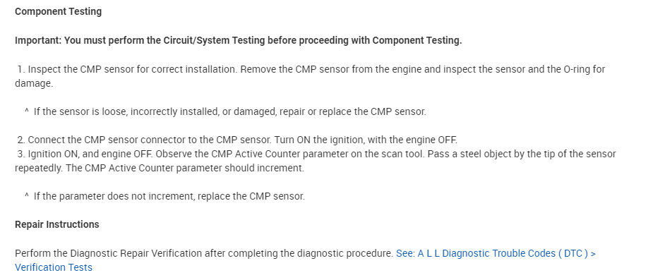

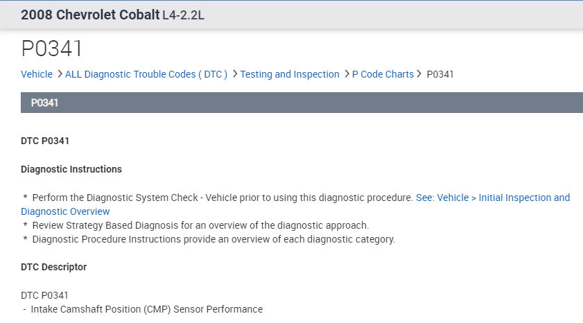

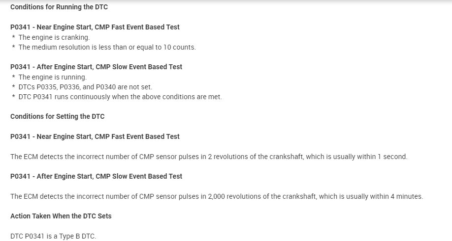

The codes that show on the obdII scanner are both the same code P0341 camshaft position sensor A Circuit Low Range / Performance Bank 1 or Sensor. Almost started but I had to give it gas to keep it alive but eventually shut off and now it won’t crank. I’m going to take out the sensor, wipe it up if need be and put it back in and erase codes and try starting it.
May 30, 2023 at 11:52 PM
  • 110,248 POSTS
I attached the diagnostics below specific to the code. It provides a description of the code and the diagnostics.
Take a look through them and let me know if you are comfortable performing them.
May 31, 2023 at 2:48 PM
