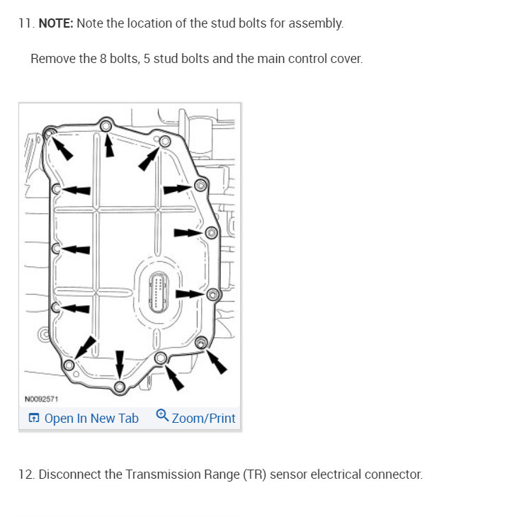

Engine does not crank?
220,000 MILES • 3.0L • V6 • 2WD • AUTOMATIC
BRIAN1205

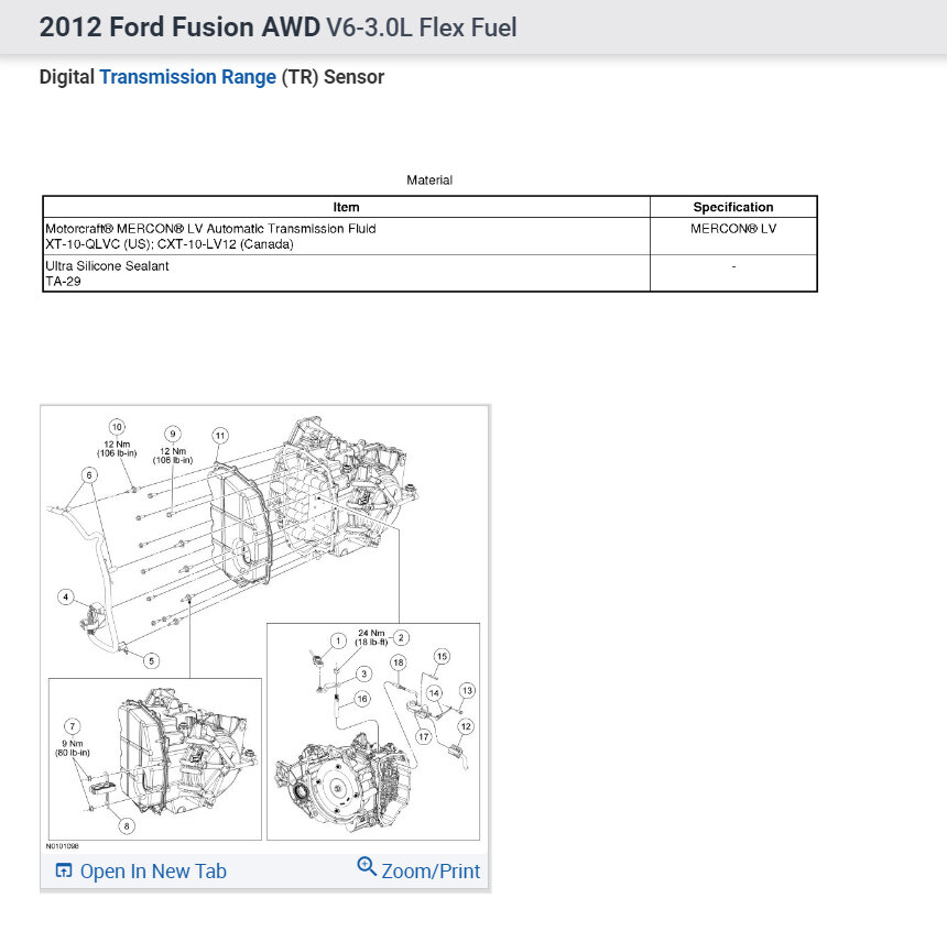

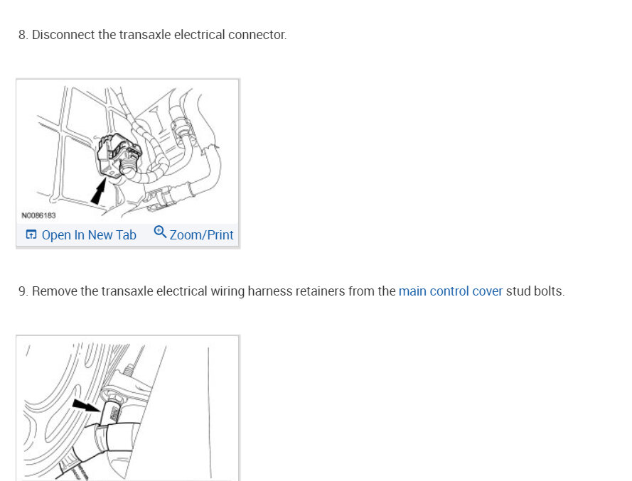

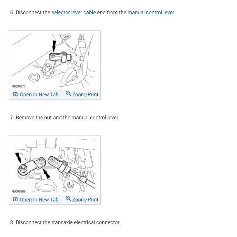

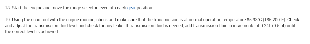

Replaced starter and neutral safety switch. Throwing code for neutral safety switch still and it won't clear.
Jan 31, 2023 at 3:36 AM
  • 55,694 POSTS

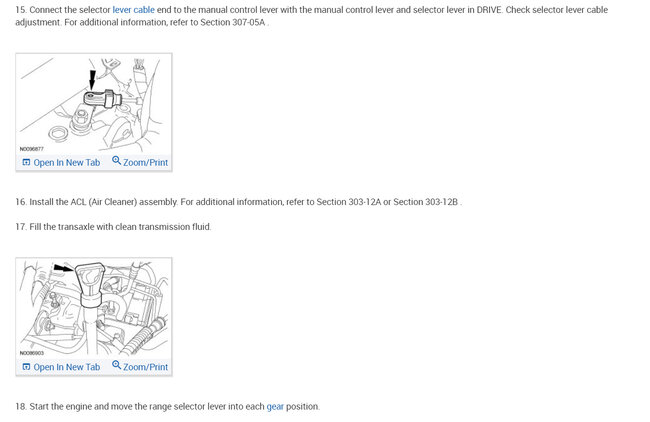

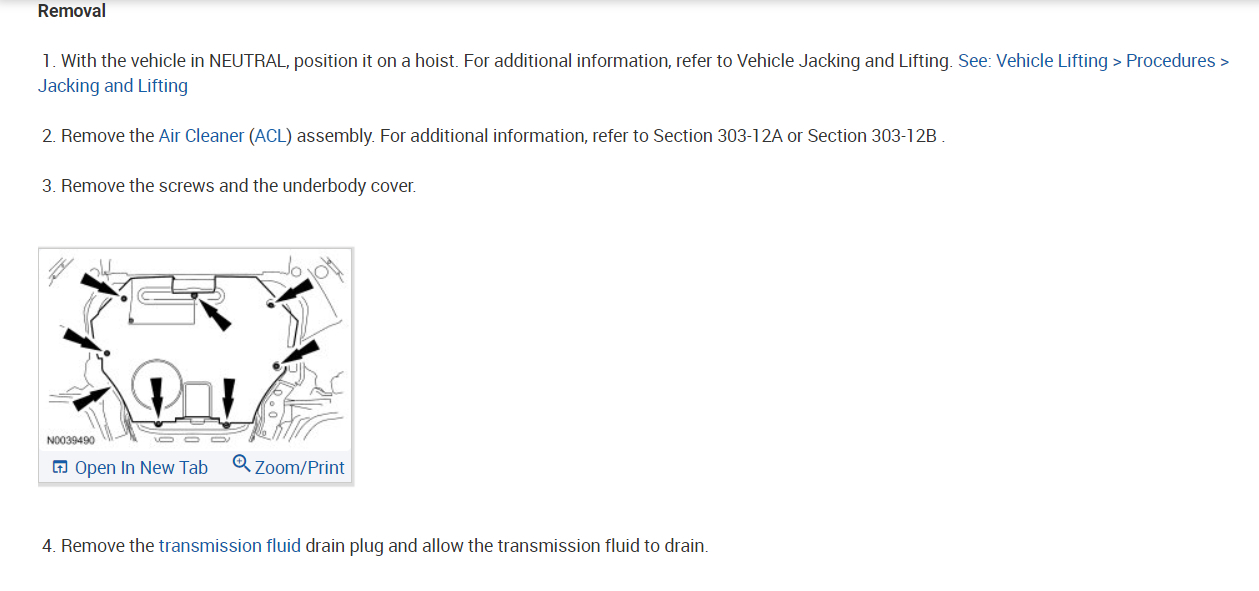

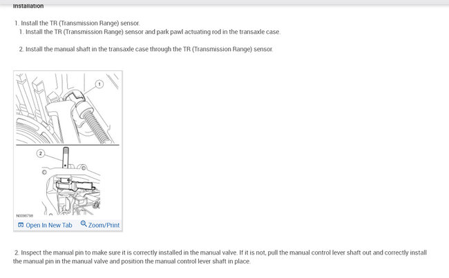

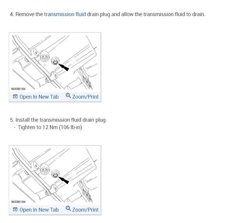

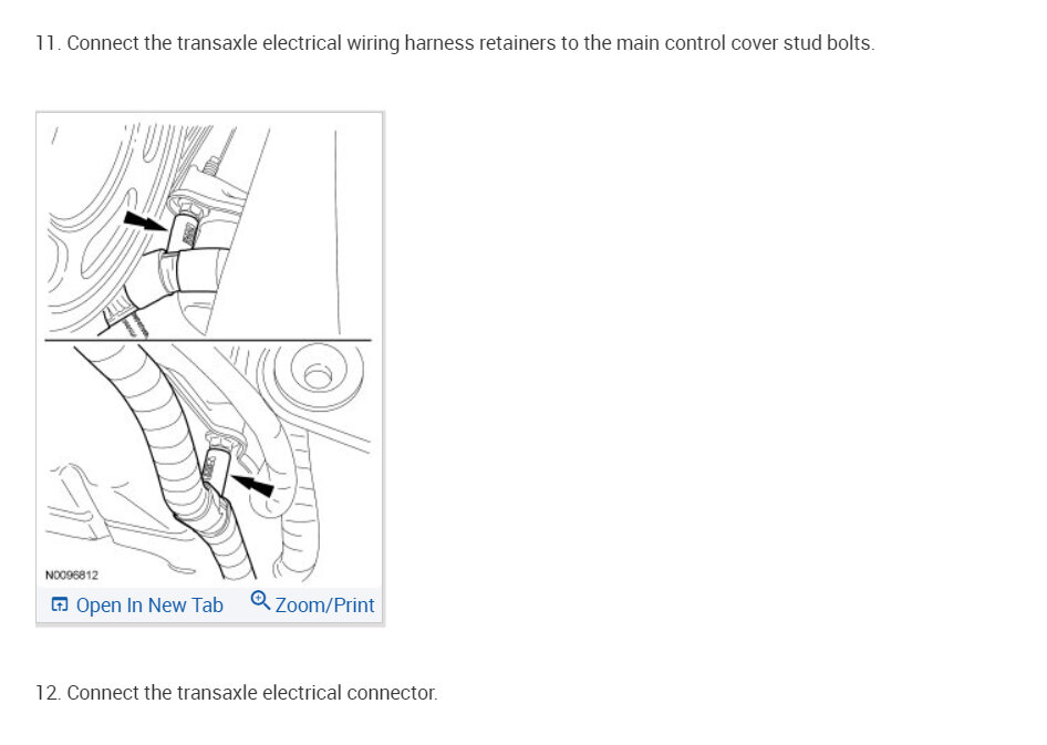

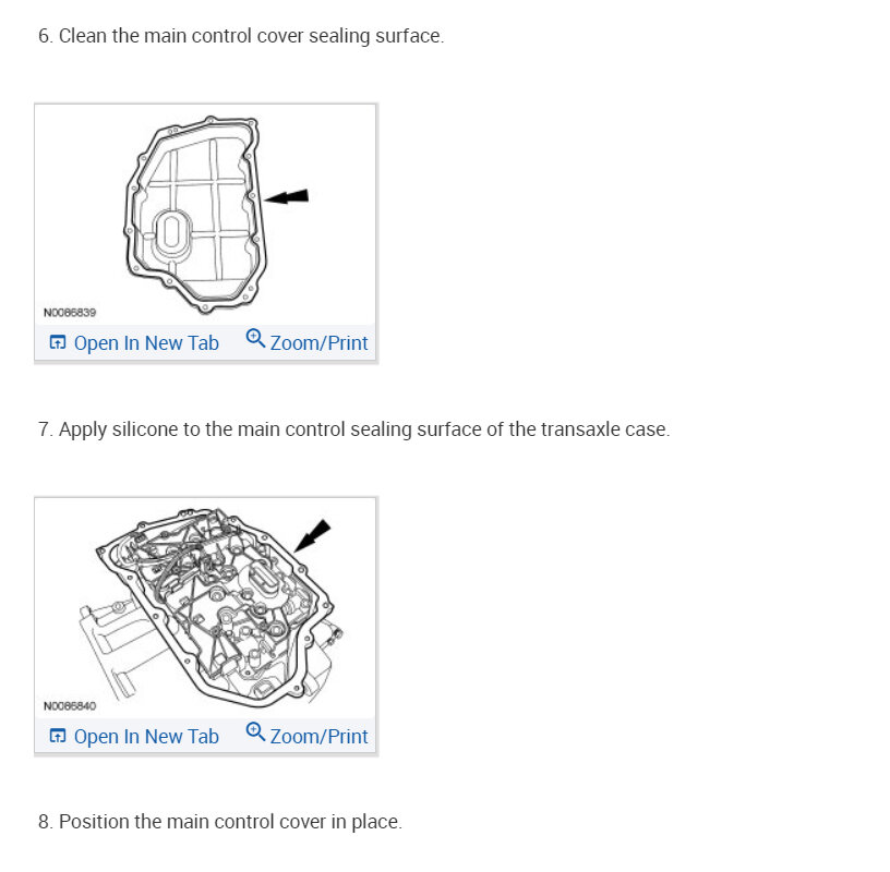

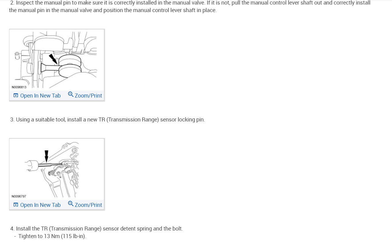

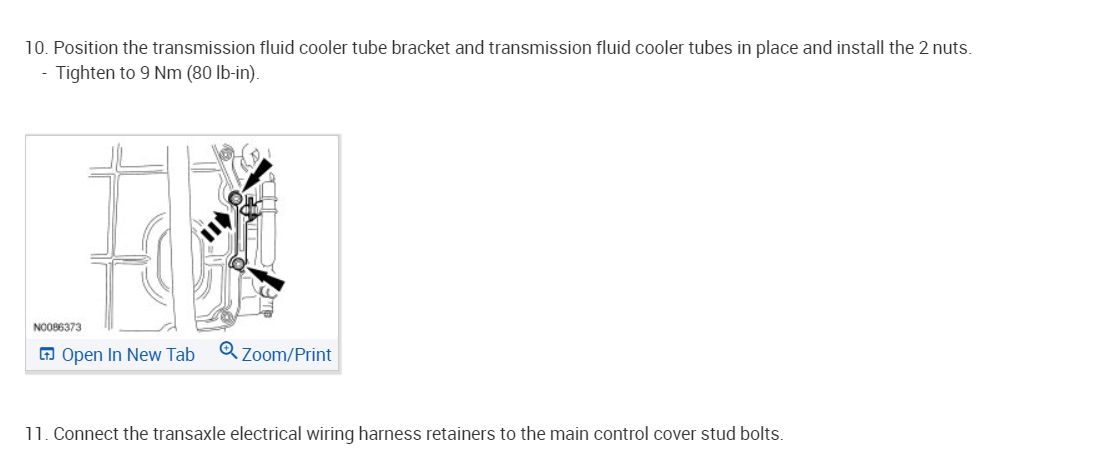

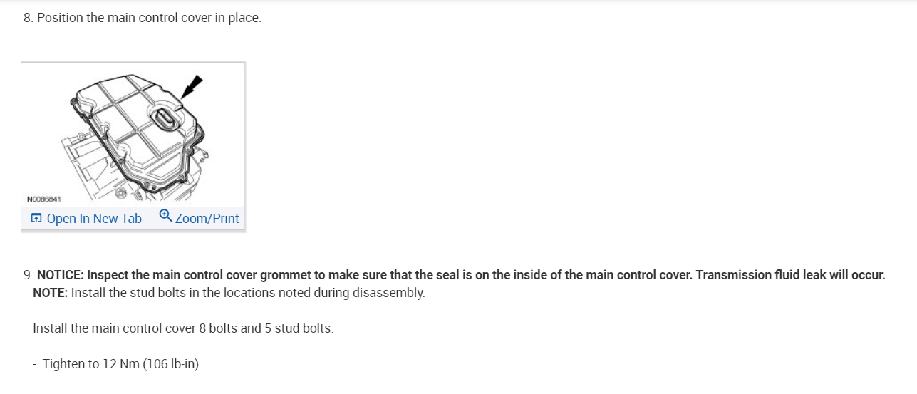

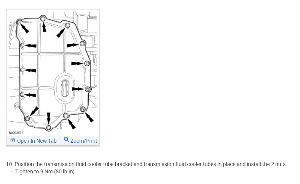

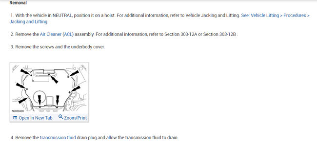

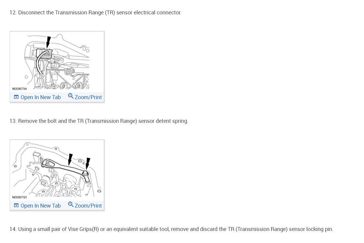

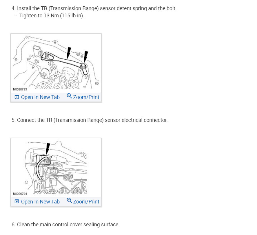

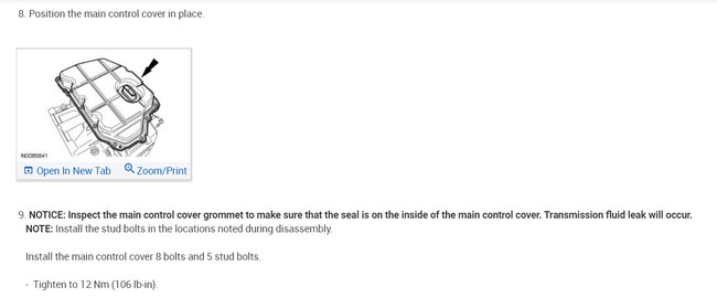

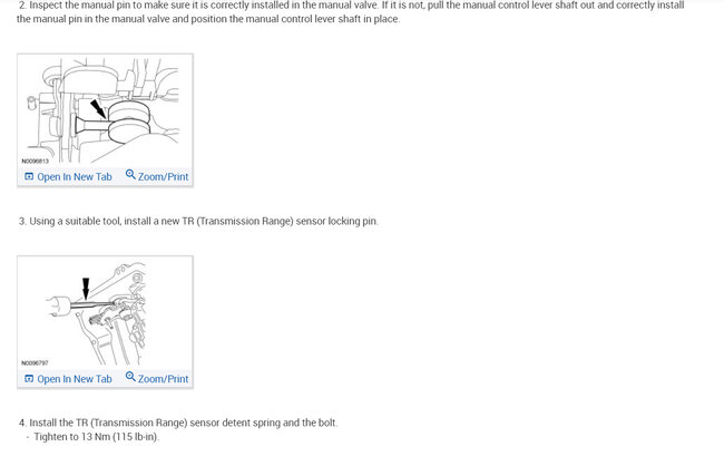

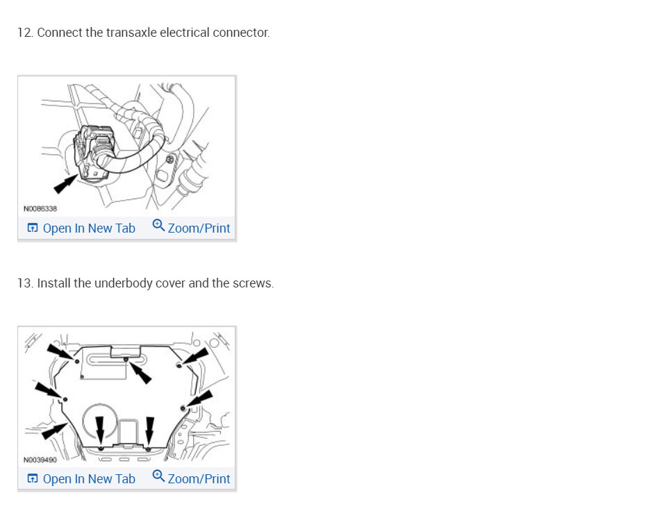

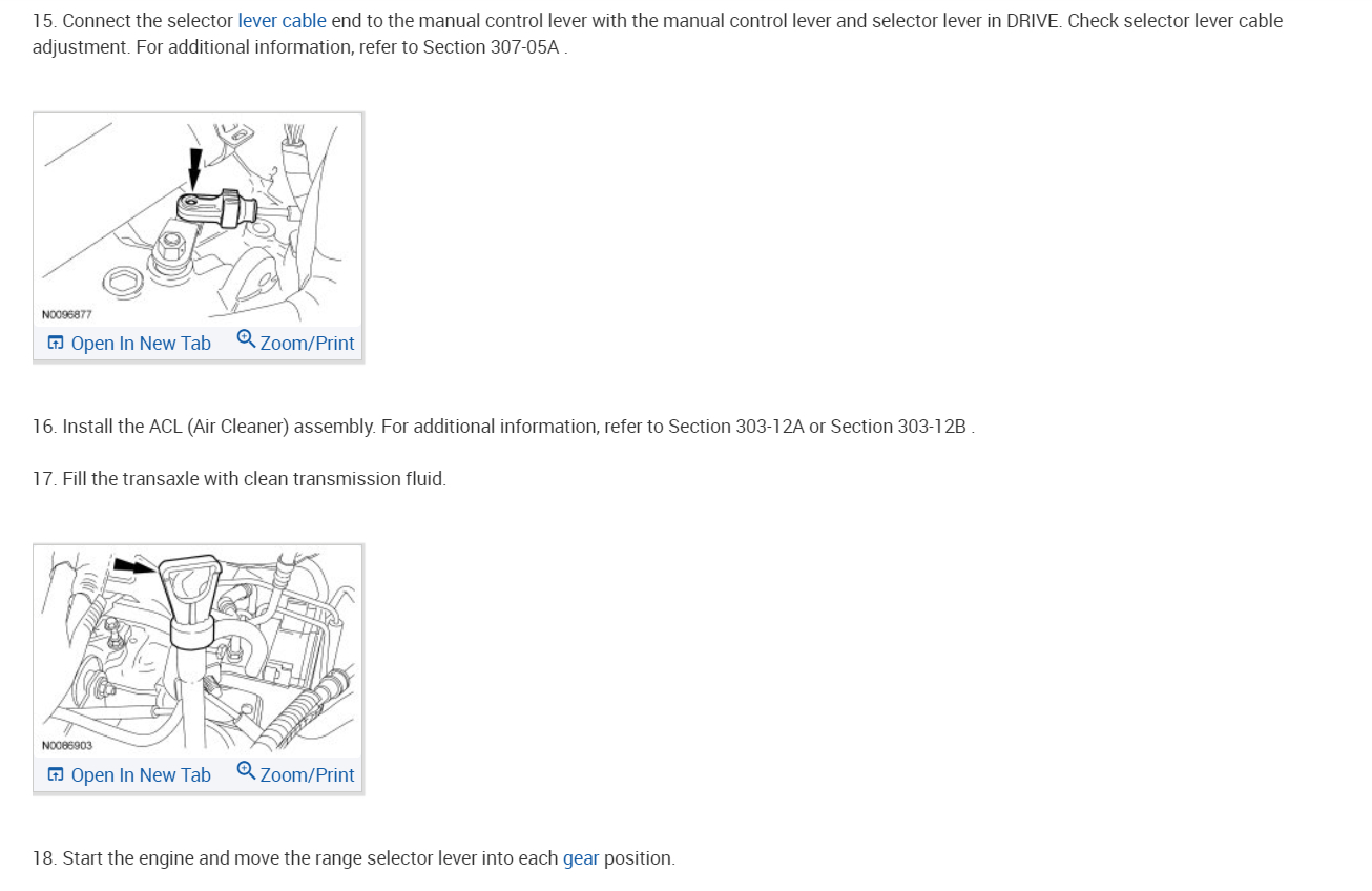

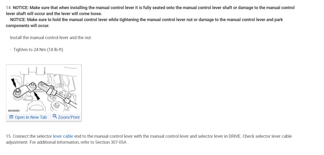

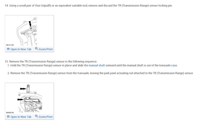

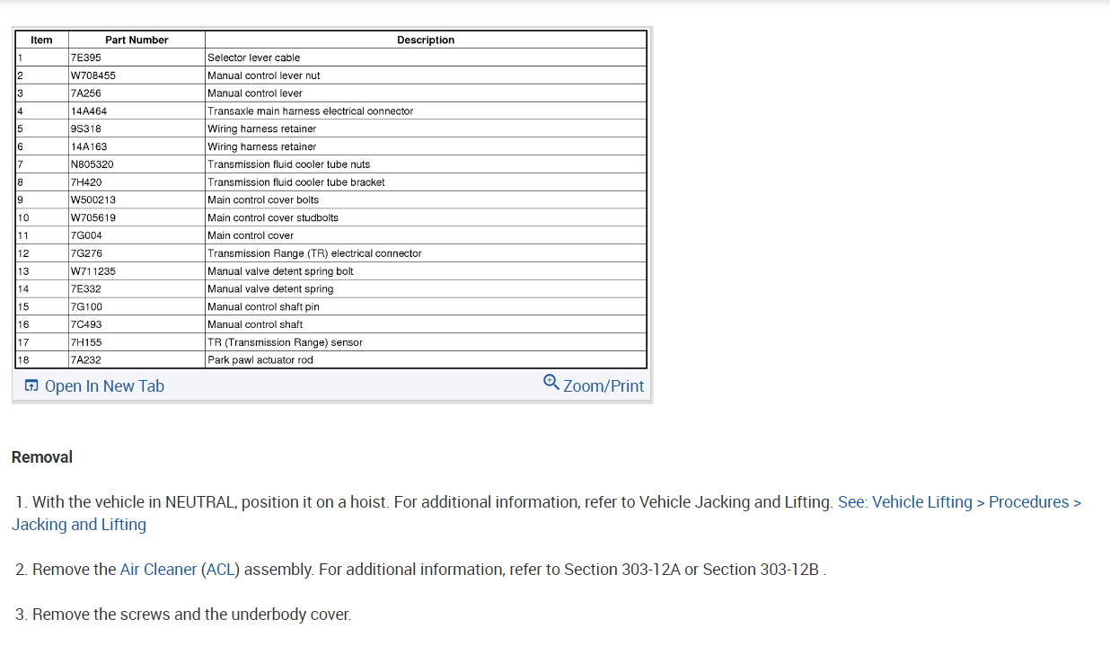

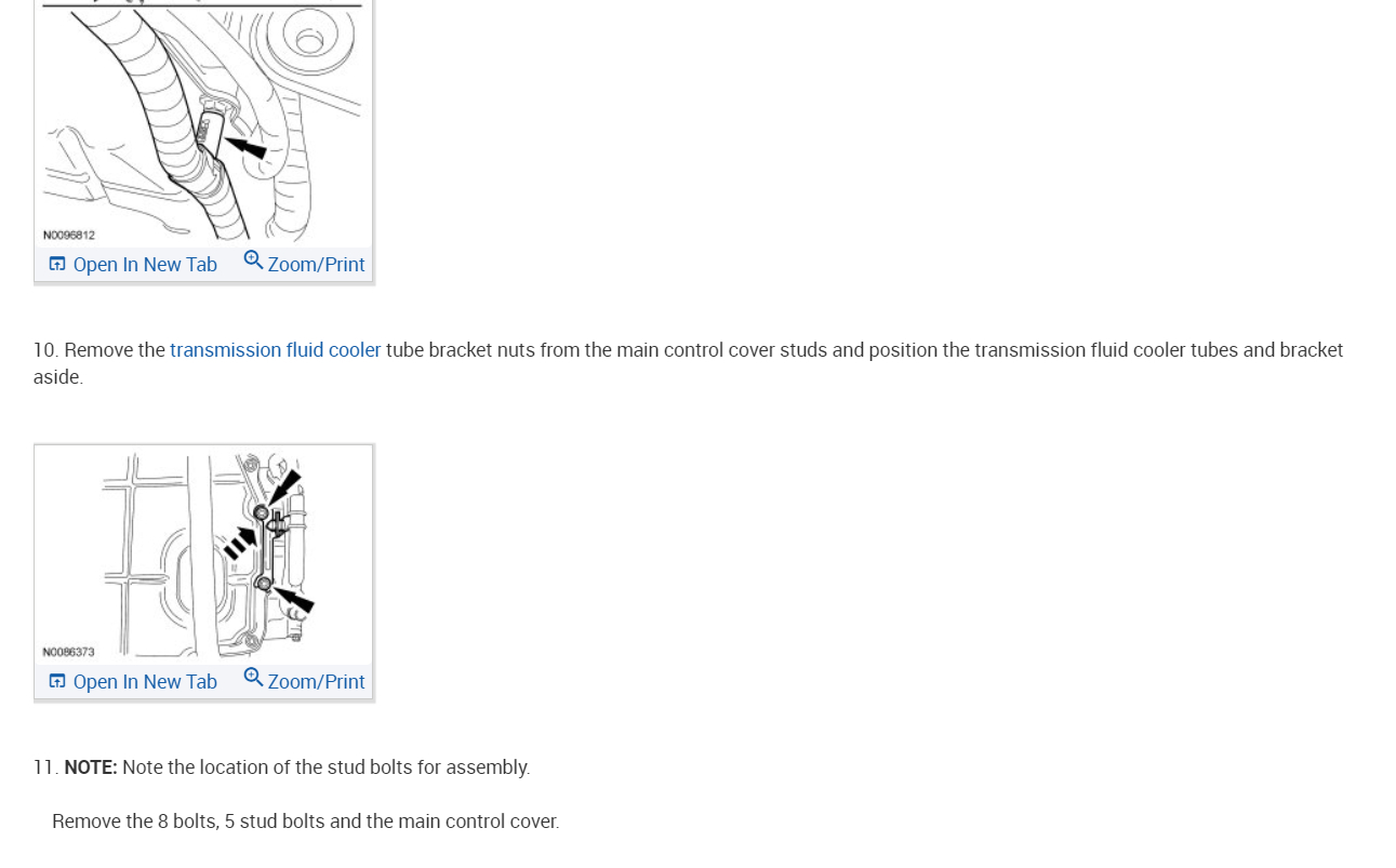

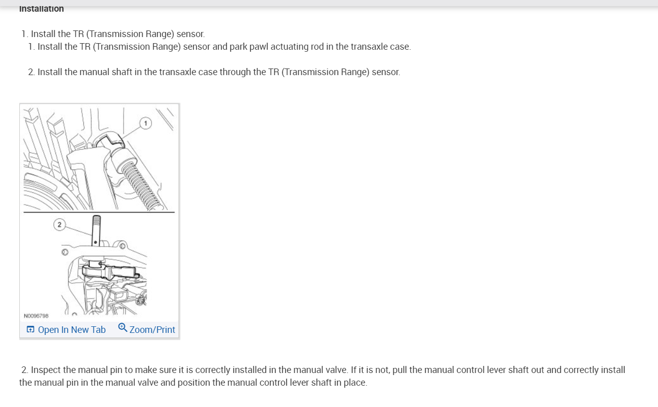

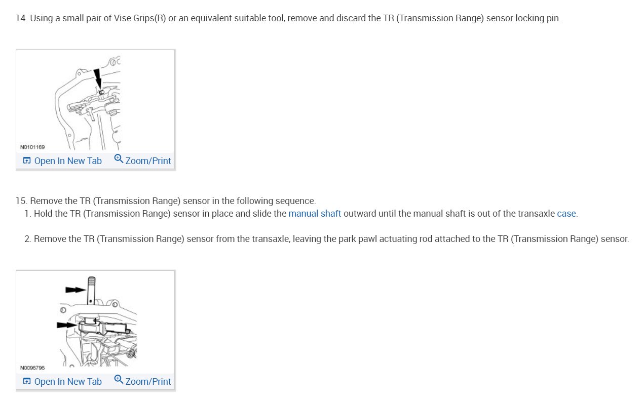

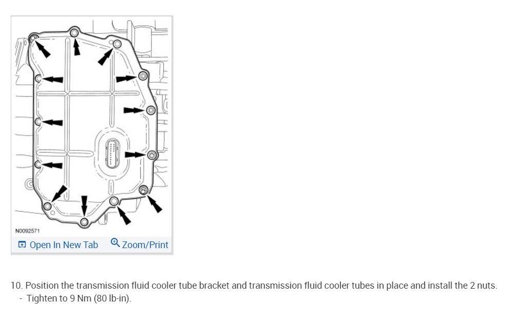

Can you tell me where the neutral safety switch is that you replaced? Replacing this sensor is involved, can you give me the exact code as well? Here is how to replace the gear range sensor for your car in the images below. Let me know please.
Jan 31, 2023 at 8:42 AM
