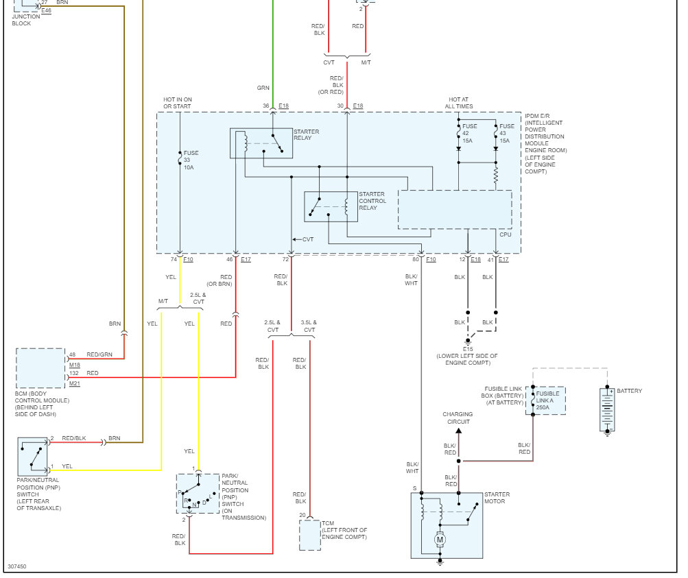

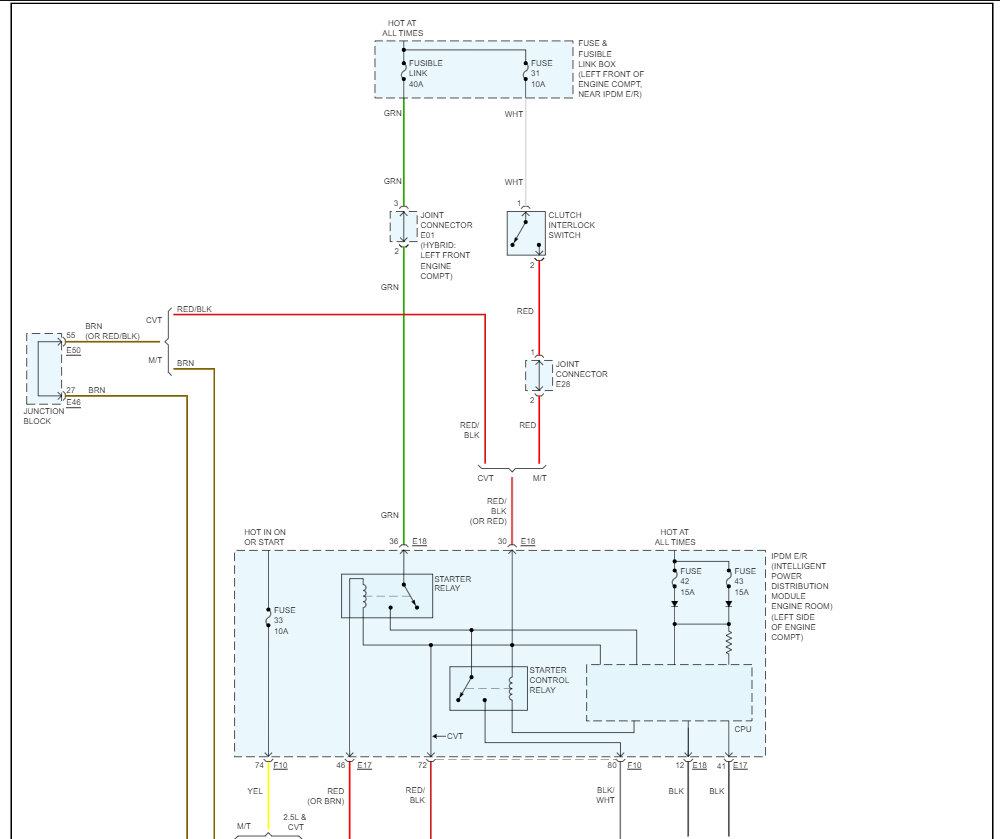

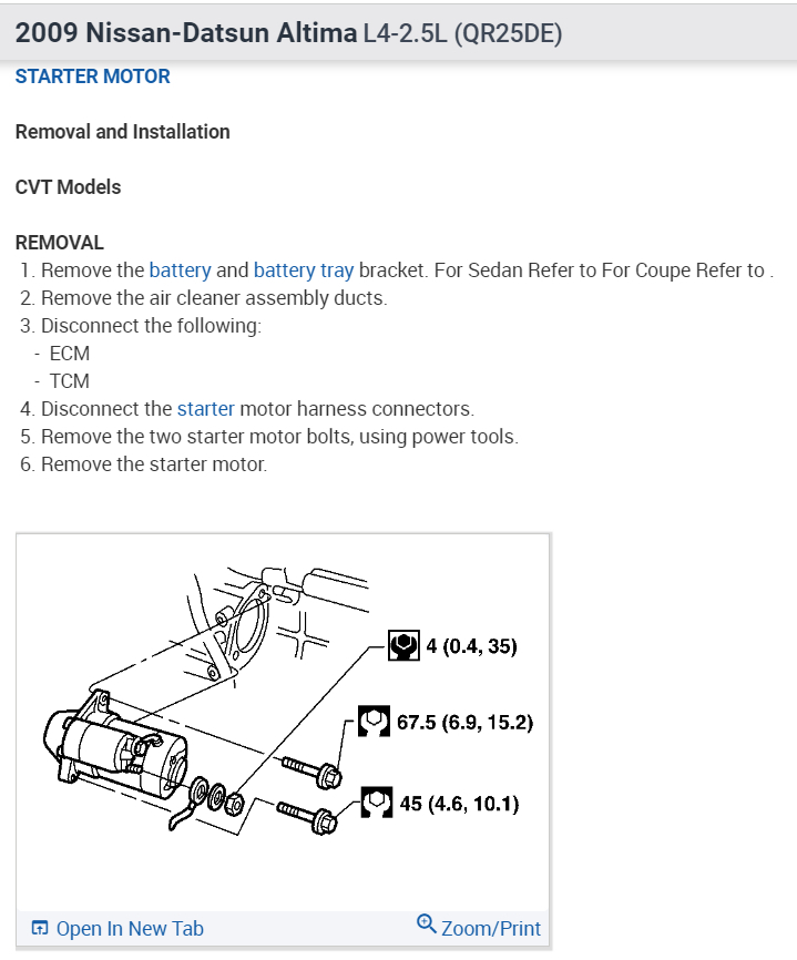

It sounds like the starter has gone bad but to be sure try to crank it over in neutral this will test the gear range sensor. We need to test if the starter trigger wire is getting power to confirm the bad starter.
This guide can help:
We should check the fuses as well. This guide will help with that and show you how the system works and which fuses to test:

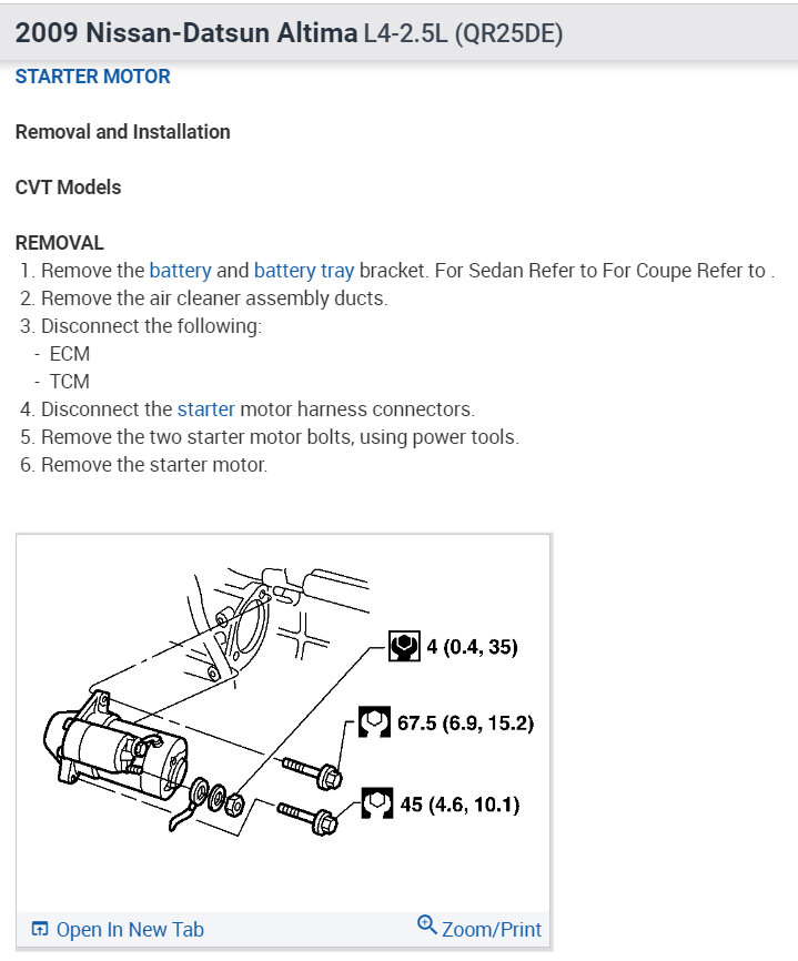

Here is how to change the starter out in case there is power at the trigger wire. Check out the images (below). Please let us know how it goes.
