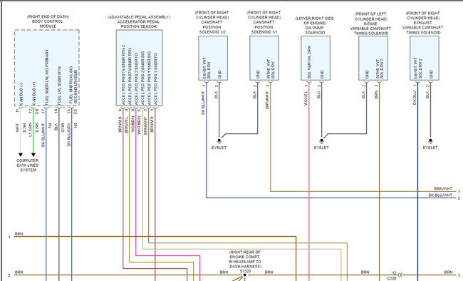

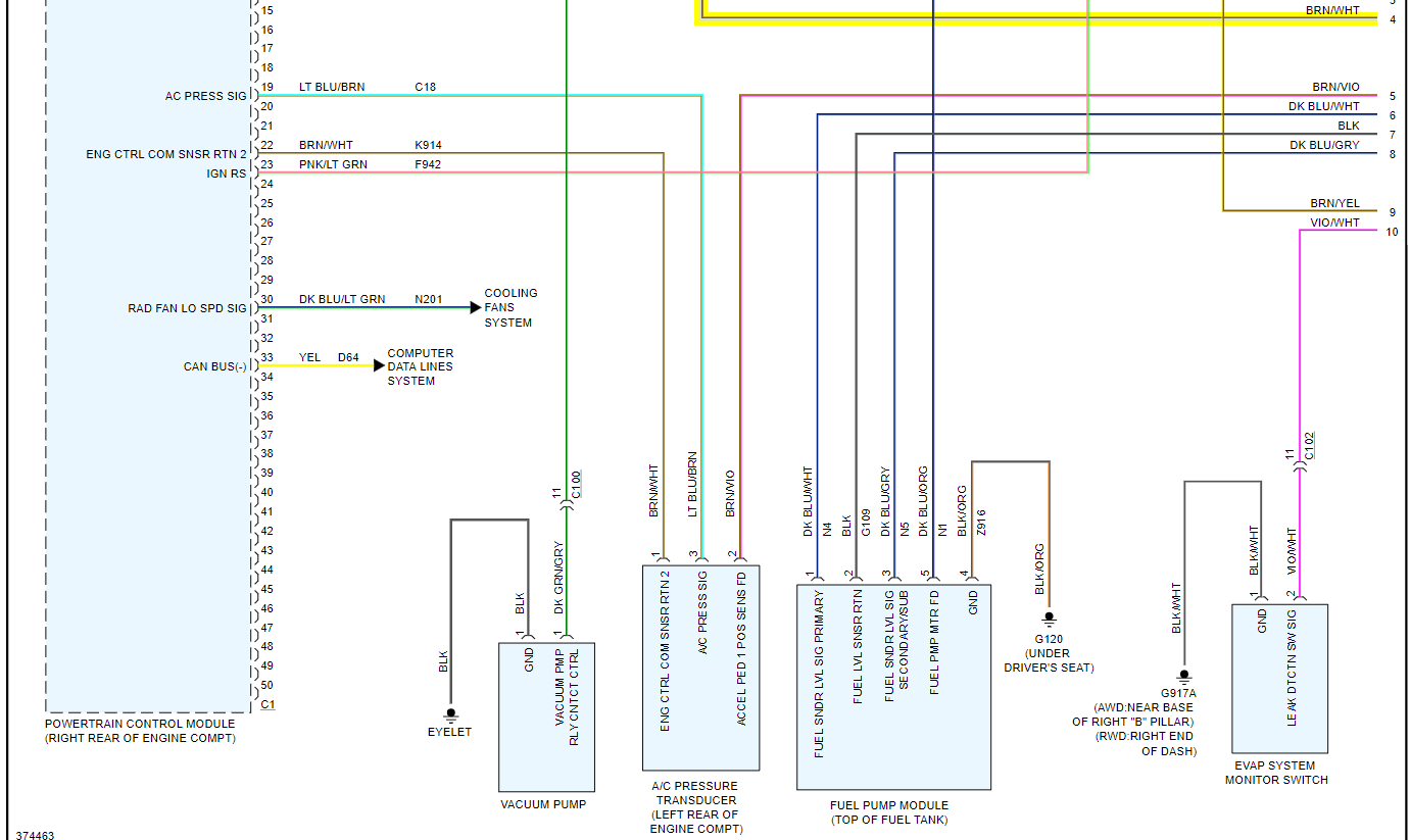

Dash says vehicle not in park. I don't know what is going on, but i need to turn the engine off. Its been running for two hours now.
Mar 26, 2019 at 9:46 AM
Experienced Mechanic
52,796 POSTS
Good morning,

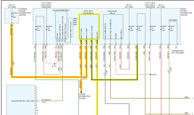

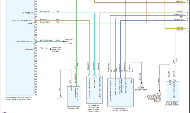

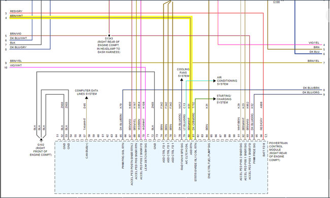

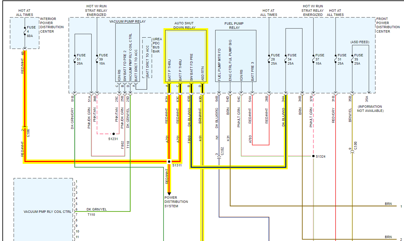

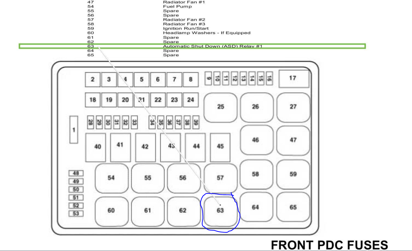

The most common issue for this is the auto shutdown relay. When it does not open after turning off the key, the engine will not turn off.
I attached the wiring diagram and the location of the relay for you.
Images (Click to enlarge)
