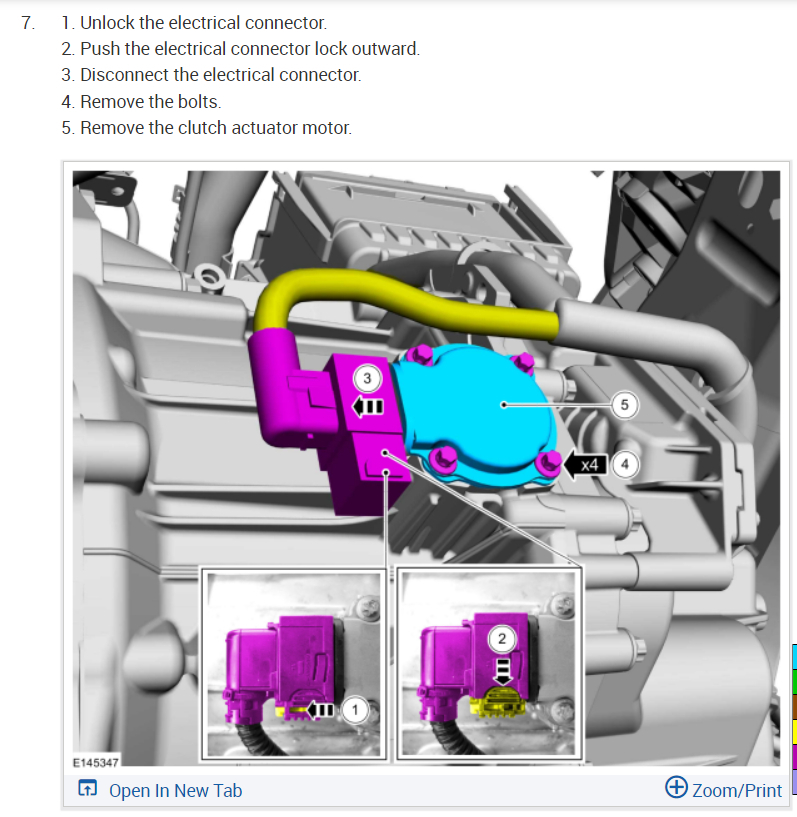

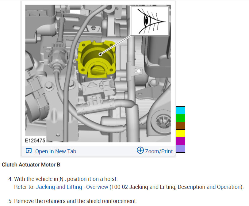

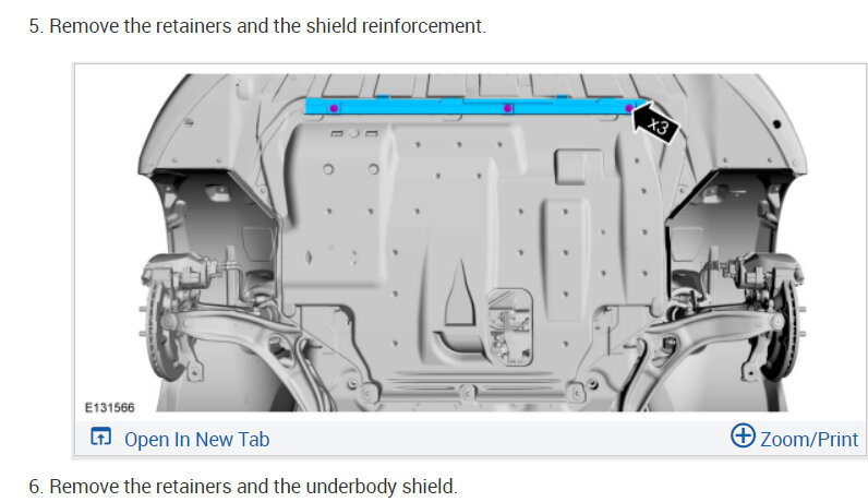

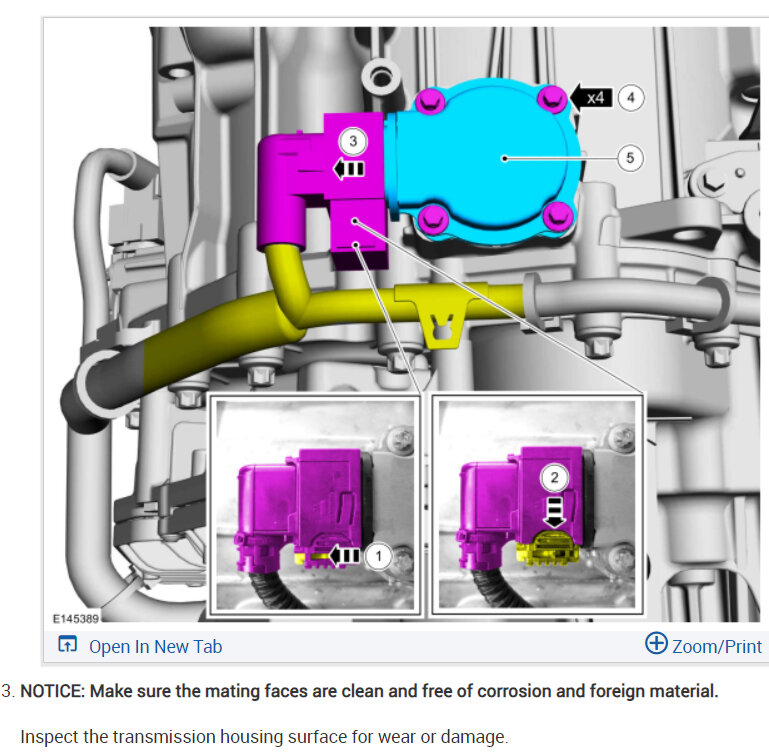

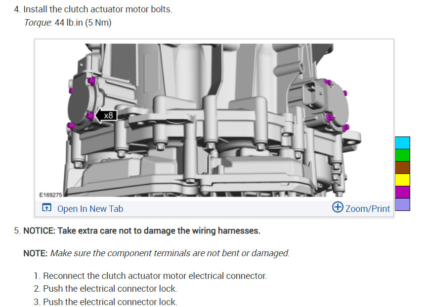

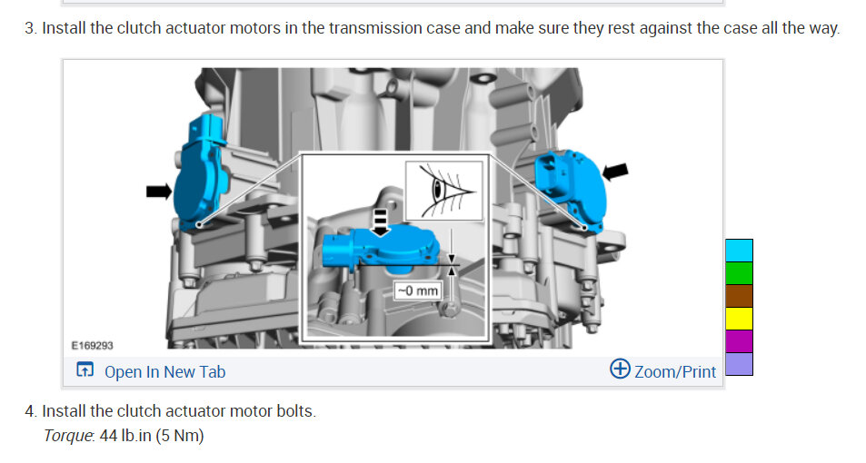

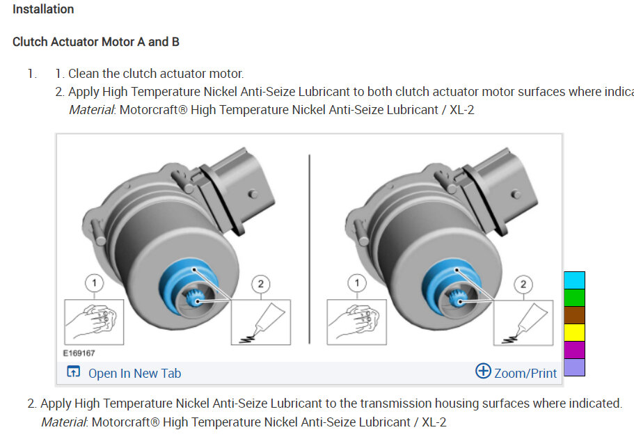

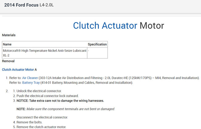

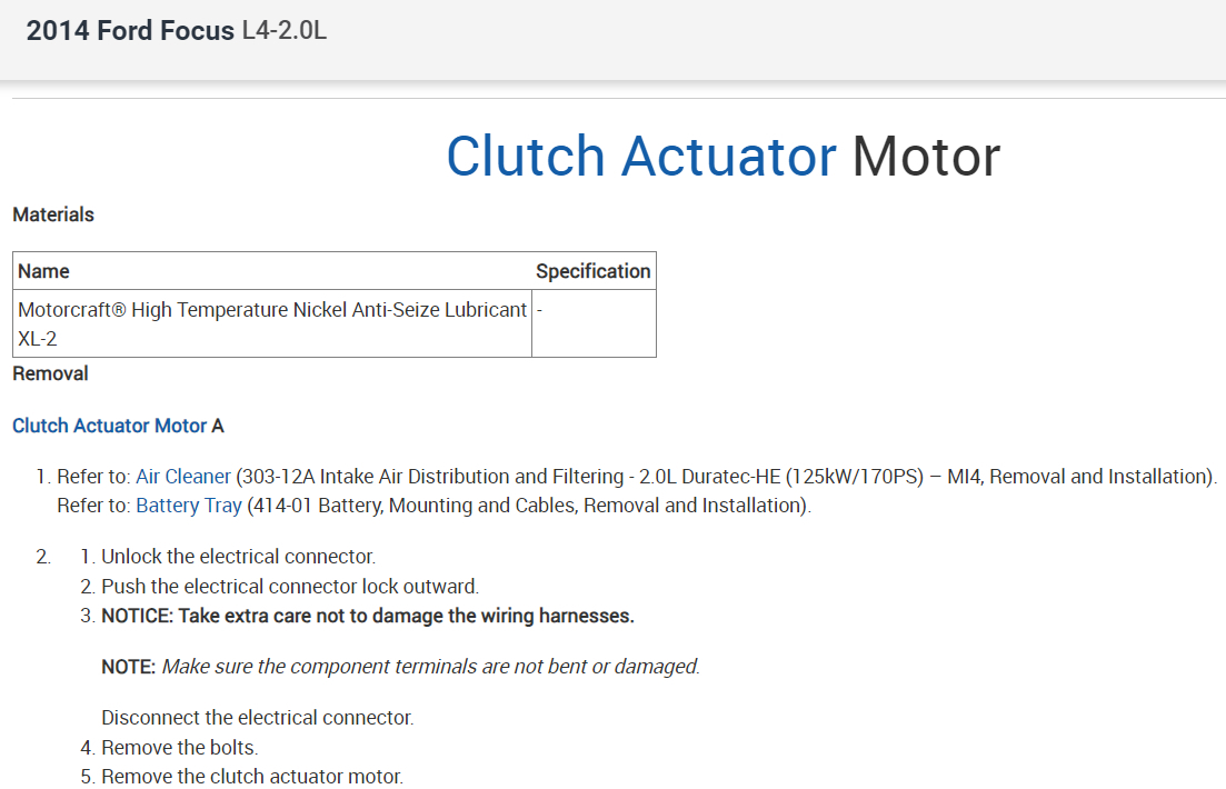

For example, when I stop at a stop sign and go to take off it won't go. I have to shift it into neutral and then back into drive and then it will go. It's like it gets stuck in between gears.
Oct 21, 2024 at 12:58 AM
  • 55,423 POSTS

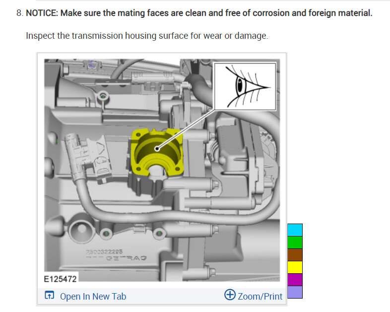

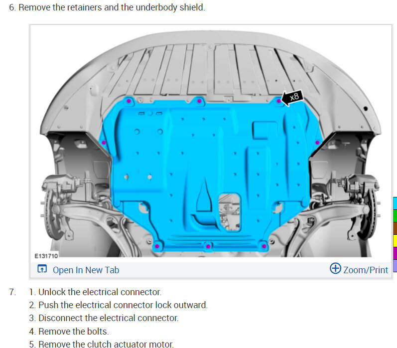

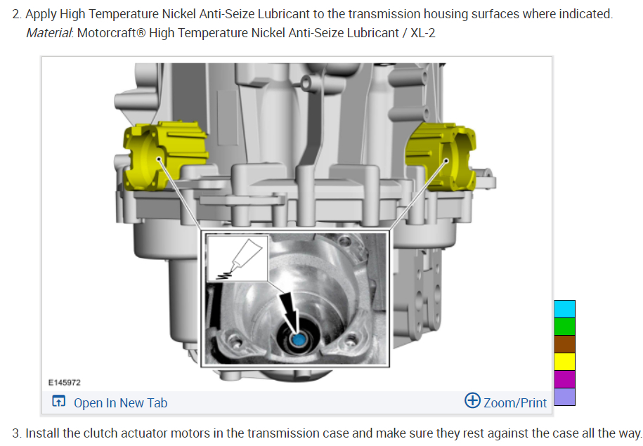

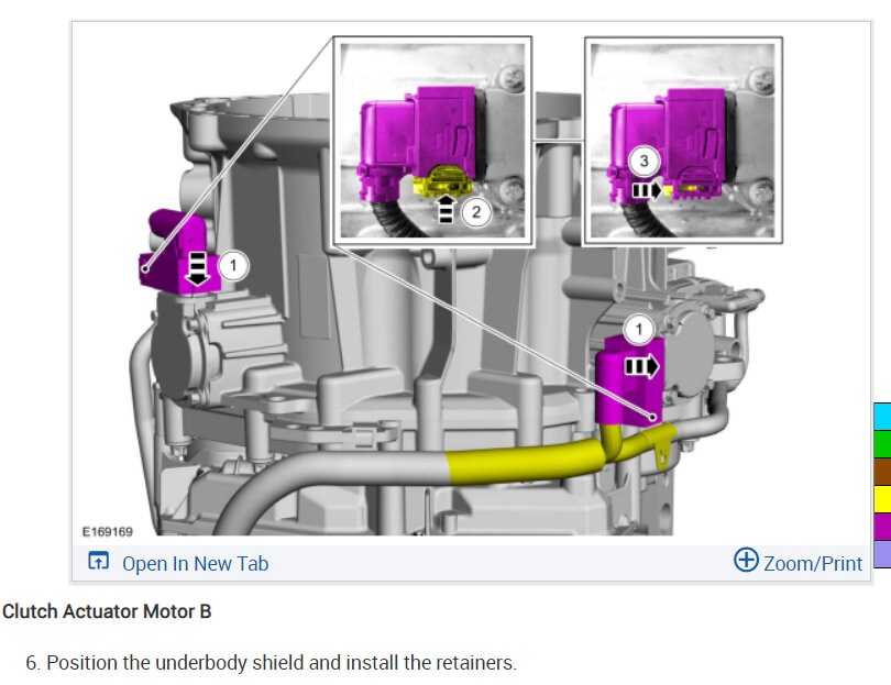

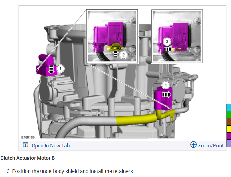

Yep, that is because it is. what happens is the clutch actuators get stuck because they are worn out and need to be replaced. Here is how I would replace both of them, which is common. Check out the images (below). Please let us know what happens.
