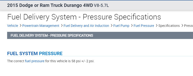

Did it stall after replacing the oil cap? If you leave it off, will it continue to run? If so, then we need to check the fuel pressure. If this is what is happening, I suspect we have a rich fuel mixture.
Here is a link that explains how to check fuel pressure. You will need a fuel pressure gauge, but most parts stores will lend one to you.
I attached the manufacturer's pressure specifications below.
Let me know. Also, let me know if the check engine light is staying on while the engine is running. If it is, let me know if you scanned the computer to see if there are diagnostic trouble codes. If you have, let me know what they are.
