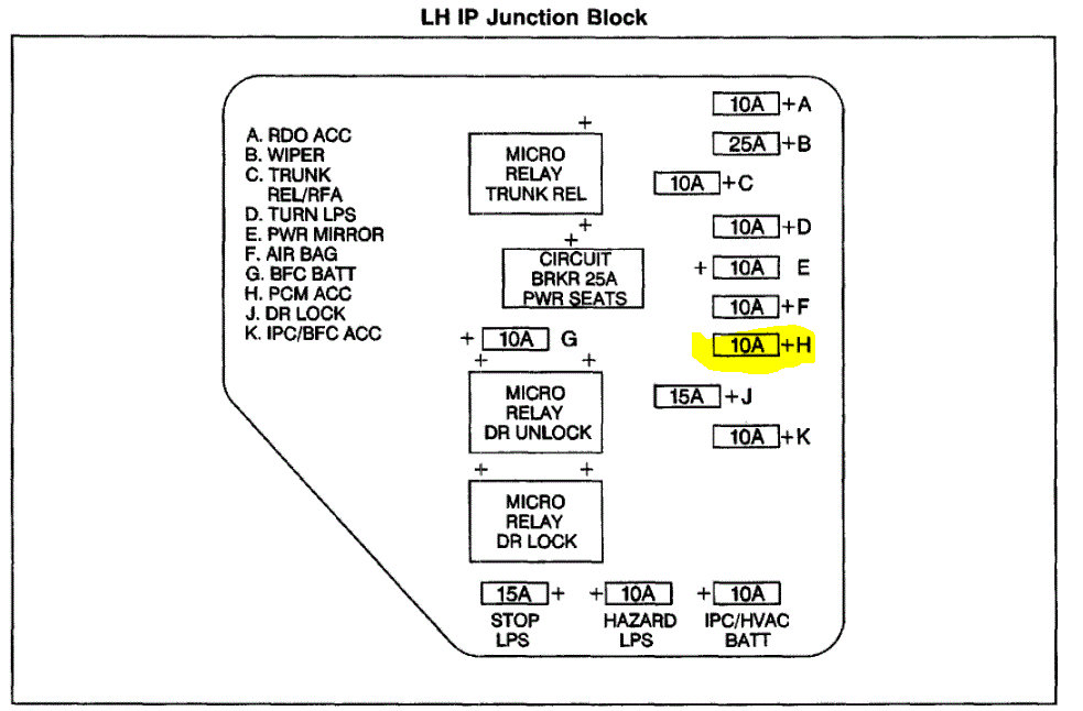

I replaced the HVAC btt fuse and now my dash board lights won’t come on and car stays on for a couple seconds then shuts off?
Nov 13, 2020 at 10:01 AM
  • 110,240 POSTS

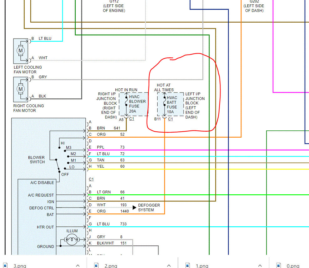

The problem started when the fuse was replaced? Do you mean the HVAC battery fuse? See attached pic.
If that is the one you replaced, check to make sure you didn't bump the fuse for the PCM. See pic 2. Also, I need to know if the fuse you replaced has blown again. if oaky it sounds like the battery is weak or the starter has gone out but to be sure lets check out these guides, they can help us fix it

Check out the diagrams (Below). Let us know what happens and please upload pictures or videos of the problem.

Yes, the Ipc HVAC batt fuse and it haven’t blown again. Where do I locate the PCM fuse?

The PCM fuse I referenced is in the same panel as the HVAC fuse. See pic 2 above.
