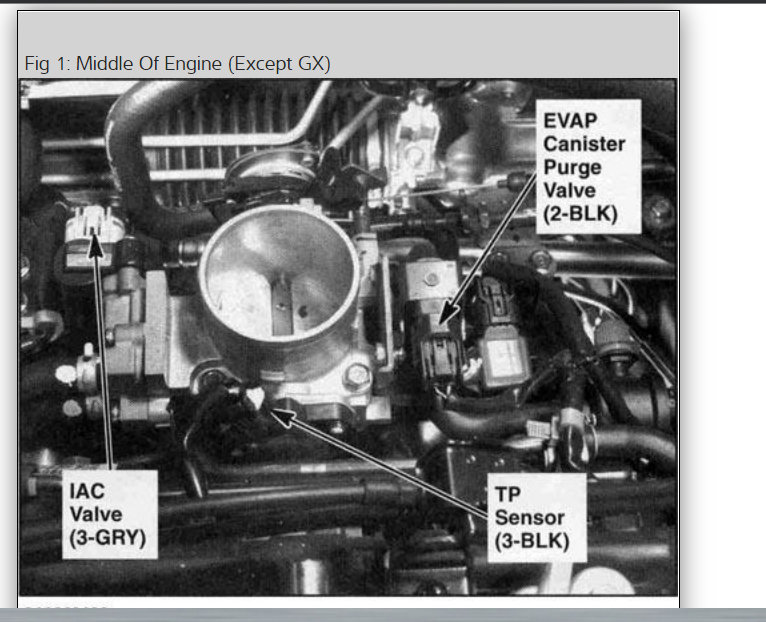

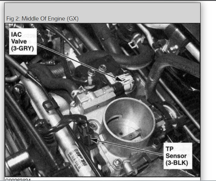

This could be a problem with your vehicle's Idle Air Control (IAC) valve. I'm going to tell you something that is totally counterintuitive. When you step on. the gas pedal, you are not really adding gas to the engine. What you are really doing, is opening up the throttle, which allows more air into the engine. As hard as this is to believe, engines are really nothing more than air pumps with a sprinkle of gas added for combustion. In fact an engine running at stoichmetric operation, which is perfect combustion, has an air to fuel ration of 14.7 parts air to 1 part fuel. So, your vehicle's problem could be it's not getting the proper amount of air, and when you step on the gas you are opening the throttle letting air around the throttle plate, which the IAC valve should be doing. I have included a couple of links below for you to go to.
https://www.2carpros.com/articles/engine-cranks-excessively-before-starting
https://www.2carpros.com/articles/how-to-replace-an-idle-speed-control-motor-iac
I have included for you the locations of the IAC valve on your vehicle. Please go through these guides and get back to us with what you are able to find out.
